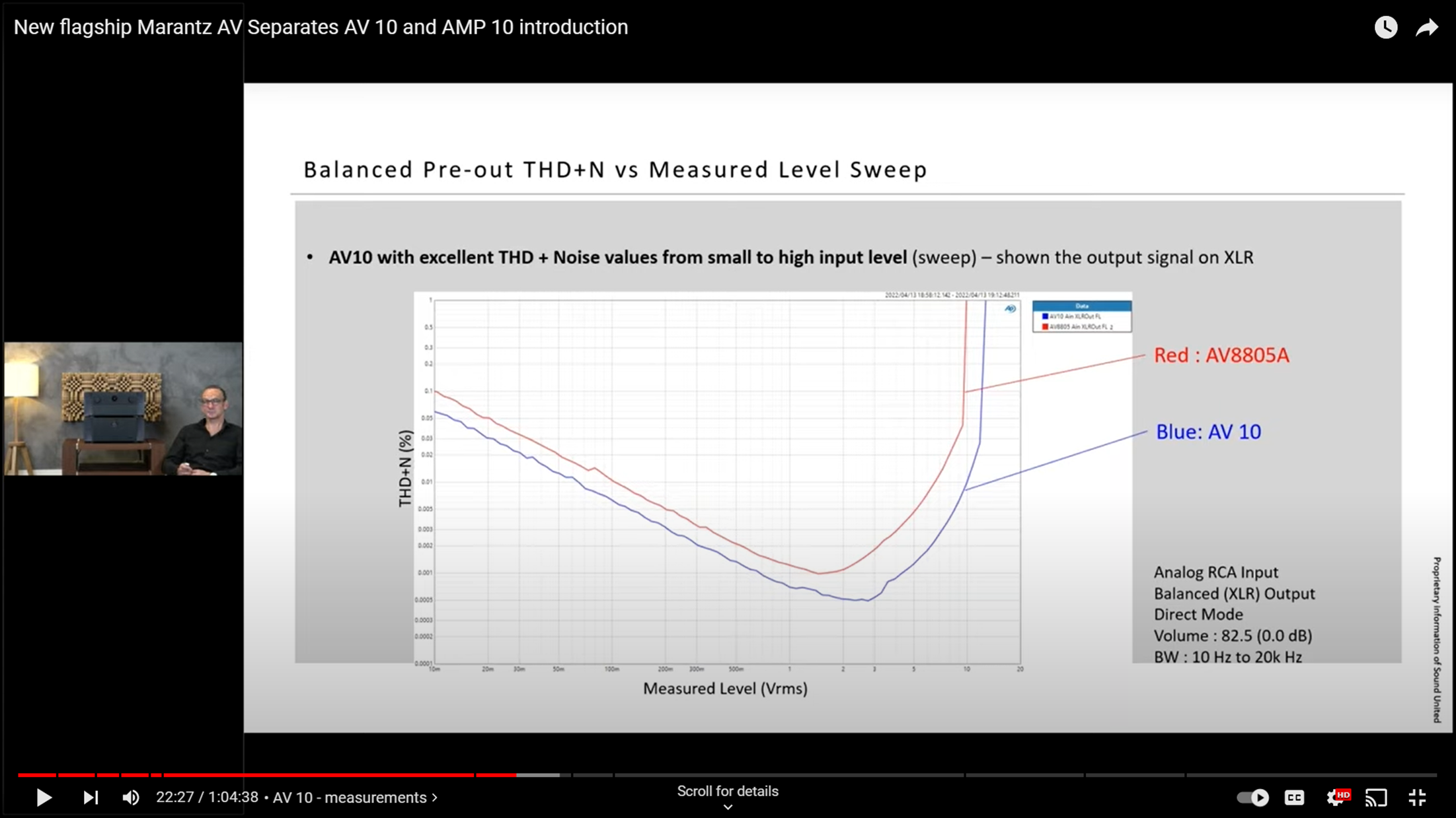

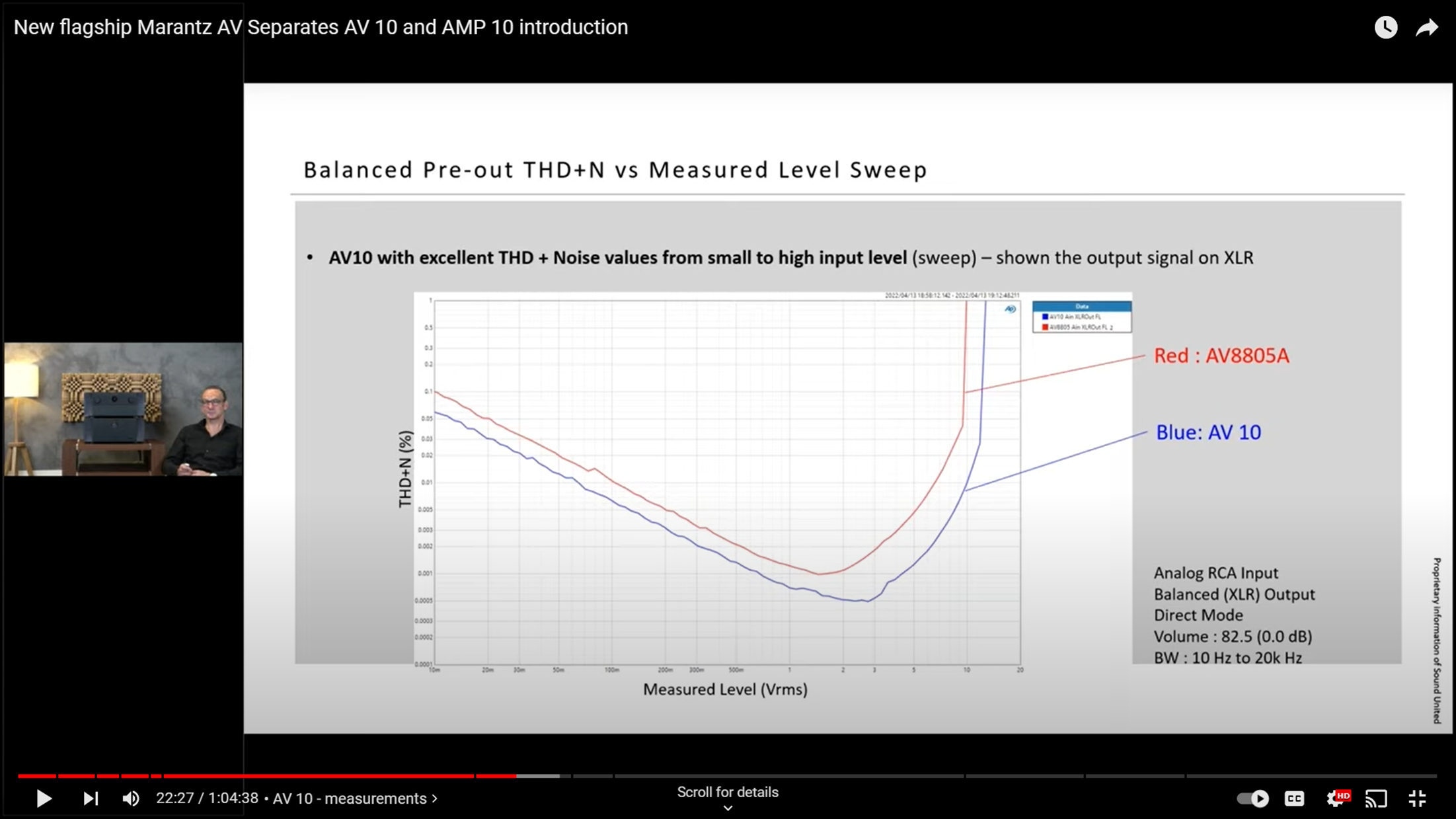

From the Masimo video:
At about 22:10, it shows about 106 dB at about 2.8 V from the XLR outputs, presumably. On your graph, you seemed to be getting the best point at about 4.8 V. Not quite the same, but then we have different operator, different AP models (assumed) and probably slightly different methods too.
It is always tricky to compare different results from different test bench/operator/instrument/methodologies. Overall, I think things are still in the ball park.
Damn I never saw this video and Masimo said my test results were accurate. I will rerun with a BW limited source instead of 192khz to see if it improves the measurements.
