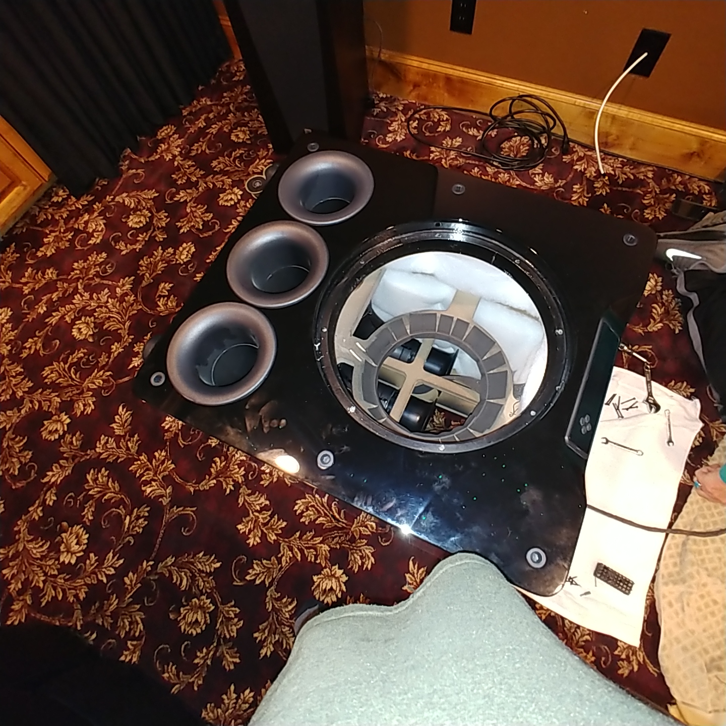

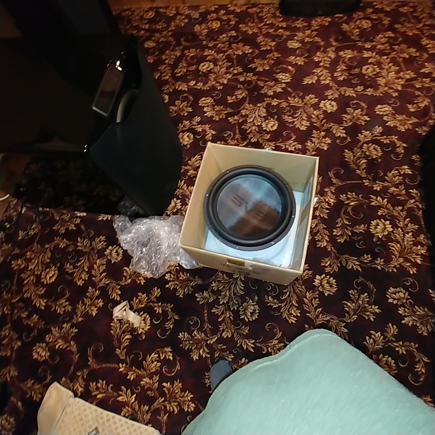

Got to repair my PB 4000 yesterday!
Danzilla31
One of my SVS PB 4000's developed a driver issue last week
SVS sent me a driver within 3 days thought I'd post this here if anybody has to go through the same thing
The instructions are super simple and they send you all the tools you need
You basically take out the amp first then put it's on its back take out the driver
When you take out the amp you just unplug it from 2 spots
The driver you take it out you unplug the terminals after you pull the driver out
Then you reverse the order driver first then amp pretty easy peasy took me and my pops less then an hour

You are lucky you didn't go with the PB16-Ultra. The driver in that thing is such a monster that you need specialized tools to remove it. It is much heavier than the 4000 series driver, and now you know what a beefy chunk of iron the 4000 driver is.

What was the issue with the driver?
Not sure the sub was distorting badly when I called them they had me run some tests one of them was pushing on both drivers the driver that was bad on the one sub made sound when you pushed it in
They said right then that they aren't supposed to do that and it was a driver
So they sent it out we put it in and it's sounding like it's normal beautiful self
I think that sub is a lemon it's the same one I had to replace the amp on like a year after I bought it the other sub works fine this whole time no problems those things happen
But know it's got a new driver new amp so hopefully she's good to go basically it's a new sub in the old enclosure
Man Shady we had to use tools to lift that one out as well so I can't imagine the ultra
Wonder if the amp going out might have initiated the damage....

Yeah, it must have torched the voice coil. Awesome of them to stand behind their products like that. I did just see in an email blitz they are offering amp upgrades for the 13 Ultras to a 4000 style amp...
