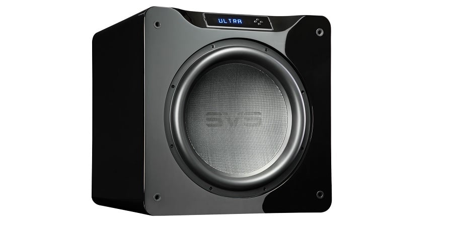

Hi guys.
This is an interesting question. It turns out I could fit 2 of either of these subs in my room.
  1. Both come in Piano Black finish, and
  2. Both would roughly fit in the same space
  3. Both are the same price for 2.
The obvious trade-off is this:
SB 16 grants you a more powerful amp, bigger driver, and bigger woofer... but no porting.
I ASSUMED that the sealed sub would easily dominate, right?
Because: The SB-16 is from the top-tier line at SVS, and it's also sealed... so it has 2 attributes, which according to legend, would supposedly make it sound cleaner than a lower level of ported sub.
My question is this: For you guys that have heard these same subs in a room, how would they compare in the real world? With regards to purest sound quality and lowest distortion, which of these subs would win?
The measurements from Audioholics below show the opposite:
The PB-4000 actually has lower distortion in the low frequencies.
  • At 40hz, it hs 6.8% distortion.... vs 40hz on the SB 16 has over 12% distortion.
  • at 31.5hz, it has 7% distortion... .... vs 40hz on the SB 16 has over 13% distortion.
  • At 25 and below.. .same story.
The only time the SB 16 seems to come out ahead is 50hz and above.
From these charts, it seems the PB-4000 is both the clear winner in both output AND distortion at the typical level a sub would be used.
How is this possible? Are these measurements reliable?
These charts were both made by James Larson at Audioholics in 2018 and 2017. I am assuming he is Shady J? or at least a representative of the forum.

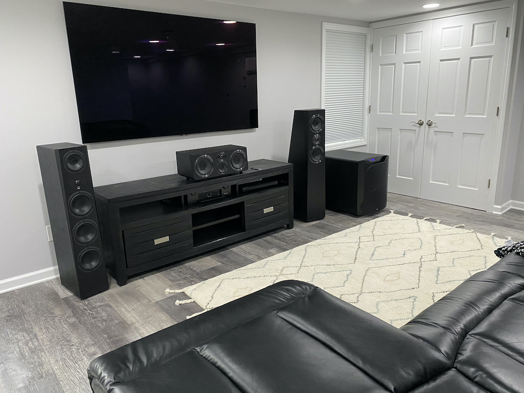

Sorry to revive an old thread but would the PB16 Ultra offer lots more than the PB4000 or is it marginal in a room such as mine here - see image - I have everything else in the room as Ultra setup so would be nice I guess to match everything BUT if its only a minor upgrade than I will save my poor back!!

I don’t really understand your fixation on everything being Ultra. All of SVS’ gear is pretty consistently good, and designed to match up even between the Prime and a ultra lines.
Please don’t misunderstand, it is your system after all, and you should do what you want. My opinion is you are just focusing on labels and expecting that matching labels will improve your sound.
Those PB 4000s are high quality machines. The only major difference is the size of the driver and therefore potential output SPL at lower frequencies and with lower distortion levels.
You should look at the reviews and look for the CEA-2010 Burst Tests to see the differences in what they can deliver.
If I recall, your room isn’t crazy large, and a gargantuan sub, or two, won’t make a huge difference.
More than anything, freeing yourself to properly set up your room will have a much bigger impact on sound quality than just supersizing your Subs. If even one of your Subs or speakers is in a poor spot, or your LP, not even the most expensive speakers in the world, or a 21” Devastator Sub, can compensate for improper positioning.
Again, it is your system, your ducats. You do what you want, but based on everything you’ve posted thus far, taking time to maximize what you have will likely yield significant improvement over just matching a brand’s label.

If I recall correctly, the PB16 would mostly offer more deep bass from 16Hz to 40Hz. If you are interested in more headroom in that range, you would get it from the PB16. Maybe a perceptual doubling of deep bass headroom? But not so much anywhere else.

The Captivator 2400 would have deeper extension and more mid-bass headroom. The PB-4000 and PB16 already dig so deep that I think the lower extension wouldn't make that big of a difference but the headroom above 40Hz would make a difference if you like to listen at loud levels.
