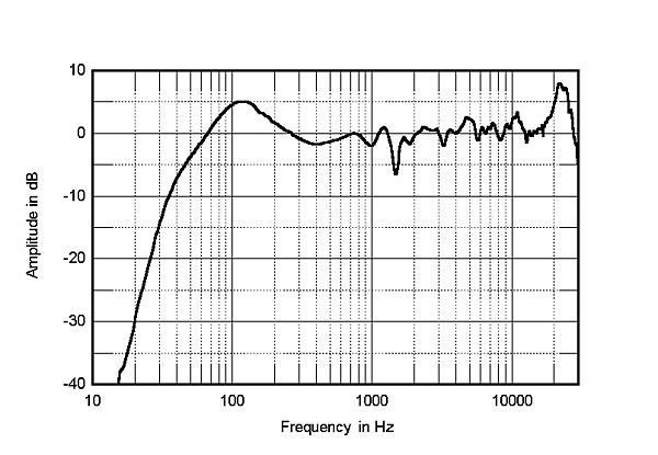

Here is a review of your speakers with measurements.
Here is your bass problem.
That is a nasty place to have a hump, in that 100 to 120 Hz range. Those are nasty. I can tell you from experience they really exacerbate room problems.
As I have said before, marketers are largely responsible. If you tune like that, and give that hump, you can claim an f3 around 50 Hz. A design decision to deceive the unwary. If you have followed my posts, you know I generally avoid those extended bass alignments and and that is one reason why. But I don't have to engage in spec. sheet wars.
I'm not high on room treatments. The problem is there is synergy for a bad outcome with problem rooms, and speakers with an off axis response that does not mirror the on axis response well. Really good speakers I find are really room agnostic to a significant degree.
Thank you! That's a really detailed review. I should have been able to find that one. If it's better to reduce the humps than it is to try and raise the dips, then some of that might be manageable. Interesting how the grill affects the measurements.
The way John Atkinson measures speakers always gives the bass a boost in that range. He notes as such in his review, but he does say that there may still be a rise in that region, although not as much as his graph depicts. It's hard to say how severe it would be. I would not want a 5dB peak in mid-bass as is shown in that graph, but I could live with a 2dB peak there.
