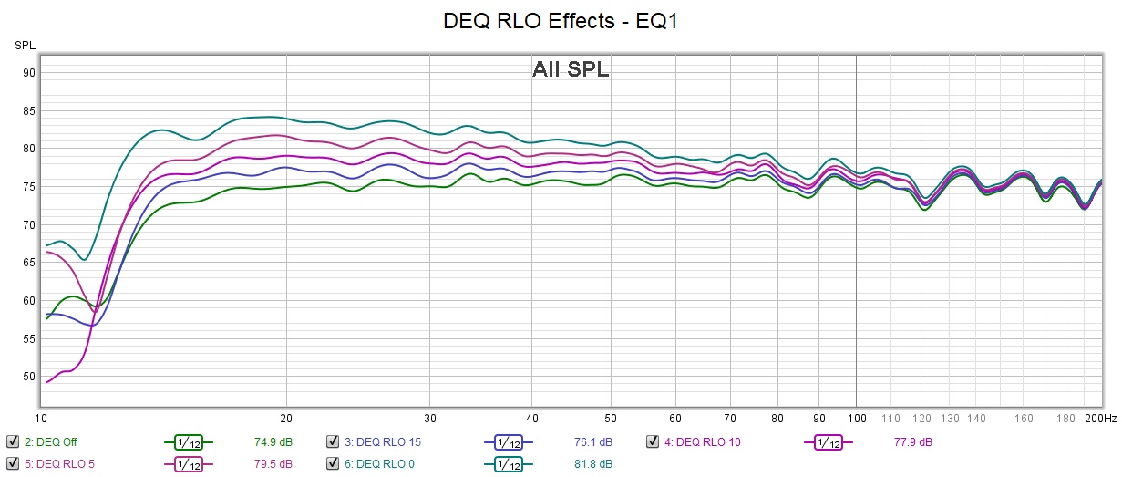

Good to hear! Proper setup is key for sure. You can try experimenting with the Dynamic EQ setting too. Here's a chart with some sweeps illustrating the effect of the different RLO settings for Audyssey.
DEQ off is pretty much flat. If you turn that off it should be the most accurate response, with the rest adding varying degrees of boost. I personally prefer RLO 10 for my system.
Yep. With time, a mic/PC, and the audyssey app+ratbudyssey you can have a nice pretty curve like that...maybe. You have a lot of control over your subs if your receiver can use the audyssey app. You can get pretty granular with tweaking and take up a lot of time, but also get excellent results.
