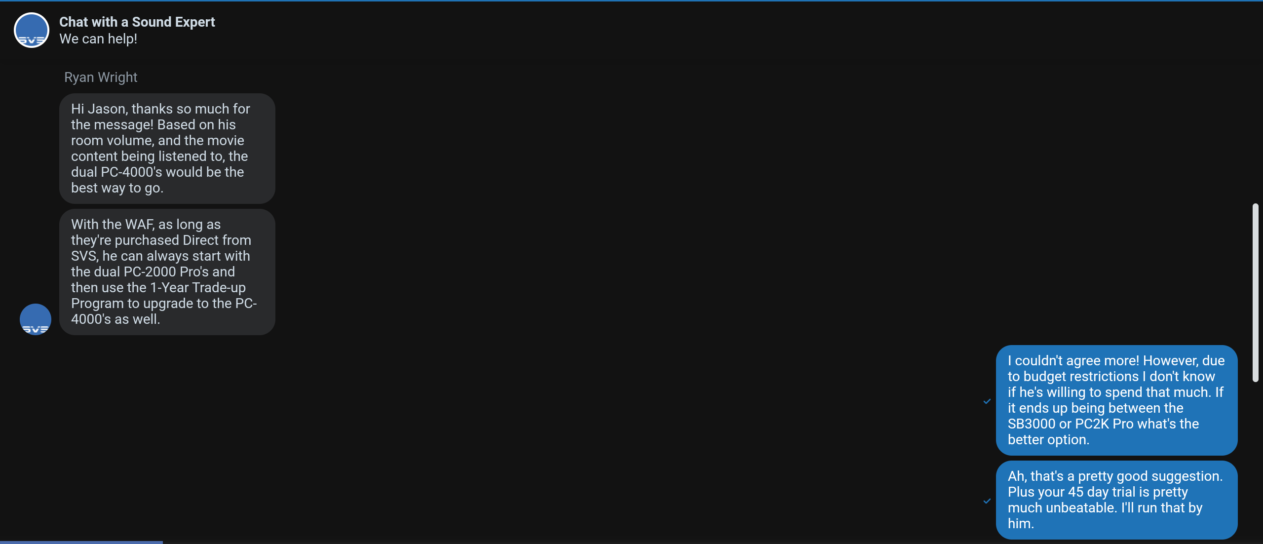

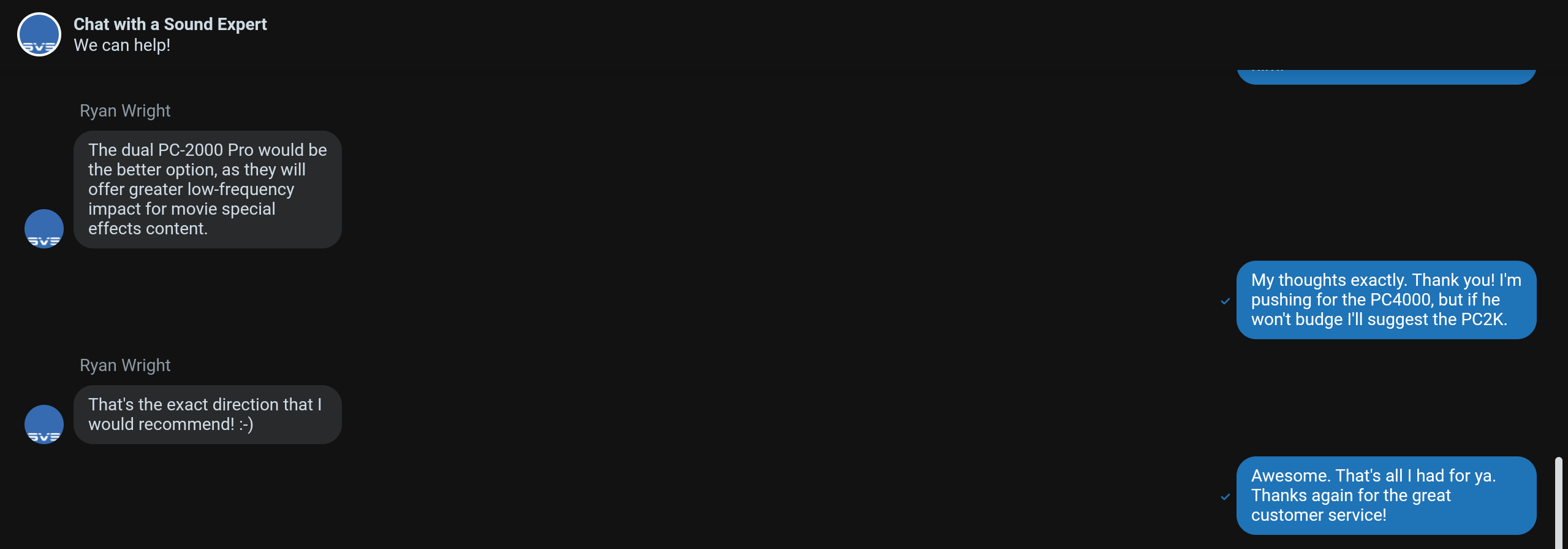

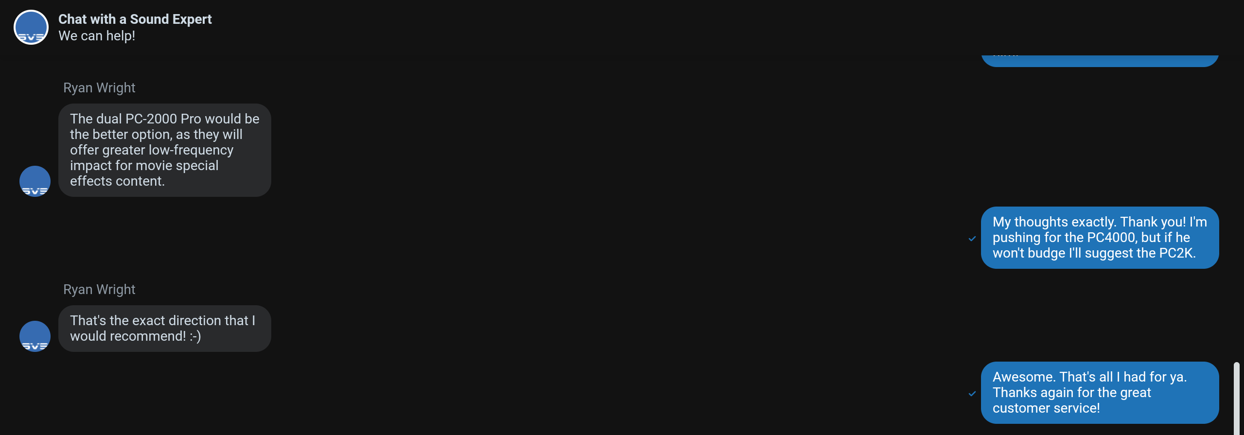

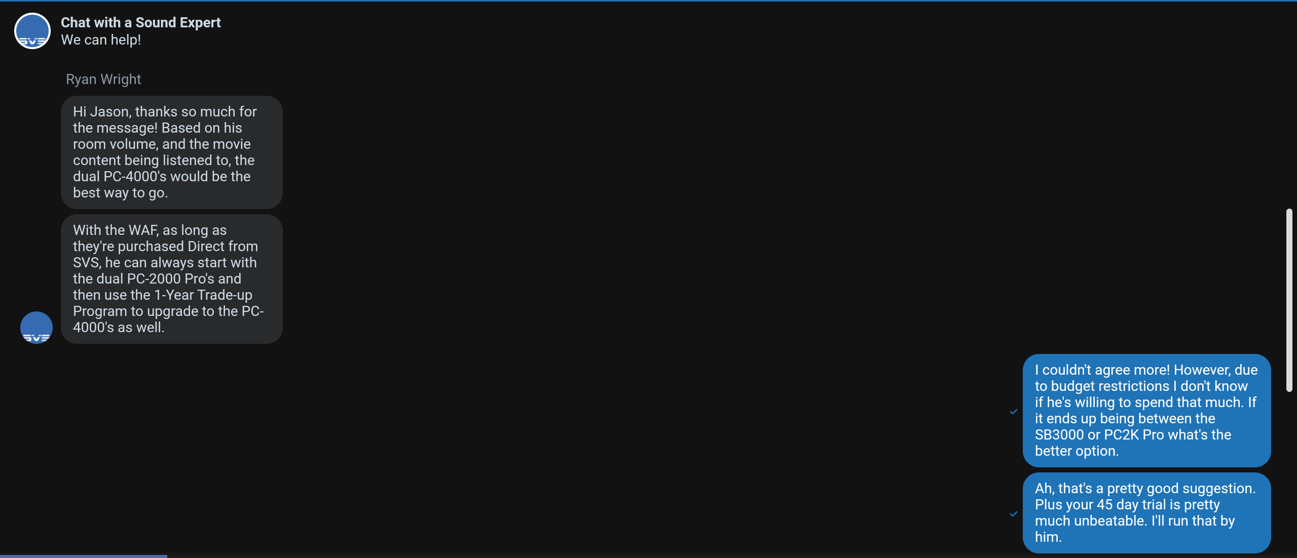

Okay, I fired up a chat with Ryan over at SVS!
Straight from the horse's mouth! I think starting out with a pair of PC2K Pros with an option to take advantage of the upgrade program was a great suggestion.
