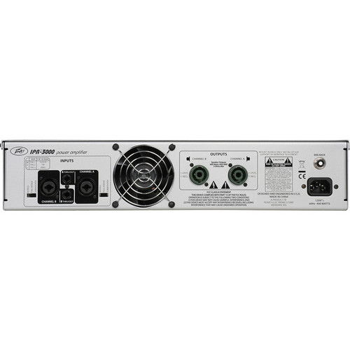

+1, or the new Peavey IPR Class D amps are looking pretty good under stress tests... Plus they have a RCA input, which saves the hassle of adding external devices...
  • Like
Reactions: jostenmeat
Oh, cool, thanks for the heads up and idea. Hm, this is a pic of the IPR 3000 I think, and are you still certain they have RCA input?

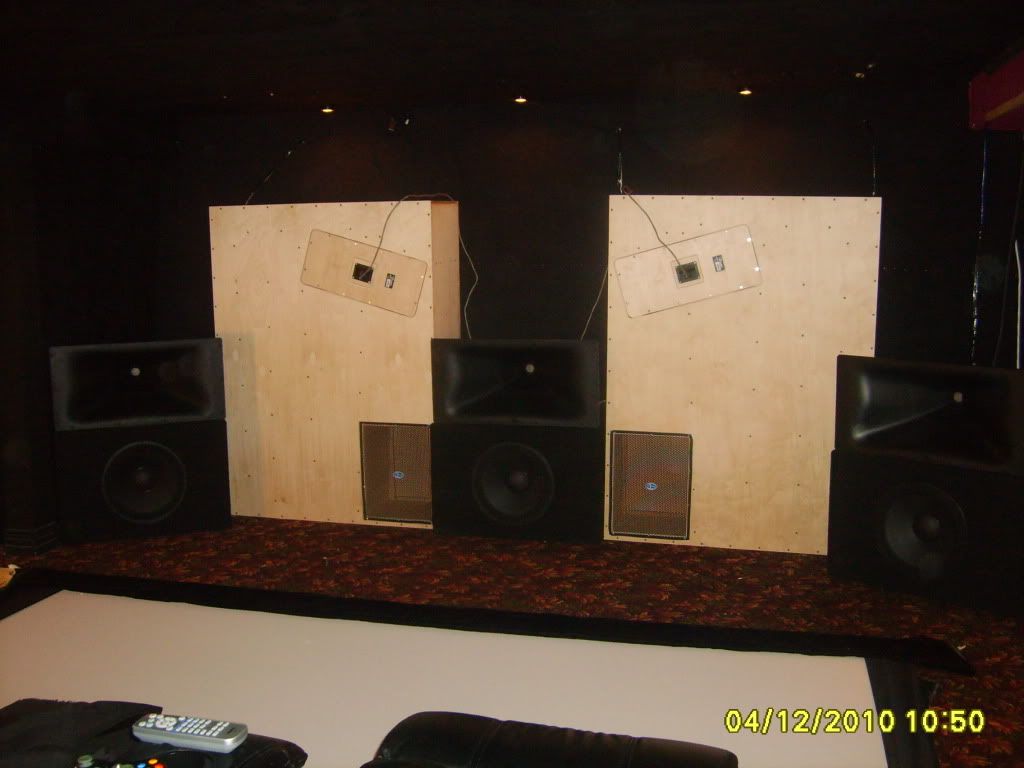

Regarding the aforementioned ringing, I'm not sure of going to lengths like the below (1" acoustical cotton) was in fact aimed at possible ringing(?).
attachment.php
Then with the pic below, I can see why some might choose to run the wire through the horn (if I understood correctly), but I'm not sure if there needs to be mods to do so. I also am curious if the asymmetrical/symmetrical builds of the pair are easily allowable, and how that works out really (probably stupidly simple, but I'm not sure).

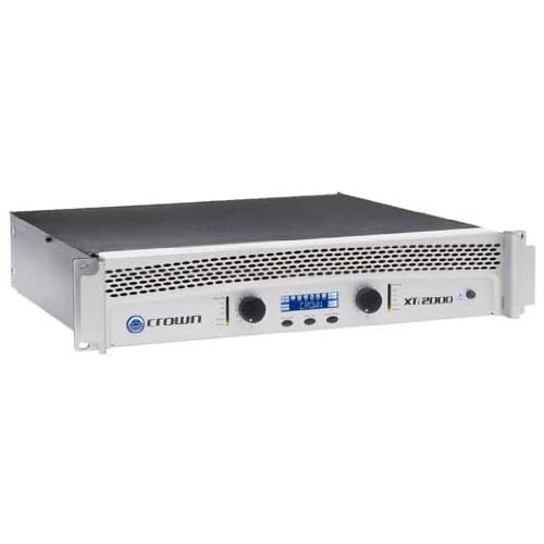

If the IEC is 1kW @ 4-ohms, I generally use the rule of thumb of about doubling that to select amplifier power.
Crest, Crown and QSC are my personal favorites, but all the amps from decent companies are good now, there really isn't a lot of junk out there. Some are better at certain things than others. Right now, I'd say the winner for a home is the Crown XTi for bedside manner, DSP, requiring no fan mod (they are nearly silent out of the box), and having awesome support (Crown has fixed and replaced amps for me they probably shouldn't have, and always answers the phone). Also, for this sub, I'm pretty sure there is a channel polarity selection in the DSP....but I gotta check. Crest is the powerhouse, my mobile rack is now all CD amps, which are efficient and absolutely POUND, my home rack has one CD for the subs and the mains run off a CC... but they require a fan mod and are more of a boutique builder...when you need parts or service you have to talk to some guy in "Parts" who calls you back.
Crown XTi2000 is my vote. But my real answer is that, as long as you buy from a good brand, it doesn't matter. :)

I'm seeing that there are a TON of commercial amps out there. The Crest 200 series look very nice, but even the 7200 is mucho moula. Crown, I'm just lost. Haven't even looked at QSC yet. OH, I see that MS has replied, ok, gonna check those out for sure.
I've already been shirking other responsibilities/chores a bit because I've got Danley on the brain! hahaha
Midnight, I'm pretty sure the consensus is that 1KW is just fine. That Crown does look nice! Is there a more modest version of that for perhaps a bit lower in price?

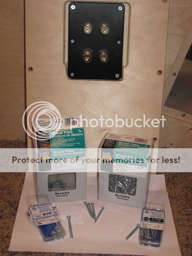

I think I need to do my own binding posts. I guess I'll try speakons. I'll connect Mono 12 AWG to +1 and -1, and leave 2 /+/- alone. I thought I read of something a person did to help make the seal airtight with the binding posts/panel, but I don't remember it.
The binding post:
Pinout diagrams (I suppose I don't need to care which of the two I use? Oh wait, they must be male/female . . . ?):
