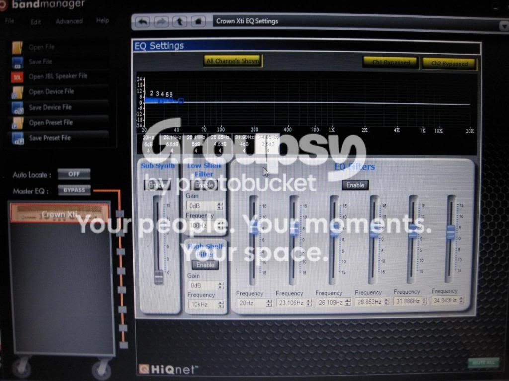

mini-update: I successfully loaded my first preset, where I used a +4db shelf centered at 30hz, and then boosted some more with EQ at 20/22/24/26/28/30. I started with +3db at 20, and successively lower by .5 for the remaining. I put my receiver back at -13.5 or whatever it was. The shelf flattens at about 67hz. My brief testing was interesting, albeit with great trepidation because of how late it was. I am going to boost back the receiver gain some more, maybe 1.5-2 db, and try again, where I might have to lower the Crown's EQ boosts (or leave them be). By adding the shelf, but reducing by 4.5 overall in the receiver, I think I am now relatively lacking from about 45-75 hz, but OTOH I didn't get to stretch the system's legs.
I wonder if I can rename my presets, instead of "preset X" or whatever. It's very easy! Wayne from my y splitter thread really helped me a lot with the y input setup. That saved me from a lot of potential pain. The manual doesn't really explain what it does, for me anyways, and I'm too scared to hurt anything to experiment without understanding what's going on.
Oh yeah, I forgot, Midnight, you know what the heck the sub synth does for me? Of course, I had to remove the black tape from display, and reapply tint. After cycling power, I was happy to see that the Crown does default back to my last chosen preset (otherwise, ugh!). You were absolutely right about the speakons: after I use them, that's all I would want to use. Safer, impossible to have strands or even bananas shorting each other, easier. I think they should be standard on consumer amplifiers! :D I have never yet triggered the Crown fan AFAIK. BTW, I know they are stackable, and the vents/fans are plenty, but if I installed rubber/vinyl feet on the bottom, that can't possibly make it worse . . . could it. . . only help, right? Just curious.
rmk, I was wondering if you could possibly expound on your thoughts with Audyssey Dyn vol/eq? I can see myself trying to find a second preset for slightly lower volume than what I typically use the system at. So I started wondering if my attempt at that would basically be a caveman approximation for what that Audyssey tech can do already. Thanks.
Here is a really awful screenshot of my first mouse clicking, where 3hz never comes out to 3hz (this is not my preset, and I did add a shelf). But, the 2hz intervals do, strange . . . The page below does not show what I can do with input setups, xover setups, etc. Very cool, totally free software.

Question: If I EQ the one channel, with Y-input setup, I can safely assume that the EQ will be applied to BOTH channels, correct? I am just being paranoid. I also realize how poorly I've understood what's going on with connections, as even with recent configuration, I didn't have to worry about "channel 2" (assuming that the link out will share its own EQ settings . . . )
Thanks, I'm sure it's fine, but it is important to me know for absolutely sure.
Yes (and fyi, if you bridge that amp, everything is controlled with channel 1)

I think perhaps my concern of whether the Y-input passes EQ might have to do something with the buttons that say "channel 1 bypassed" and "channel 2 bypassed". You can see them in the screenshot. I have them all unclicked (where it then says "bypass channel X", and it goes grey, no longer yellow). Well, maybe that does something with the whole EQ passing or not.

Midnight, I've received emails from two Crown tech reps, and you're correct indeed. Y input with MasterEQ affects both channels. If I want to EQ only one channel, it must be done with the amp's menu itself. The MasterEQ must be plugged into ch 1 for the signal to pass, if I understood correctly.

Here's your answer below. The pain really is not that bad. You have to understand, my greater paranoid stemmed from having two woofers in the same cabinet, firing out of phase. If I used two separate subs altogether, there would be no fear on my part of hurting the drivers somehow, and it would be much easier to tell if one was not being affected by EQ. My setup is rather particular, particularly for a first-timer.
Not necessarily. Since we are “hijacking” professional products for a residential application, we should not expect that they have been designed in a way that makes sense to us.
There’s no good reason for a pro amp to have the two channels automatically EQd the same in parallel mode. This is because a pro-audio amp is not typically used the same way that we’d use them in the home environment. For a PA system, it’s not uncommon for the two channels to be used for different applications. For one example, even with a single input from say, a mixing console, one output of the amp might go to a high frequency driver and the other to a midrange driver. Naturally, they would not be equalized the same.
