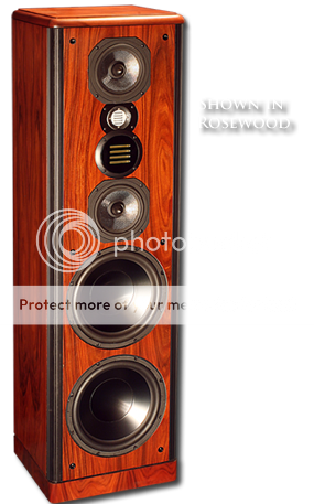

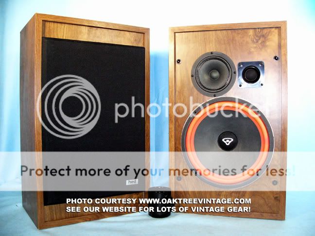

Some things can be inferred just by looking at a product with out having ever heard one. For example, look at these two speakers and tell me which one you think would sound better...It's a no brainer for me.

UUUUUmmmmmmm the 1st one? I just don't know hhhuuuummmmmm ok I like the orange woofers best........:D The other Pair are just way to cool to sound better than the orange woofers.......LOL

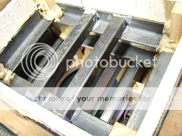

I think you mis-understand my meaning of modifying cabinets. :) Dynamat is actually a critical part of it; but not by way of a single side application. I typically add a lossy visco-elastic layer like Dynamat, then adhere a second sub-structure cabinet directly to the Dynamat. Doing this creates a constrained layer system. This uses the two stiff layers to focus a shearing action into the damping core, effecting maximum conversion of mechanical to thermal energy. Simply applying Dynamat to the walls has some effect, but no where near enough to effect large differences that are desired. And you can add more, but a threshold point is quickly encountered where even if you add 5x as much, the effect will be minimal on it's own. You really have to effect another mechanism, such as the constrained layer system I described.
Here is the measured wall vibration of an Ascend CBM-170 vs. one I modifed: http://www.linaeum.com/productinfo/other/ascend_cbm170se_wmaxmod/wallvibration_oem_vs_mod.gif
The modified version added 1/4" visco-elastic damping(similar to Dynamat) plus 1/2" re-enforced concrete 2nd inner cabinet layer, then extensive steel bracing. This is MY idea of a modified cabinet. Here is a picture of inside the modified cabinet before I installed the new back wall: http://www.linaeum.com/productinfo/other/ascend_cbm170se_wmaxmod/9.jpg
You can also do a similar modification without cutting the cabinet open. You would have to install the visco-elastic layer through the cabinet openings, then use a 2 part idustrial floor epoxy ($40 1 gallon kit available at Lowe's) to make the required sub-structure. You should adhere some metal screen to the back of the Dynamat before pouring the expoxy to ensure an ideal adhesion to the Dynamat. Build up to about 3/8" minimum wall thickness. Place some additional oak braces inside before pouring the epoxy. For small 2 ways, 1 Gallon kit should be enough. For the Triple 8s, at least 3 Gallons would be needed.

That was not a custom build, I'm afraid. That is the interior shot of an Ascend Acoustics CBM-170 in the process of modification to remove all cabinet resonance(s). I think it hardly matters if I did not clean up some excess adhesive run-over. This cabinet is vastly superior to most; it will not produce any audible cabinet talk. It's also very tough to cut concrete slabs very neatly to fit inside the unit properly. The external cosmetics were not reduced, here is the replacement back on the modified unit(original back was cut off to access internals for mods):
It's a lot easier to get 'neat' interior appearance when using more standard wood materials(MDF outer shell, 1/2" viscoelastic layer, PB inner layer, oak bracing placed in high density spacing configuration), as shown here internally for my computer speaker cabinets(these are the mid/treble top modules; woofer modules not shown), before completion:
