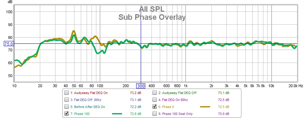

Hey J. You should set your vertical from 45-105 for a 60db window. I think it's more accurate.(also the REW help files mention this too). Anyway, not sure if the shallower roll off is a tuning change, but it looks significant to me. More interesting is the trough from above 50-90hz. To me it's deep enough and wide enough to be an issue, since that's an important frequency range. Especially at a 12db difference. To me since the XO is 80hz, you have a phase issue. Since the subs are gain matched you might try adding and subtracting a foot at a time in the avr and measuring again. If you add feet in the avr it will shorten the delay time to the sub signal and A) possibly level out the trough, and B) improve impulse response. Maybe...

I think William is correct. Now that's not absolutely certain, but if that is in fact a phase induced notch, you should be able to make it go away. (Kudos on being able to actually have a phase notch show up in your measurements, as it's most often obscured by modal response with 'in-room' measurements from the listening position. The close proximity of your subs to mains, and having a couple of subs for modal smoothing may account for being able to actually measure it. You're in the home stretch with this.)
That sort of notch will appear if the hp and lp are slope and level matched but 180 degrees out of phase. If the subs have a simple two position phase switch, take a measurement with it toggled to the other setting first, before changing sub distance in the AVR. If that does not reduce or eliminate the notch, then do as William suggested and add distance incrementally and re-assess until you get there.
If you can make the notch go away by adjusting the phase/distance settings, next look at impulse response. You'll find that you will get flat freq response, but the impulse response will likely be off, a full cycle or an integer multiple of that at the crossover frequency, which is more than a simple polarity switch on a sub can accommodate. You can then use the AVR distance settings, which can accommodate this, to restore or achieve optimal impulse response; it may help you dial in impulse response to add distance to the mains rather than to the subs depending on which, hp or lp is leading. The distances you set in the AVR may have no relation to actual distances in your room, or they may. Trust the measurements when doing this.
You get all that taken care of and you'll start to notice more resolution and detail in the critical mid-bass band than you realized was possible.

Here's an overlay with the 2 different phase settings. Listening to it, with having to get up, switch both subs and jump over the audio measurement obstacle course I have in the living room I'm hard pressed to hear a difference, but I *think* phase 0 sounds best. I'm not sure how to interpret the 2 measurements in this overlay, but I do hear that difference in volume on the bottom end.

Okay! This overlay is accurate. I had everything right for all previous measurements. It was just that last chart.
I'll say again that I think phase 0 sounds better. @William Lemmerhirt, I changed the vertical axis to what you suggested, I think? Is that right? It sure looks prettier that way... :p

That scale seems a little tight, doesn't it? Or is 5db too loose and 10 is the norm? Did I do it right? I'm still half lost with this crap.

Not surprising, the graph is better at 0.
I will have to look for the exact reason why(since I'm not a professional lol) but iirc the 60db window represents how we hear. Similar to using 1/6 smoothing vs higher smoothing levels.

Ah. What I did was average 6 measurements around the mlp and used 1/12 smoothing. Oh, and changed the vertical axis.
Looks good.

Phase 0 should sound better since it doesn't have that large dip from 90-110hz.
