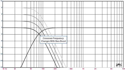

Sure, you can, and by doing so you'll change the effective crossover frequency and mess up integration between the drivers. That may not matter if all you want is simply and crudely 'MOAR BASS!' But the point I'm trying to make is that being able to adjust an amp to different levels for bass drivers does not magically sidestep the requirements of crossovers, be they between tweets and mid-woofs or between mains and subs. It does, though, introduce a route to messing things up. I strongly feel that Pogre should skip passive bi-amping of his towers in his system tuning endeavors.

Sure, you can, and by doing so you'll change the effective crossover frequency and mess up integration between the drivers. That may not matter if all you want is simply and crudely 'MOAR BASS!' But the point I'm trying to make is that being able to adjust an amp to different levels for bass drivers does not magically sidestep the requirements of crossovers, be they between tweets and mid-woofs or between mains and subs. It does, though, introduce a route to messing things up. I strongly feel that Pogre should skip passive bi-amping in his system tuning endeavors.
Passive biamping, if done correctly, should not mess up the crossovers because it is using the same crossover network that gets separated into 2 such that overall it should work the same way. Perhaps we are not talking about the same thing.
Yeah, perhaps you're correct Peng. This is a learning opportunity for me, so let's look further.
If one arbitrarily boosts the low pass part of the above idealized graph, will the new, boosted signal have the same slope? It should, it's going through the same inductor and other passive bits after all. Will the f3 be the same frequency? I'm not really sure, but if it's not, at least relative to the hp signal, then the lp and hp won't sum flat.
Anywho, I still feel that tweaking sub amps, or the amps used for passive bi-amping of speakers, seems like a really expensive and potentially problematic method to affect tonal changes, which is better done upstream by tone controls and eq. Setting up crossovers between subs and mains is fundamental to system setup, and should be "set and forget" once accomplished, for optimal freq and impulse response. Once you have that, then eq to taste.

What? Sorry, bra, I refuse to get into some sort of pissing match with you about this. I have said nothing that contradicts basic filter theory, but I don't know everything and am here to learn while we discuss Pogre's system (not yours, not RBH, or anything else you hold dear...start your own thread if you want to push gear you're a sales rep for).
If you can answer the question I asked in my previous post, go for it. Here's my take, fwiw:
The f3 will be at the exact same frequency, as nothing has changed that would alter that, and the results of boost would be like so (and @PENG, this should contextualize what I was asking about):
This applies if we're talking sub/main crossover, as pictured, or a mid-woof/tweet crossover in a passive bi-amped setup. Even if those boosted bass plots did manage somehow, miraculously, to sum reasonably smoothly (fat chance), it would exhibit a significant shelf at frequencies below that, which is a problem in itself. I prefer a smooth 'house curve' at the main listening position, not some boomy shelved bass response. But that's just me.
