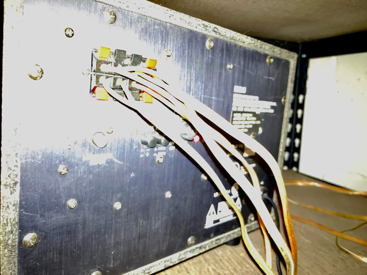

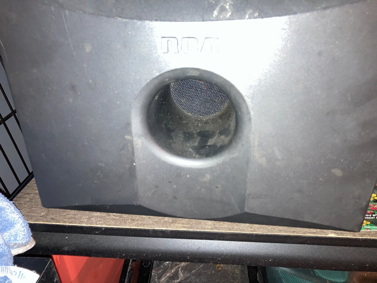

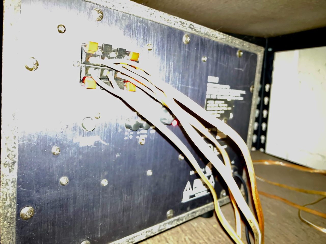

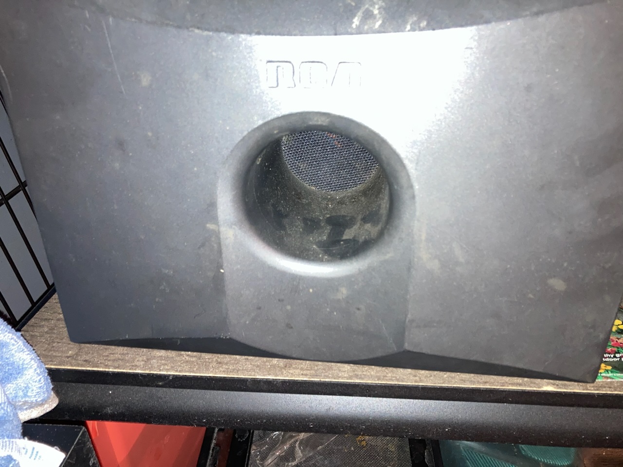

to the op this is how one of my mini subs are set up , honestly this sub barely makes-enough bass to use .
Do this
Do thisView attachment 61326View attachment 61327
