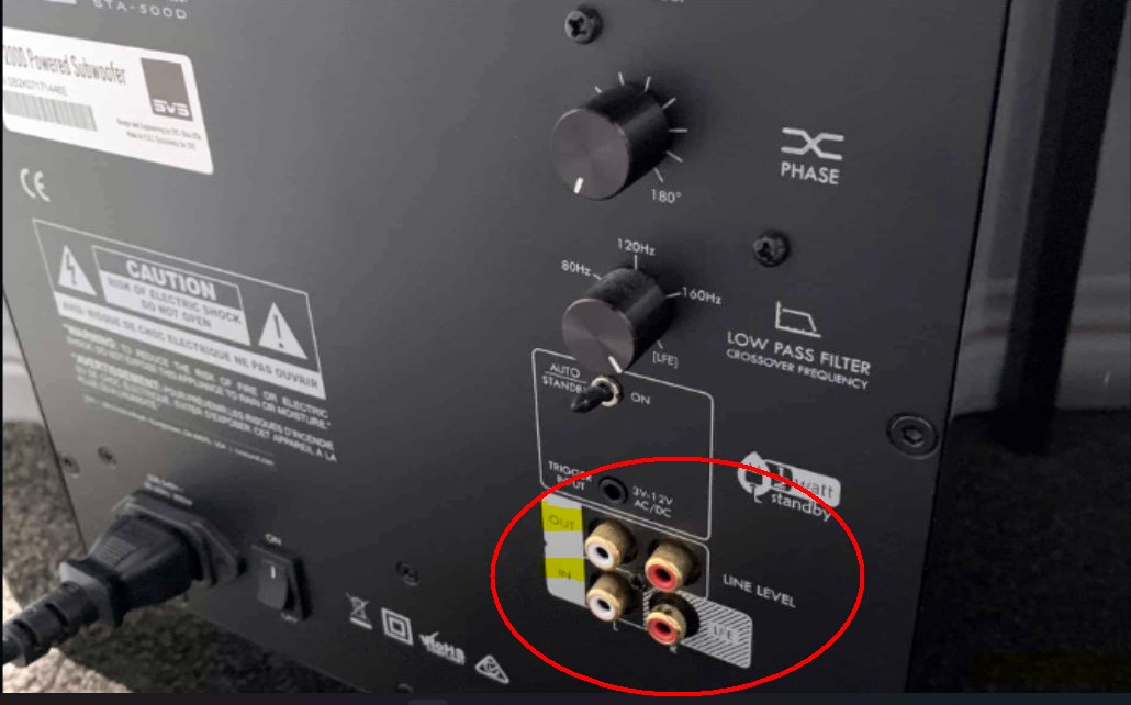

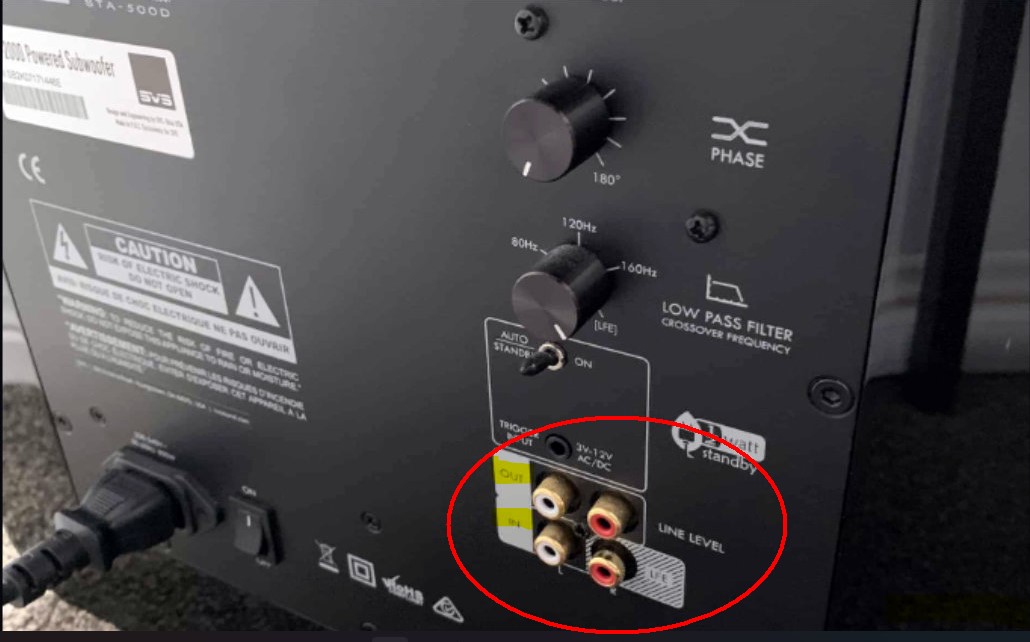

I didn’t see any speaker inputs , how is this going to work without a subwoofer output on the ops integrated amp?
Works quite easily....
Preamp out to sb-2000 input.
sb-2000 output to integrated amp. electronic crossover achieved...easy peasy.
This thread could have stopped at 3 replies if the sb-2000 was suggested then.
Otherwise TLS Guys suggestion of an acoustic crossover is the best suggestion....tried and true and easy works just fine.
You send the pre amp outputs to the sub line inputs, and connect the sub line outs to the power amp inputs. Strangely this sub has limited bass management with an 80 Hz crossover frequency only.
The OP does not have an integrated amp, but separate pre-amp and power amp. That is the best way to do it, with voltage gain and controls separated from the power amp section.
Line-level, not speaker-level. Did you notice what I circled?
(a) OP doesn't have an integrated amp. He has separate pre-amp/power amp.
(b) he HAS a line-level sub out, but won't actually need it in this scenario because it has no bass management. Line-level L/R is routed to sub. Sub handles below 80Hz. Above 80Hz is sent on to the mains.(roughly, it's sloped not brick wall)
