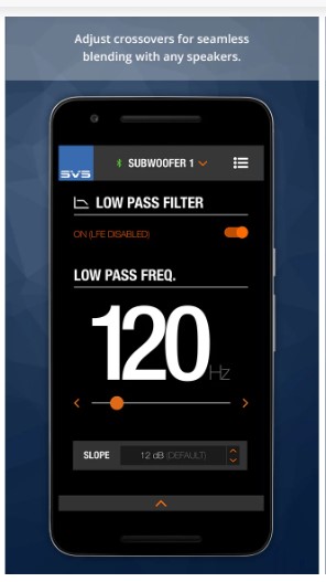

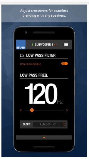

The manual is a bit ambiguous on whether there could be variable HPF adjusted by the app? (inverse of the LPF)
Most Stereo Receivers and Pre-Amplifiers do not have bass management. Instead you will use the Left and Right full-range outputs and make adjustments through the DSP amplifier on the subwoofer. Be sure to connect both Left and Right outputs to the Left and Right inputs on the subwoofer. Set the Low Pass Filter to “On” and adjust the Crossover Frequency and Slope to achieve a smooth blend and transition with the main speakers. Once blended, adjust the Subwoofer volume to match the volume level of your main speakers

According to SVS support, the line-outs on the 3000-micro are pass-thru only (ie no HPF).
