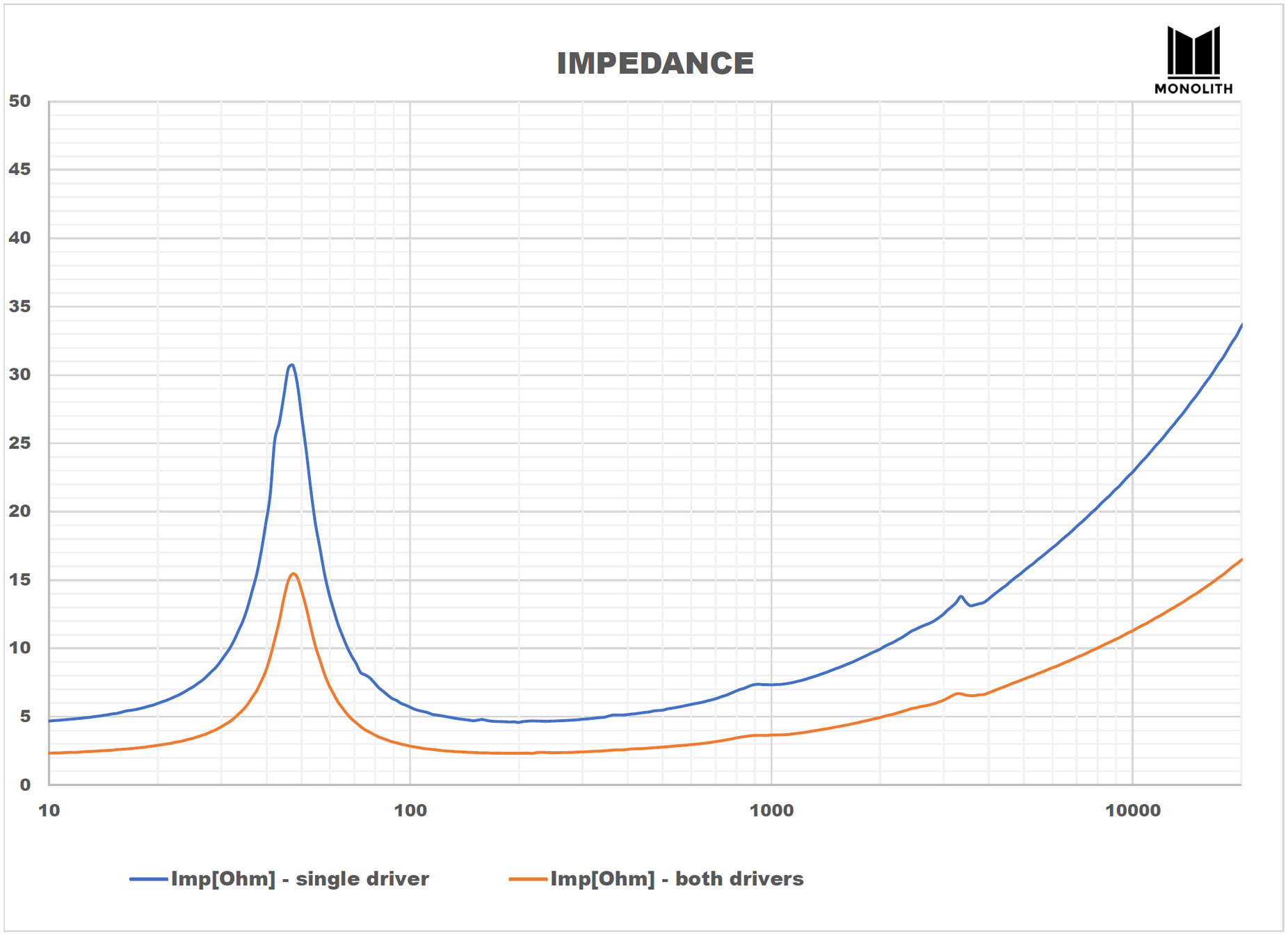

However, the impedance of this unit with two drivers in the bridged terminal format is around 2 ohms. The impedance curves below must be with the port sealed as there is only one peak of impedance.

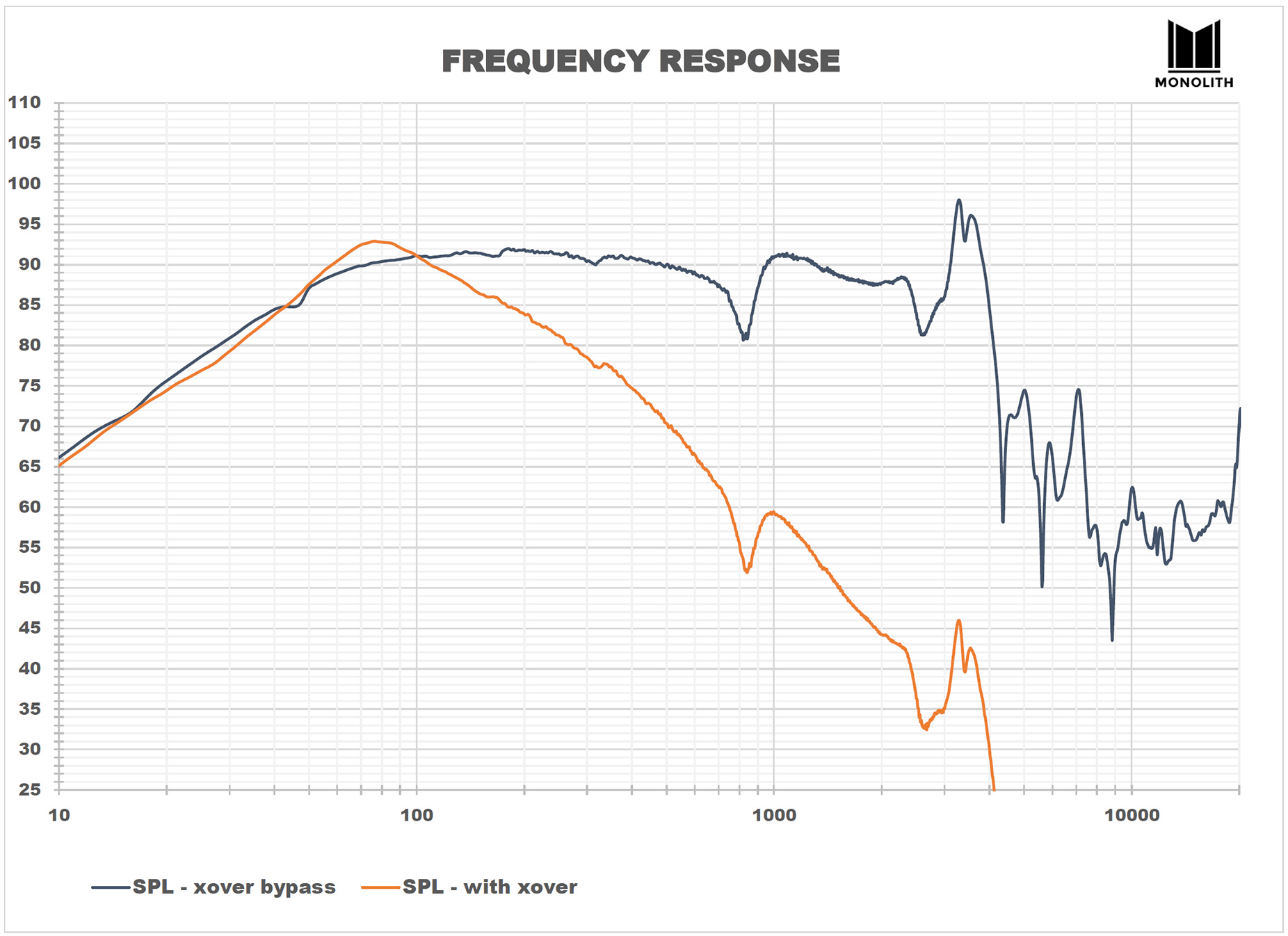

Now the frequency response.
With the internal crossovers, the FR is particularly obnoxious. If used from pre outs with external amps the FR is much better, but it does not really justify being called a sub with an F3 of 36 Hz.
This unit really concerns me, as used in passive form, this unit is likely to blow up a lot of amps. The unit is unlikely to be connected to an amp capable of safely driving the unit on grounds of cost.
The only way I can see to use this unit safely, is from preouts, and use an external two channel amp, with the terminals UNBRIDGED.
