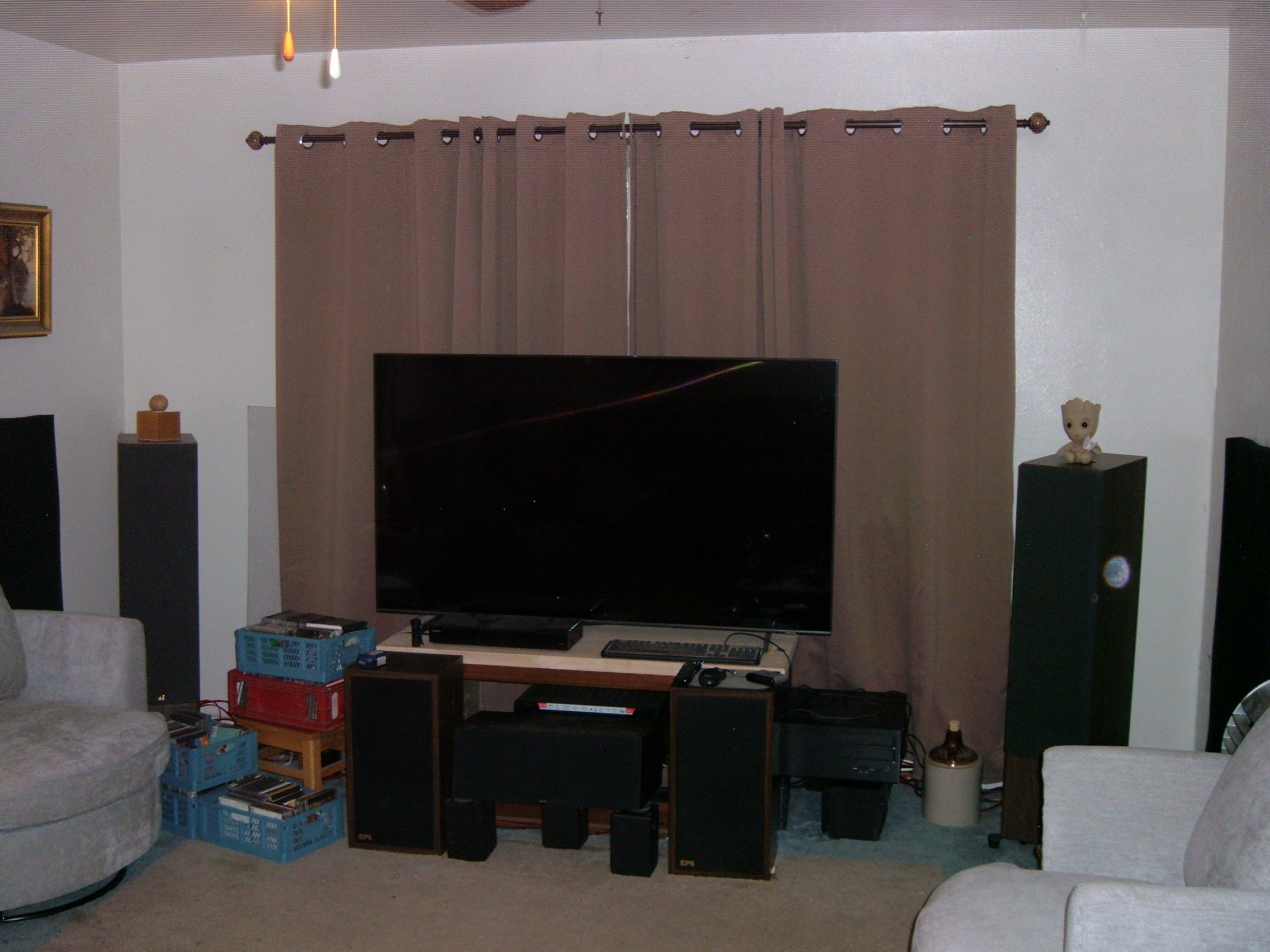

Auxiliary front amplifier;
To drive the "power hungry" polk r700 speakers; class A-B, Crown Xli-800 driven by signal from the Denon's pre-outs.
https://www.parts-express.com/Crown-XLi-800-Power-Amplifier-2-x-300W-at-4-Ohms-245-5126?quantity=1
Front main speakers; polk R700; Note; I have never liked the sound of the tweeters in these speakers, however, at the time of
purchase, they sounded adequate in comparison to the blown NHT's and were the one of the few contenders locally available for audition...
Front sound absorbing panels (one on each side);
Shortly after receiving the R700's, after initial setup I noticed a distracting reflections from the walls (Standard 1/2 inch
drywall with low texture and semigloss paint), I made up some foam trial panels and they seemed to solve the issue; so I ordered a pair of 2' x 4' triangular cut foam acoustic panels from Amazon. Note; the r700's seem to be more prone to annoying acoustic reflections than the old NHT speakers.
Center channel speaker; SVS, ultra evolution center channel.
After implementing the SVS I was pleased with its high end and mid-range but it seemed to lack any low mid-range or bottom end. Since I was re building the old EPI bookshelf speakers; I decided to try them alongside the SVS ... problem solved, they both enhanced the over all center channel (and system sound) and gave the center channel a solid bottom end.
2 Resurrected EPI 100 bookshelf, 2 way, speakers (circa 1970's; Saved from demise by Human Speakers' drivers)
8" Human woofers (1 ea.).
and Human 1" aluminum inverted dome tweeters (1 ea.).

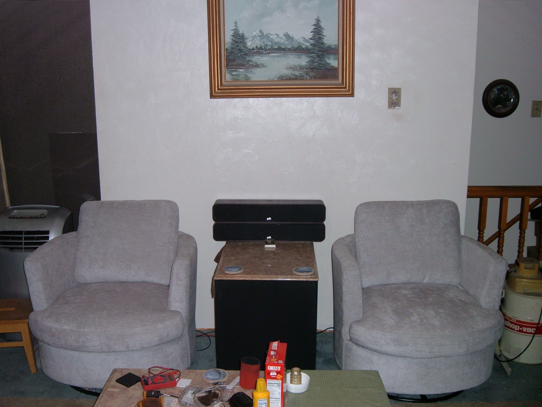

Surround L & R
2, stacked, polk ES-35 sound bars (on each side); to minimize living space intrusion... mostly; & because I had accumulated several. ... they can be used as adequate mid-range speakers (don't expect high highs, lows, or even fair bass). (I may replace the tweeters with something better; if I get bored this winter; I have some 3/4 inch Peerless dome tweeters in stock that look like they could integrate well into the ES-35's; but I am getting antsy to try some air motion transformers...). Bass wise one pair is sitting on the RSL 12" speedwoofer...
Sub-woofer; (see right pic , center)
RSL 12" speed woofer.... because I could...
During implementation of the speed woofer (Silly name, IMO) I was pleased with its affects on the sound of the room; I have noted, in the past, that the addition of speakers with a low resonant frequency lowered the room resonance. In this case it makes turning on the speedwoofer's amplifier, almost, a negligible exercise. There are few recordings that actually activate the speedwoofer (set to 80 Hz crossover). And for recordings with substantial lows, I end up turning the speed woofer down or off to avoid oppressive bass.
... on reflection two 10 inch subs would probably have been a better choice... However, they would not make as nice an end table...

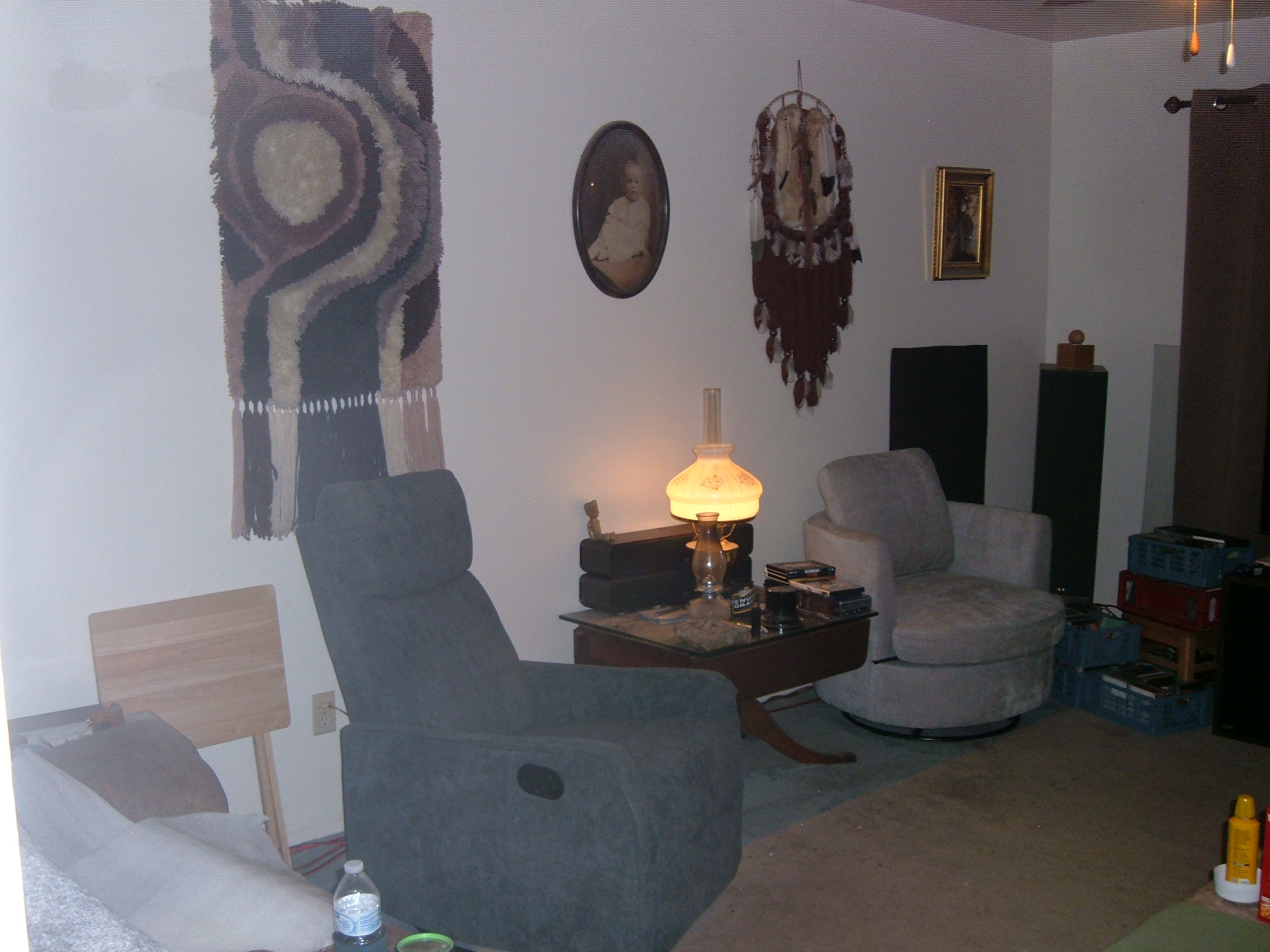

Seating; 3 swivel occasional chairs; for "normal"/non-audio folks; these allow people to turn to face each other for conversation or turn to face the TV, to watch a movie. They are adequately comfortable and low enough that they don't affect line of sight to the tweeters.
Overall the sound in the room is good and remarkably consistent from position to position.
One swivel rocker, recliner; can easily move into the sweet spot for critical listening.

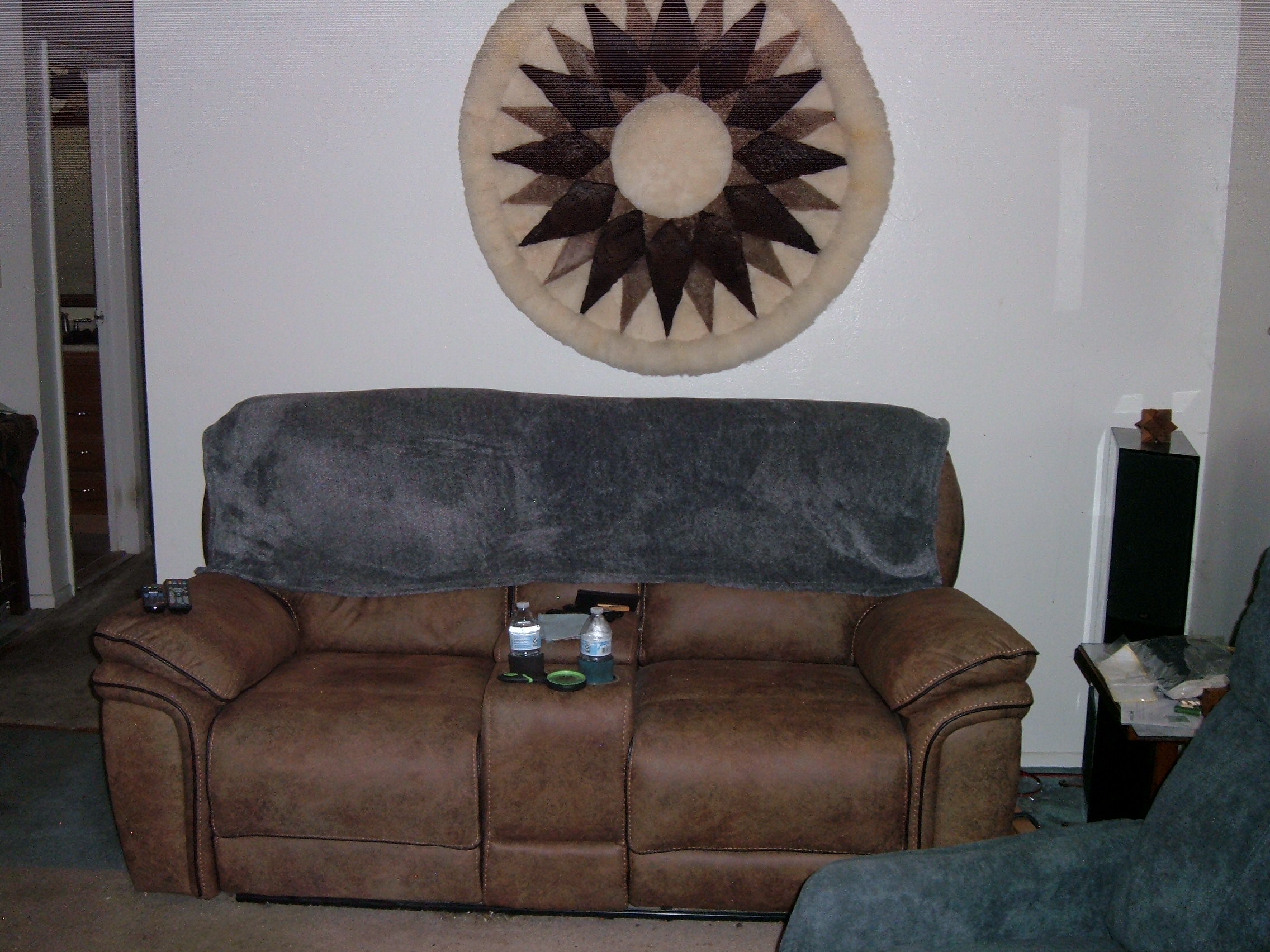

One 2 position recliner couch; for "normal"/non audio folks, against the rear wall; I know the placement is less than optimum but, of all my friends, there may be 2, besides myself, that might notice.

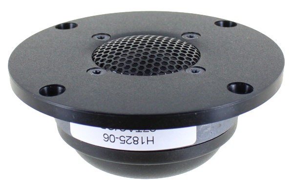

Its been chilly here so I decided that it was time to fit the Seas titan tweeters (Seas Prestige Titan 27TAC/GB (H1825) Aluminum/Magnesium dome tweeter) into my NHT 2.5I rear speakers, so I spent some time turning down the seas tweeters' face plates to fit the speaker cabinet re-leafs.
It should be noted that the following is largely subjective since parts of it are based on my hearing, and while I was careful to try and avoid the; "the car runs better because I waxed it" syndrome some leakage is possible...
I installed the Parts Express titanium tweeters (DC25-8) initially because they were available and cheap. These titanium tweeters are fair to good but not great and only rated to 18 kHz (adequate). ... they are my fall back replacement tweeter and produce acceptable sound, IMO.
When the Seas tweeters became "in stock" I ordered a couple because of their response curve; and the NHT's came with Seas tweeters originally (20 + years ago)... I felt that it was likely that technology advances would , probably help the sound and one of the original tweeters has an intermittent open... I do believe that I can still get new domes and voice coils for the original tweeters, but its time for an upgrade.
I also made a couple of push on adapters to use the existing narrow /negative push on speaker connector with the wider connector on the Seas tweeters.
The modified Seas tweeters were screwed to the cabinets.
The sonic changes are subtle;
My initial listening impression was that the Seas Titans are smoother and, perhaps, a bit more detailed.
They also seem to bring out the ambience on recordings better..
I found that they seem to make the sweet spot, in the room, (used for critical listening) bigger, especially toward the rear (the new Seas tweeters are in the rear speakers).
I do believe that I have found a new favorite tweeter!
