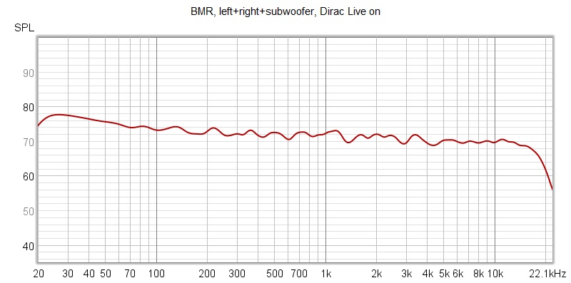

miniDSP SHD - Roon Ready Preamplifier with Dirac Live® room correction
Minidsp SHD Review Updated (DSP, DAC & Streamer) | Audio Science Review (ASR) Forum

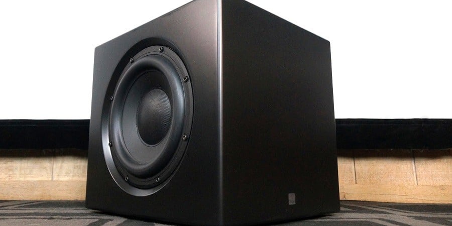

I agree, that sub would be of a quality commensurate with the rest of his system. I agree that he should not be trading way down to an AV receiver.
That Sigberg sub would really complete his system.

So, any SVS or similar subs with high pass speaker level or line level output kind of solutions are not likely going to be acceptable to him.
He doesn't have a lot of ultra-low-noise options based on the HW he has to work with and what he can introduce in the chain. The miniDSP is no stellar champion in the specs department either. Some compromises will need to be made.
The SVS sub mentioned was not a recommendation for that sub per se. It was an example to show that, yes, there are subs out there with HPF (one poster in this thread implied they were super rare).

I have a very similar 2 channel application so I have been researching for a solution for month. So far, the only one that comes close in terms of budget constraint, practicality and tweakability, is the minidsp SHD. (post#92), but I am waiting for others on this thread, to suggest even more affordable but comparable in terms of theoretical performance options.
Actually performance in terms of FR is very nice using the 2X4 HD so for sure the SHD will work, but I know the 2X4HD's SINAD is lower than that of my DACs and power amps so I don't really like this solution, but even on the practical side, the minidsp 2XHD's 2 V output is just too low, the SHD's 4 V is much better, obviously.

The sub should be small and I don't think 2 subs are an option due to space concerns. When he saw my 2 sb2000 he said those are too large for his room. That is why I looked at sb3000 mini which is significantly smaller and can still go low enough for music (only music).
I understand, it's a dual 10 opposed so both are in the same sealed box and is around the same size as your SB, which I consider small, FWIW. I'd still push him as he will be much more satisfied overall then with a compromise for a few inches. Hope he appreciates all your help, as sounds like he will have a nice little system.

Yes, I missed your miniDSP (S)HD post which at $1300 is way more than I expected (and $400 more than the SVS 3000-micro SW the OP might consider). So, I wasn't considering those solutions that cost more than the SW itself which doesn't make any sense to me, but to each his own. And though the room has been referred to as "small" I'm beginning to get the idea that it might be a closet. :D

and is around the same size as your SB[2000]
The 3000-micro is sized around an 11 inch cube. So, it shaves another 3.5 inches off the already modest size of the SB2000. That's why I think the listening room must be a walk-in closet. :D
Just a few notes on the SVS Micro 3000 sub. It is dual 8", not 10" and it does not appear to offer a high pass filter.
