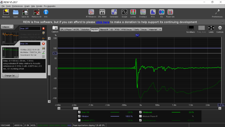

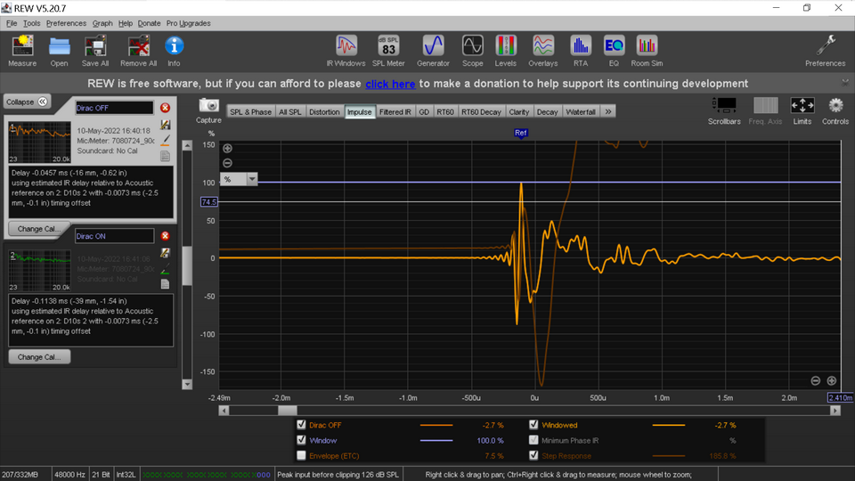

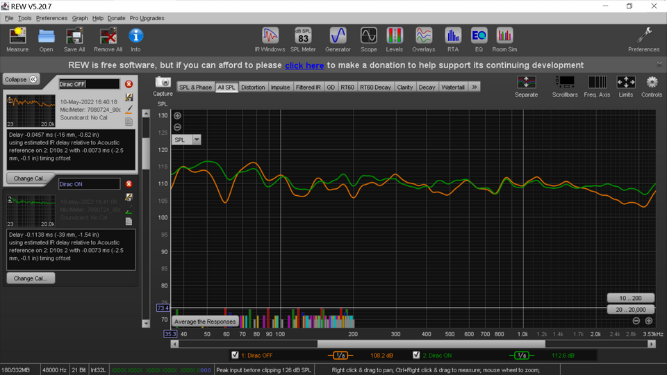

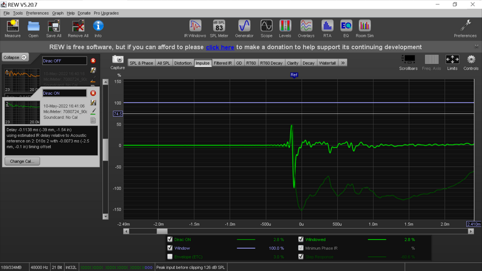

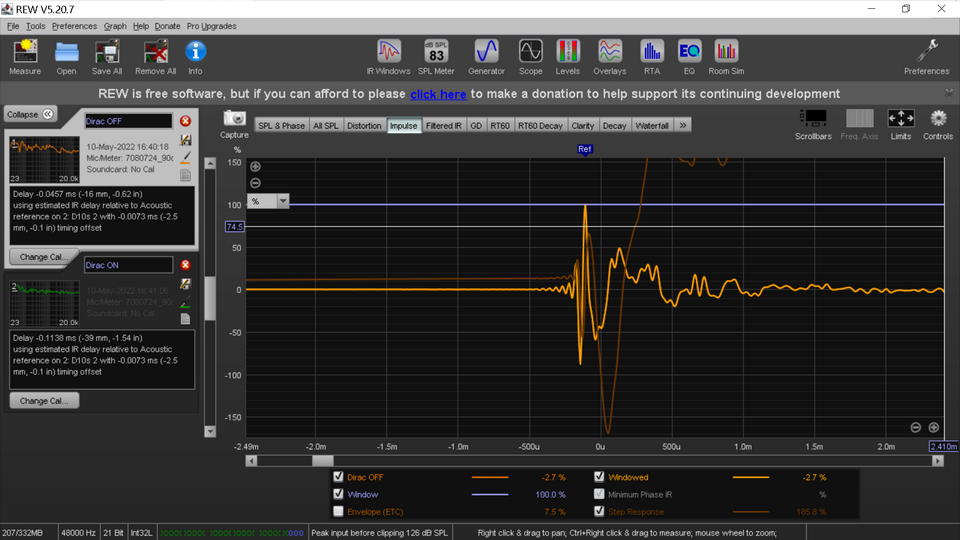

Now this is totally off topic to the A8A but here is an experiment. I connected a PC directly to my DDRC24 Dirac box, which then output to an amp in 'pure direct' mode to my right lounge speaker. I then ran frequency sweeps in REW , one with Dirac on and the other with no room correction at all.
Now my right speaker is flat to +/-5dB (80Hz-20kHz) at my listening distance of 11 feet without correction. Dirac changes that to +/-3dB. Though very difficult to distinguish by ear. So it isn't that which makes things sound different withDirac On or Off.
This is the Impulse display without any room correction -
And here with Dirac ON -
Now I don't know exactly what they are doing to the signal to get that difference, but it does actually sound clearer. :)

Maybe I can explain a little more clearly. I can see why it doesn't seem to make sense. :)
If I were to do a REW frequency sweep of the Dirac and also the non-Dirac YPAO, then applied the 'psychoacoustic' smoothing option there would be little difference between them. Yes, the raw Dirac is much smoother but doesn't actually sound much smoother due to the way our hearing works.

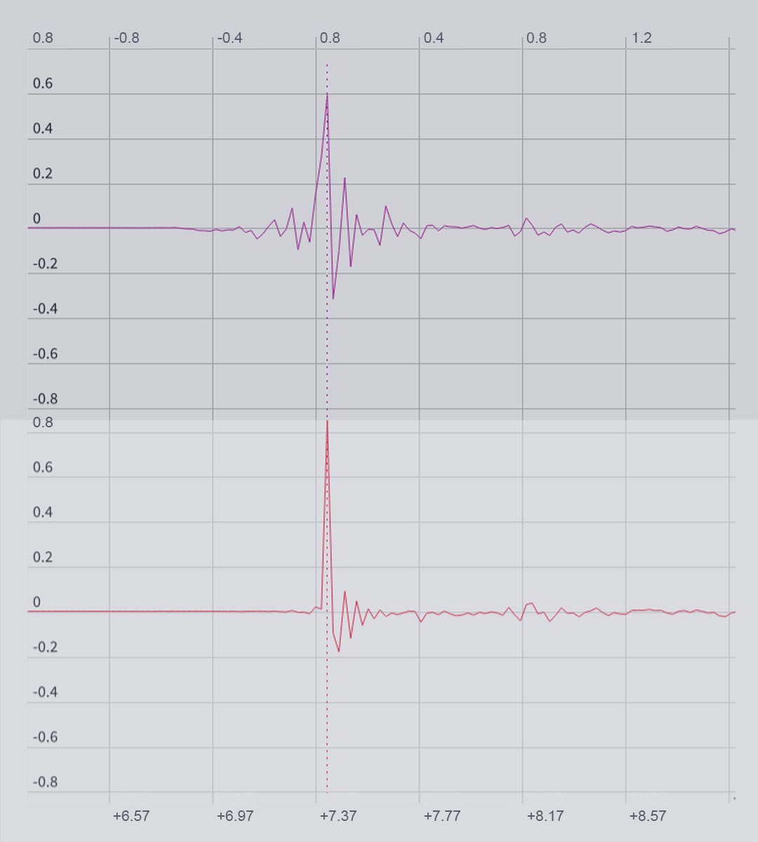

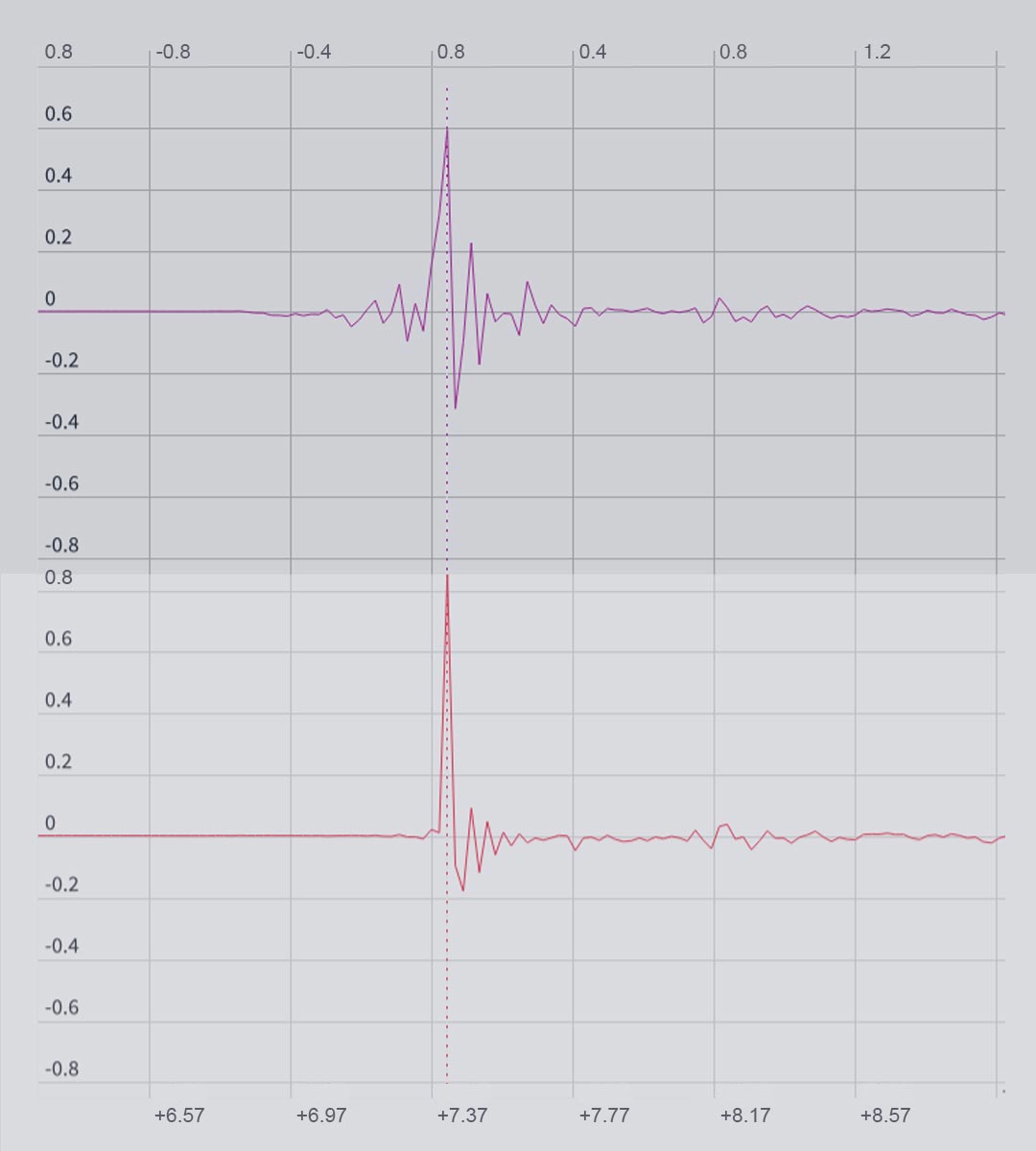

What isn't shown by the frequency graphs is the impulse response. I will quote from the Dirac website -
Impulse response correction
A loudspeaker’s impulse response affects clarity, detail, and all spatial aspects of the sound. Dirac Live® is unique in that it corrects the impulse response throughout the listening area, not just at a single point. By focusing on consistent problems across the measurement positions and correcting only these anomalies, Dirac Live® can achieve a faster decay time. Typically, the power ratio between the direct wave and the tail (later-arriving echoes) is improved by 6 dB or more, resulting in a vastly improved overall sound.
This illustration is from the Dirac website, it shows the normal pulse followed by the corrected one. I've seen the same thing happen with my measurements in REW -
It makes everything sound crisper. I didn't like the sound at first but then grew used to it. Dialogue is clearer in drama stuff. Music is also changed - often for the better - but with some music it seems to remove some 'atmosphere'.
I've read a lot about Dirac but only a few people seem to mention this - to me - blindingly obvious difference in sound.
I was actually delighted by the sound of my A8A before I had the Dirac option. So perhaps better to ignore my post and stay happy. :D
