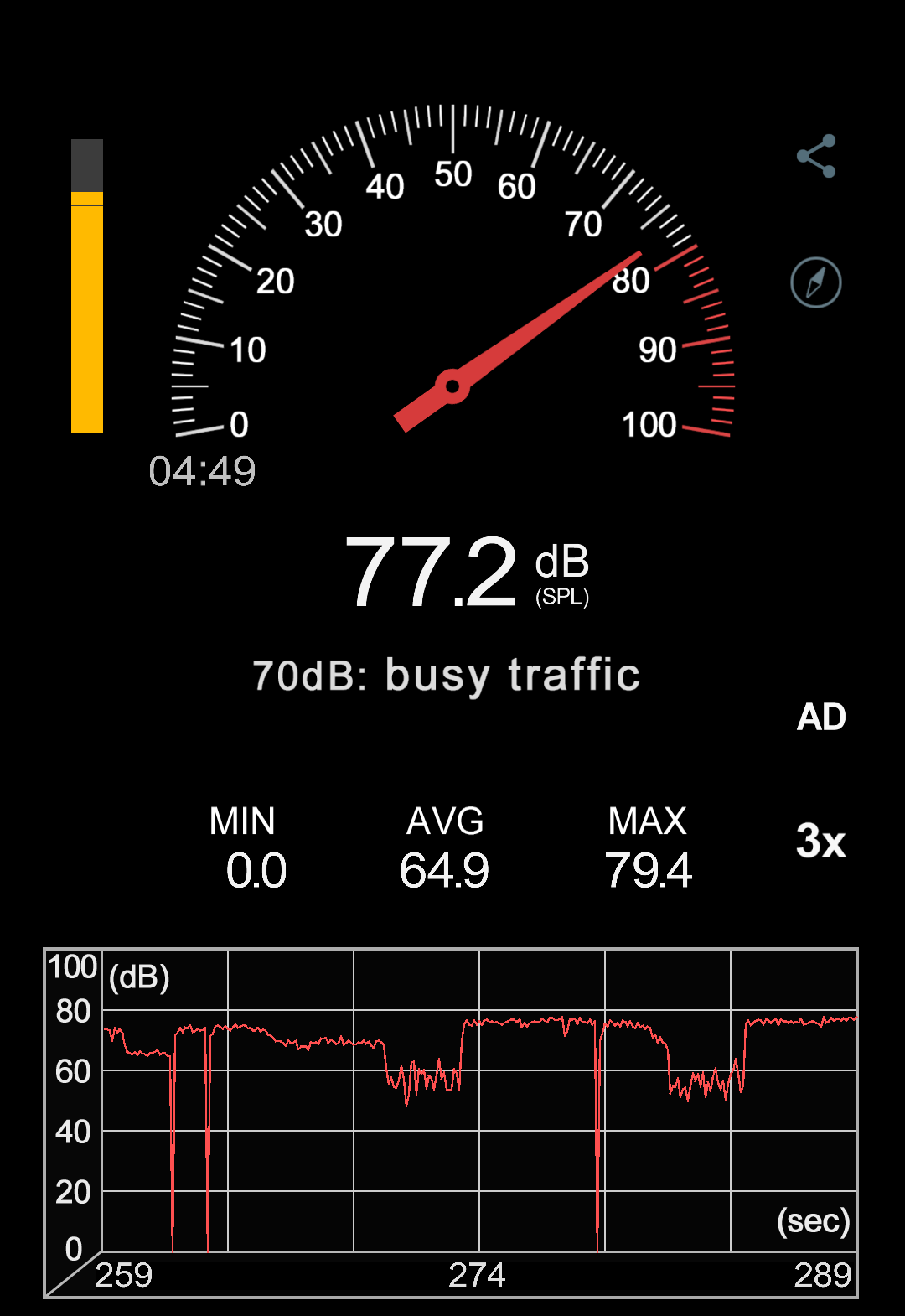

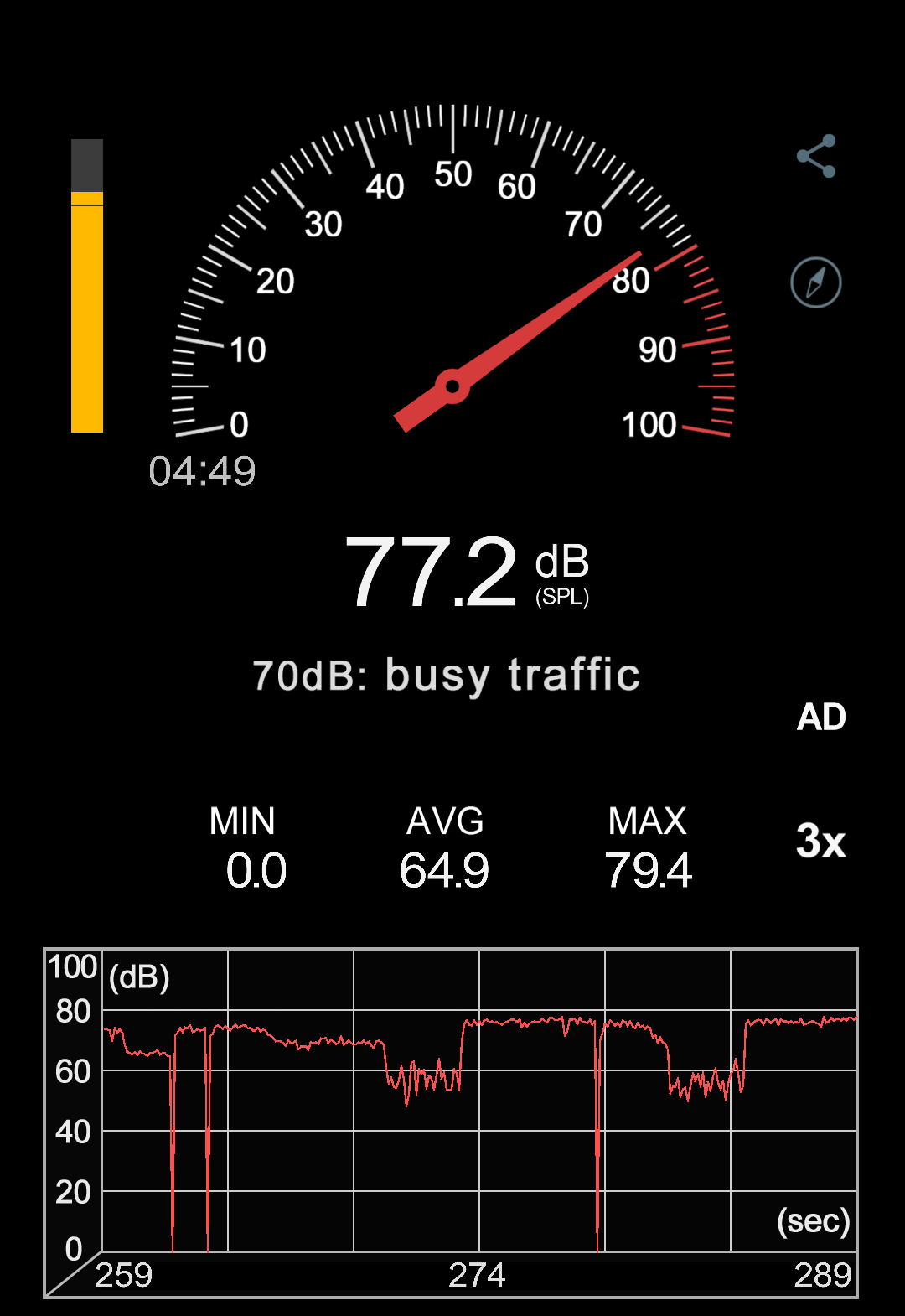

I likea lil hot,
Replicant 7
Replicant 7
Please don't tell me you're using an app on your phone for an SPL meter....right?
Yep, :D I'll get my son meter tomorrow and his tripod. But for now close, my surrounds where off, also sub was only at about 66dB
