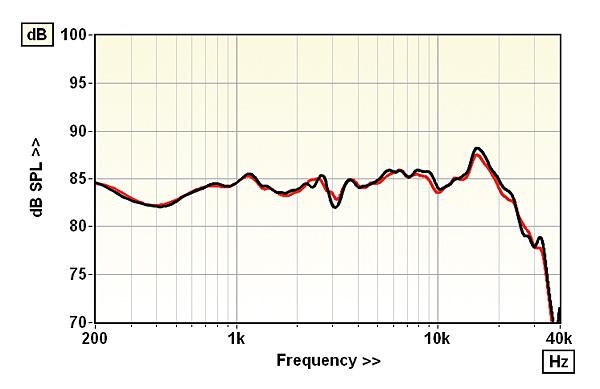

This is the FR.

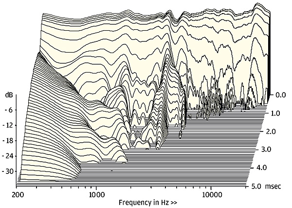

This the waterfall plot.
In the crossover region, impedance has been shown to drop to 2.7 ohms, with a phase angle between voltage and current of -65 degress!
The reviewer described the sound as lacking in body and brash.
So these speakers have to be added to the very long list of incompetently designed speakers.
All this data shows severe problems at crossover, especially the waterfall plot. The FR, impedance and phase angle confirm incompetence.
The tweeter is obviously getting into trouble at around 10 kHz.
The thing though that probably makes this speaker perform so poorly on music though is that dip centered on 400 Hz. A speaker really must have a midband response as flat as a pan. A tip like that centered on 400 Hz is highly audible, and that sort of response really produces a poor sound lacking in body.
