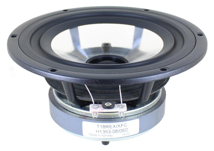

I built my design around this driver. This driver is ideal for TL, but models well in ported and sealed solutions.
This is a potent driver that can handle 200 watts continuous power. A SEAS crossover has subsequently become available.

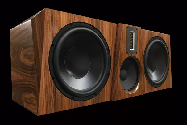

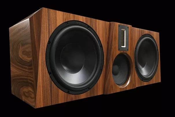

I don't know about any measurements, but this one is pretty large, as well. Legacy Audio Marquis XD.
Danzilla31
I love Legacy just out of my budget! That is a monster I think those are 2 12 inch woofers and that's a 7.5 inch midrange combined with a pretty robust AMT
In my opinion that's the way you do it no replacement for displacement! :D

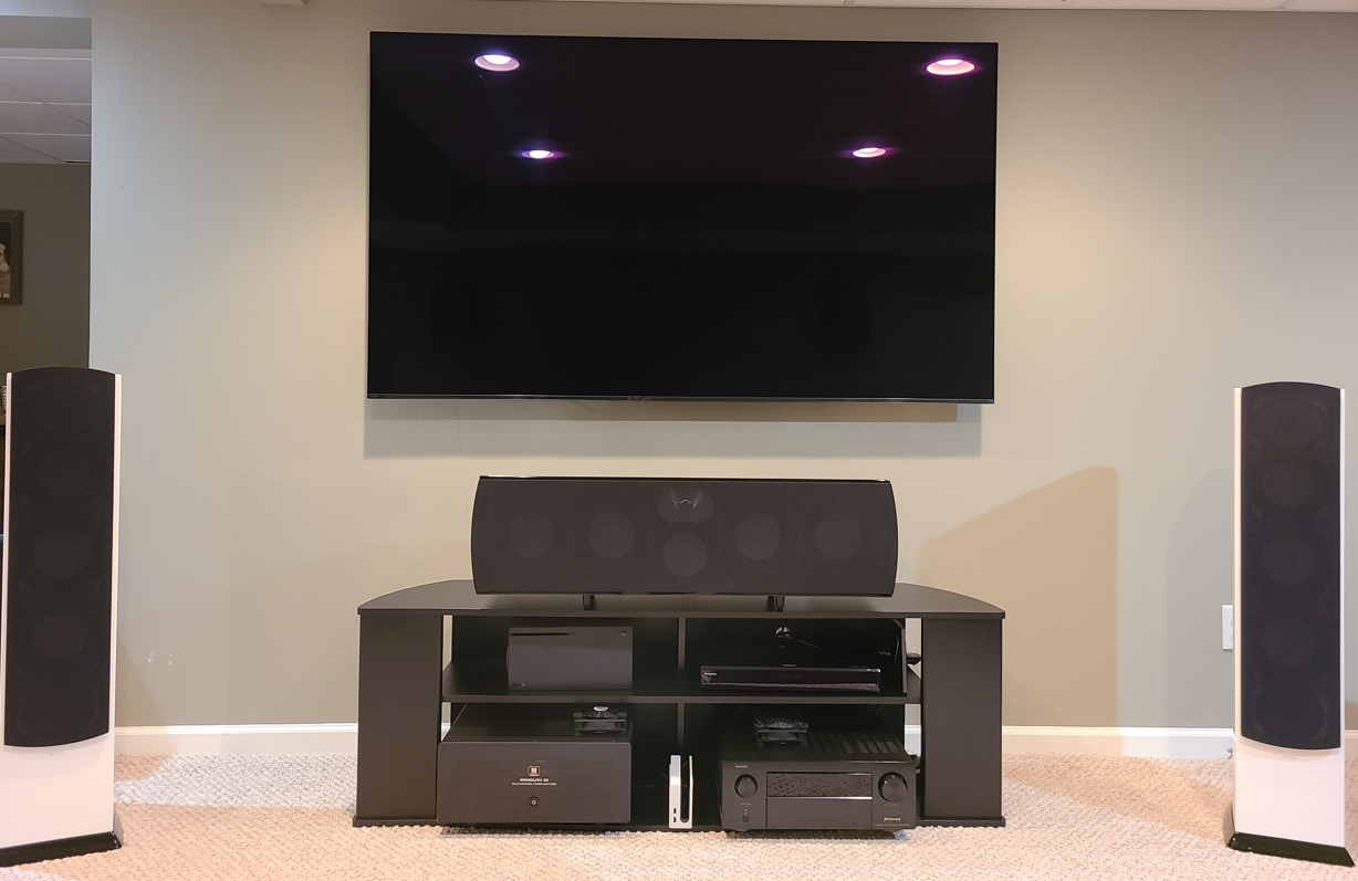

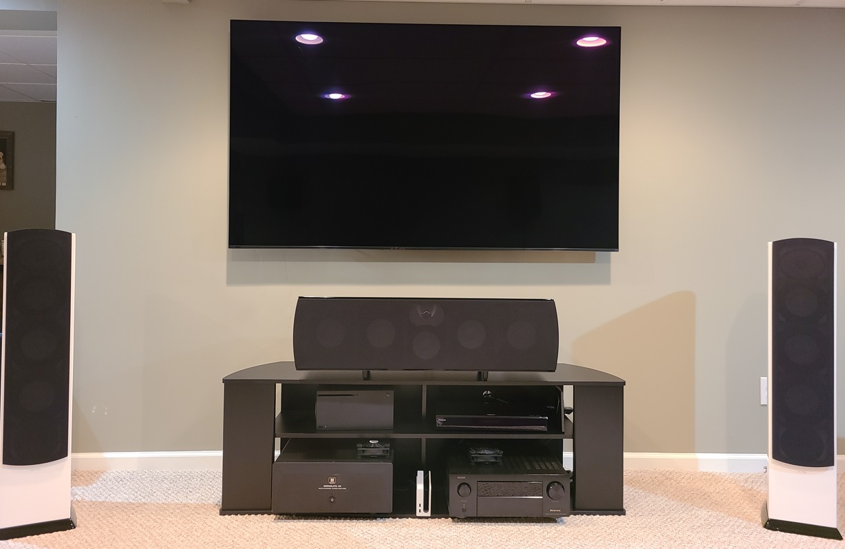

Much appreciated Doc. There is no rush on this. I have to finish some cabinet work in the recroom first. 2 drawers built last weekend but six more to go.
I will likely be moving my Panasonic plasma and Denon AVR upstairs and upgrading the recroom system as the TV & AVR are 10 years old now, but they have been a rock solid performers. No pre-amp outs, though, so I will likely need a passive crossover. At least this room is rectangular with 8 foot ceilings so I won't have any of the nasty room boundary issues that I have downstairs. (The recroom probably has the worst acoustics in the house :) but it's all that I have to work with.) Need to design some back boxes for the in-walls as well. I'm hoping Paradigm can provide the proper dimensions.
Danzilla31
I bet. That poor TV stand is being asked to do a lot.
What speakers are those?
Those are Revel with the beryllium tweeters if I'm not mistaken helluva good set of speakers endgame speakers for most for sure
