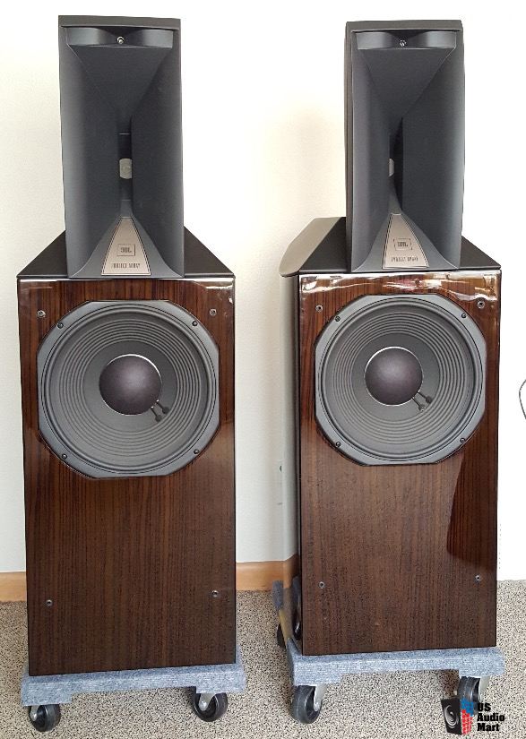

Wait til you see the matching L/R speakers that go with it! Lol
I have little doubt they are excellent speakers but performance over aesthetics don't always make for a pretty package, lol.

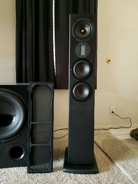

My end game right there I’ve got a line on a pair these aren’t for everyone looks wise but holy crap they sound amazing . Keep in mind this line was basically designed for digital sound sources sacd’s and the like . But I will have a pair of the array 1400’s lol .
Pogre
Pogre

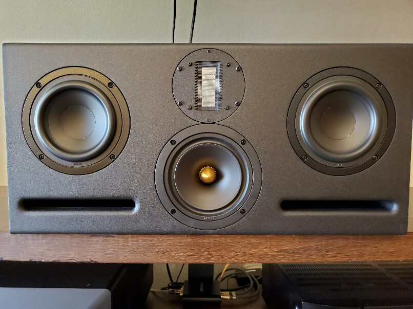

You can still find these on eBay and still pricey too but very well built no comparison to the other centers I’ve had . One of the flattest measuring center I’ve ever seen but like almost all centers it’s not the best at off axis response but hell none are . But in a nice room who sits more than 60 gegrees off to the side it works best sitting about 12 foot away .
I'd guess you wouldn't too much in the way of off axis issues with the tweet and mid alignment. You'd have to get pretty far off axis for it to be an issue.

Decent review of it on ASR last fall . But that’s a hard crowd over there lol !

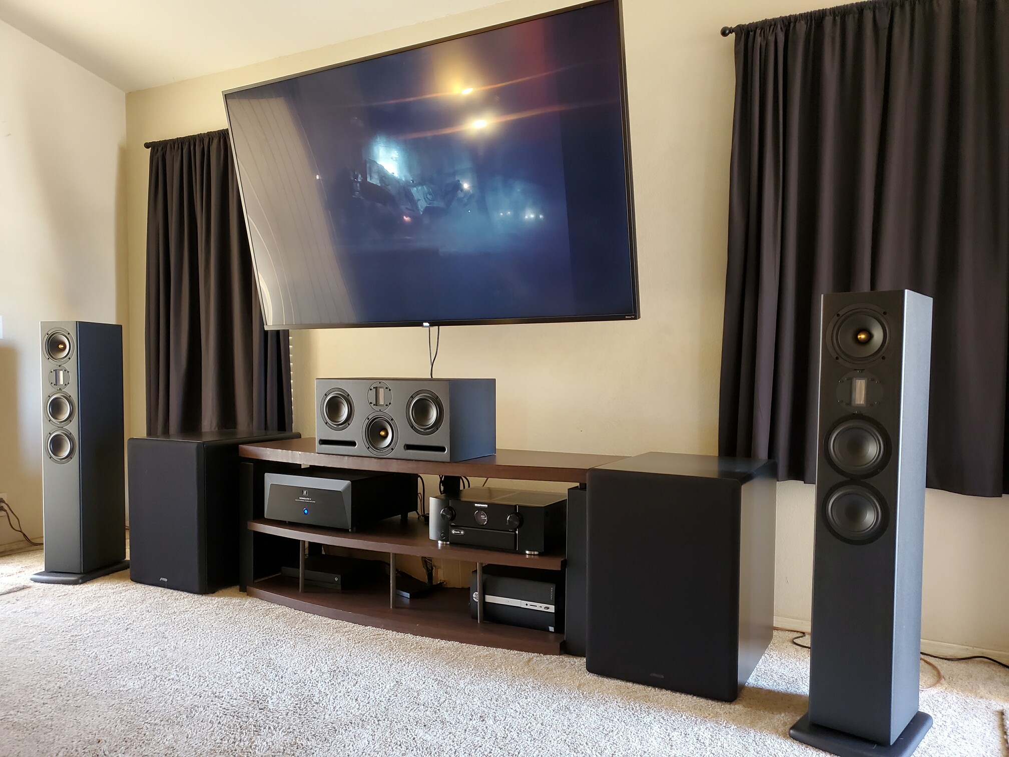

Not trying to be rude, but HOW far is your TV from the Ceiling?
My Tv is about 30" from the ceiling and I am looking upwards a bit......
Several feet. I have vaulted ceilings. It's a bit high, but not uncomfortable and does not feel odd When I'm sitting in my chair watching TV. The bottom edge of the screen is still pretty well below eye height.

I have neck problems, and can never look Upwards...I had a real reason to ask. All good!

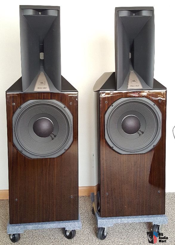

Have to say, as a nuts a “volts” kinda guy, I like these. Even as much as I love my monkey coffins, they look so Fukkin boring. I’m also so over the whole minimalist, WAF, happy wife, hey let’s have a home theater but really it’s a BT bose wave radio, and now that we have our soundbar, I don’t really get why people are into this overpriced crap.
I can appreciate minimalistic design. But not over function. Your pics remind me of when I walk up to a top fuel dragster(something I’ve done since I was about 5yo). I know exactly what it’s for. Performance, ftw. You can bet if I ever get to your neighborhood, I’m knocking on the door!!!
Just 'cause they ain't pretty doesn't mean I wouldn't have them proudly front and center in my living room. I like your comparison to a top fuel dragster. I'd say that's pretty durned accurate!
I don't really even feel like I'm looking up. I sit 14' from it and when I lean back in my chair it's actually almost perfect.
I thought you’d like that!
Mark E. Long
Mark E. Long
These are all about Top Fuel I’ve read that if used with the matching center they should be spaced no less than 12 feet apart . But these are very large too as is the center . I know I had to widen my fronts about a foot more to get the best soundstage from all three together. The big center does throw a big center image that definitely needs its space to get good separation from the left and right it fills the space of the screen just right . Those array 1400’s weigh around 100 pounds apiece too and for some reason my wife likes the looks of them lol . The compression driver unit is almost 18 inches tall buy it’s self . Like I said my end game one of these days .
