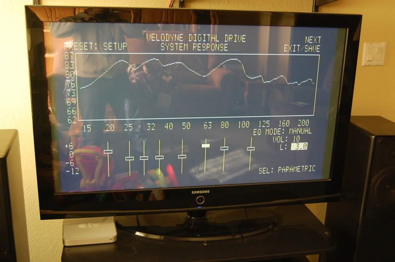

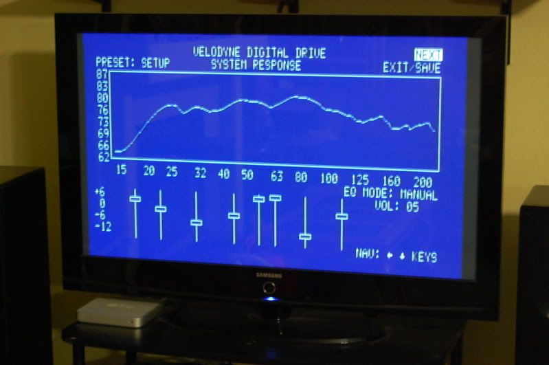

Got off work early today and spent some time Eq'ing the Beast. On the recommendation of Bill F. I turned it around to have the mouth of the horn facing the corner from about a foot away.
Before I turned it around you'll notice the dip around 63hz.
After facing the horn into the corner....lots of room gain appear as well!
EQ'd a bit.

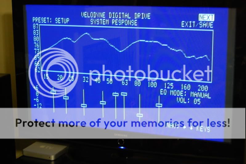

Ok, I did a quick test to see what the SMS-1 is doing to my LFE.
1st pic is through the EQ output:
2nd pic is bypassing the EQ using the "thru output"

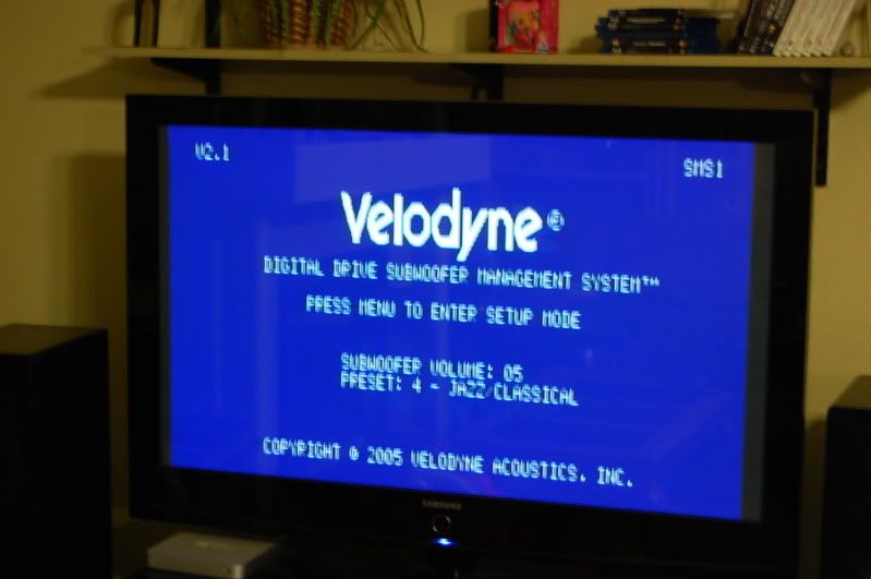

Proof I'm still using the old software
I have my wife looking for a RS232 cable at Wal-Mart right now so I can do the update.:D Cause I'm getting ROBBED of sweet precious BASS!
