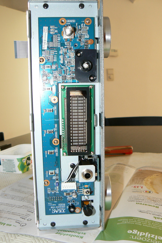

Hello Teac-enthousiasts. I read a lot about the 500 reference but not about the 600 (AG-H600 & PD-H600) reference duo (receiver+CD). Is this in a seperate section in this forum? I used the search function (looking glass) but without succes (can be my lack of knowledge of this forum). I have trouble with the volume knob, very sporadically "jumping" to maximum!!! This happened twice whit the first volume adjustment after switching on the unit (from stand by). Also, happening more often but not really a problem, is that it "jumps" steps f.e. from 45 to 50, up or down, or not reacting when turning the button fast.
My 1st question: how to take away the front panel of the amplifier? I opened the top cover. Removed the screws from the front (3 black at the top, 6 silver in the bottom) but no movement of the front cover possible... May be need more force but I first want to be sure if I'm doing right? Can someone tell me? Also, I wonder, if the rotating digital step counter is optical or mechanical. Is their anyhow a chance that "cleaning" might help?
2nd question: the DAB and Internet radio happen to stop playing after quite a time of playing, let's say after a couple of hours. FM does work when I switch to it at that moment! I suppose there is a problem of getting hot in the DAB/Internet tuning section? System has normal cooling; not in closed cabinet and on top of CD-player.

Question 1 partly solved... by myself. The side panels have to be removed first to reach 2 screws at each side. Ckeaning the volume "potmeter" however does not seem posible (look at the pictures). This is a so miniature thing and closed... It also has a push-function for adjusting balance and tone if desired. So I think replacement will be the only solution ... if seperate available as a spare part? Otherwise it will be the complete front pcb I'm afraid...
My 2nd question is still open...

2nd question (almost) solved too,... by myself. Apparantly no other rerence-600-owners here? If there are, can someone tell me how to find them please? (The looking glass did not give a result)
Concerning the DAB/Internet radio problem: I once undocked and redocked the small PCB and since then, it did not stop playing anymore, even after multiple hours of listening. I hope it was just a bad contact in the socket of that PCB.
I adressed my questions to the local "official" TEAC distributor for Belgium/The Netherlands, and they answered me I'd better replace the whole unit because repair cost would be to high...
I just did find out what type of encoders I need and ordered them locally at a couple of euro's!!!
