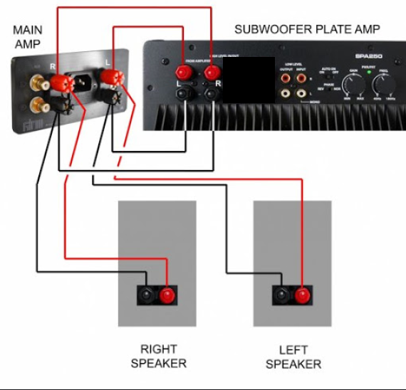

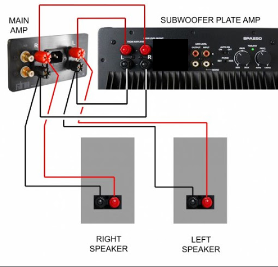

Regarding subwoofer, just connect it and you will be amazed again. Sorry for my last photo , i separate inputs wrong. See below the correct way:
For me the x-over whare I like it the most is 100 hz. works well with lower, but this is the way I like it.
So AMP > Y cable, one end to speaker one end into SUB. Same for the other channel. Use heavy gauge copper cable for Base(Subwoofer) ;) it make a difference.

I'm so sorry but I'm a little confused about wiring the sub now. I've attached a photo is it A or B and which way is better and why?
I hope it makes sense.

claman
claman
Hi Bill,
I draw a scheme for your help:
hope this helps.
Regards,
Claudiu

Only yesterday I'd connected the sub and it sound okay, but no way as good as before when I was using the single subwoofer cable on my Teac AVH500. I've connected the cable the way you described to me on the previous post... strange!
I have to argue with that. I had subwoofer previously connected to LFE output(that one RCA) and as per my years it does not beat the High Level connection. I am thinking that you might mixes the + with - on one of the channels and the bass cancel. I know cause I done that in the past. You have to carefully check it. Also pay attention to the PHASE on the subwoofer.
