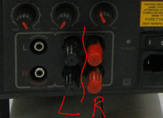

Hi Bill,
Your subwoofer support High level input: that means that you can split the cable that goes to your L speaker and channel it to LEFT IN and the right to RIGHT IN, and fed the Subwoofer input.
On the other hand the Subwoofer OUT from Receiver feed the RCA input (low level input)
I am using teac a-h500i + monitor audio gold 100 + Sony SA-WMS7 in the same configuration, and it's working PERFECT. I highly recommend HIGH level input compared to LOW Level input. The sound is much more detailed.
Listen to this:
You can search over the web details for the HIGH LEVEL INPUT. I am using it from forever, cause I am not fan of RECEIVERS. Quality compared to mono-blocks amplifiers(such as a-h500i) is way way lower.
Look at the specs of A-H500i compared to yours: http://www.audiorama.com.br/teac/reference500.htm#AG-H500
Hopes my lines will help you.

Hi Bill,
Hi Claudiu
Omg I did know that you could do that? So you double up the cable one side for the sub and other for speaker from the amplifier?
Yes. See it below( I advise to use solid cables routed to SUB: better for BASS)
High level input: https://www.the-home-cinema-guide.com/how-to-connect-a-subwoofer.html
I am using one for my computer and another one for my living room speakers. That is how much I like it.
Check my previous posts. I put pictures.

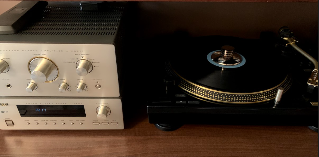

claman
claman
It really looks good and great price for this baby!
You saw those reviews ;) After I heard my first one, I bought a second one. Really enjoy them.
Well I am also in customization, and upgrades but that RIAA stage (just with capacitors changed, couple of $) it sounds fantastic to me. I have a Reloop RP7000 MKII Gold edition, and I can say it sound excellent.
if you have any questions related to my AMP upgrades please ask, I will be helping you with joy.
Also I have added a Bluetooth Adapter (bought from ebay with 30$ to play remotely)
Regards,
Claudiu M.
