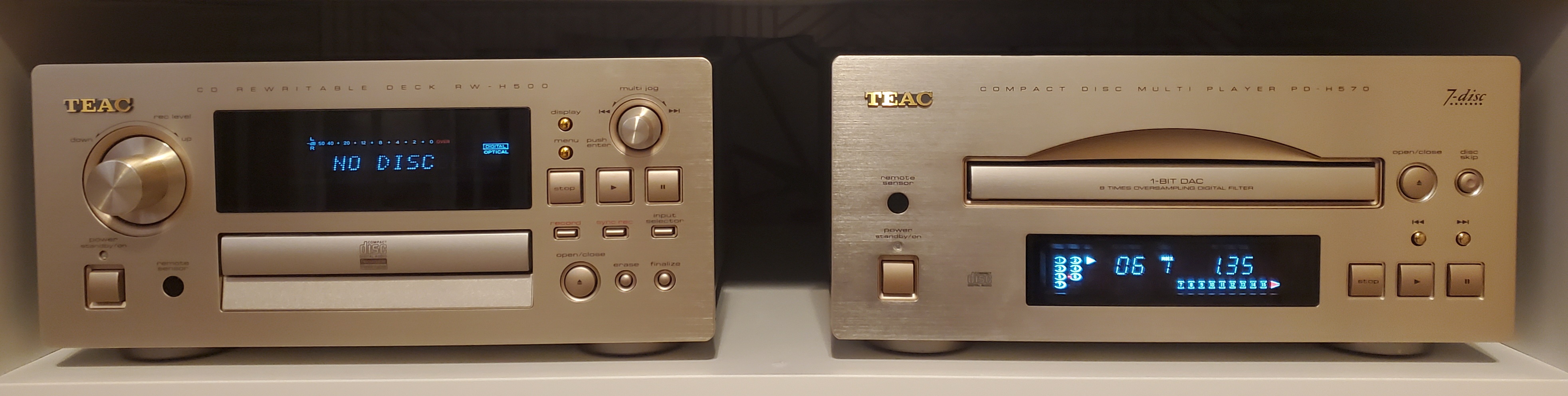

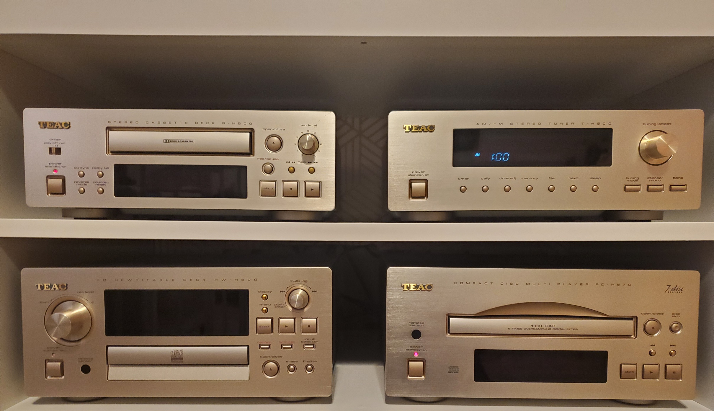

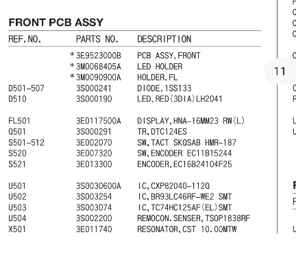

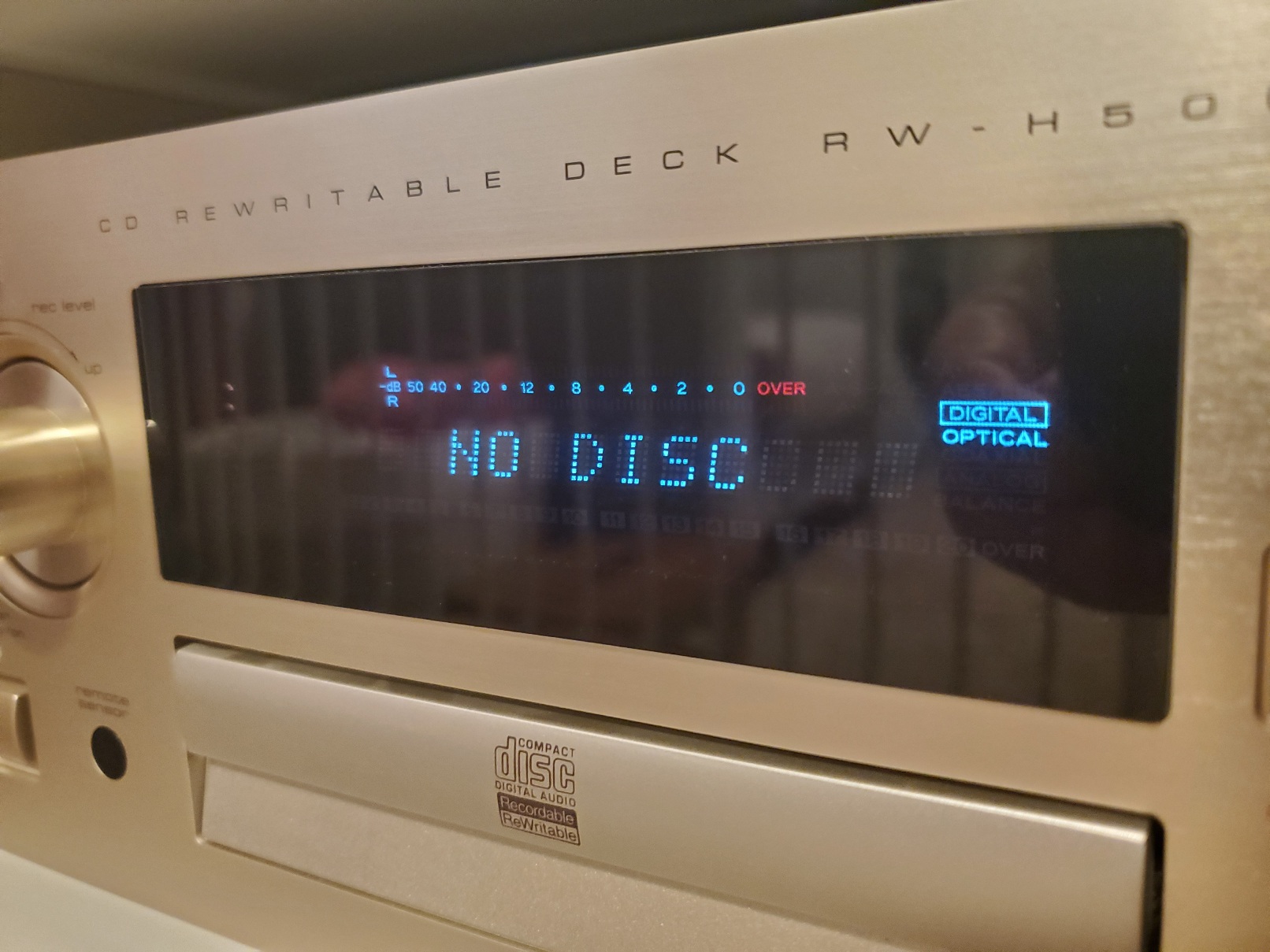

Does anyone have experience with the red LED standby light dimming? The standby light is much dimmer on my RW-H500 than my other components. Is this as easy as swapping the LED out?
