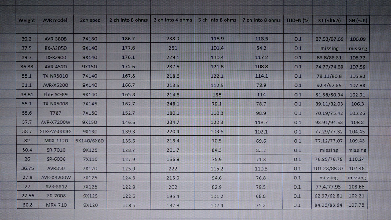

I copied the comparison table of bench test data (all by Sound and Vision) that I posted on another thread, you can see that the SR6006, the predecessor of your SR6011, was benched tested to 157W X2 at 0.1% THD, at 1% THD it was able to produce almost 200WX2.
http://www.soundandvision.com/content/marantz-sr6006-av-receiver-ht-labs-measures#zoZE7CwGCTLjp8Ku.97

The integrated amp you are thinking of buying will not give you more power than the SR6011 for 2 channel applications. In a "blind" test, I am quite sure most people will not be able to tell the difference between it and the SR6011 if the comparison test is setup properly. However, if you always wanted an integrated amp, I will say this again, go for it. I have all kinds of preamp, prepro and power amps and I like them all, though I cannot honestly tell people that one sounds better than the other.
My final recommendation is, go get your dream integrated amp but do not give up on the SR6011, it is a very capable mid range AVR that is very capable of improving your in room bass response. It has a very good DAC build in and can play just about anything in digital including DSD files.
