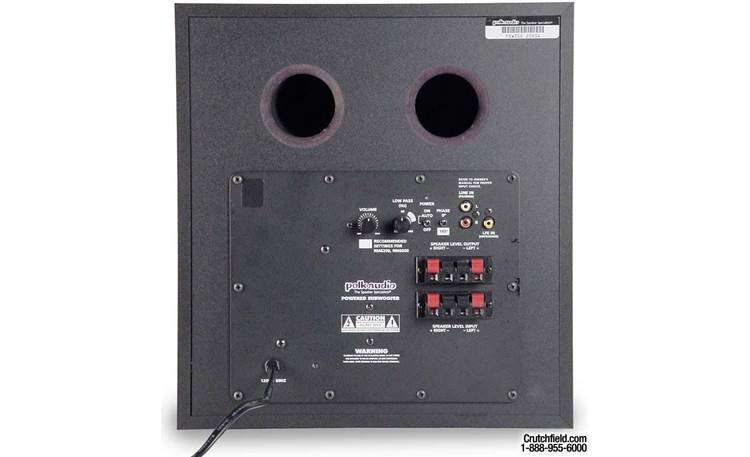

Thanks for the explanation about the Onkyo -- so this is the back of the Polk:
Are you saying I'd connect the cable from the receiver to one of those jacks to the LEFT of the main LFE input? And that would allow me to adjust the crossover?
What would happen if I plugged the cable into the main LFE input (as I do now with my HT setup) -- would the sub merely play along with the two speakers in this system without any kind of "control" so to speak?
As for the "occasionally selectable" comment regarding the stereo receiver...indeed, this model has no crossover control via its menu, at all. I can confirm that.
The 350 has decent output. That output isn't very good quality is all, so yes, the PB1000 is definitely a step up. Just don't want you to be disappointed if it doesn't bowl you over at first, which is not uncommon when people go to a more accurate sub. The PB1000 will likely extend deeper and be much cleaner in the whole range, but it may not appear to be massively "louder".
Yes, if you connect to the LFE, that signal is whatever the receiver is outputting, filtered or not. Uncontrolled as you noted.
