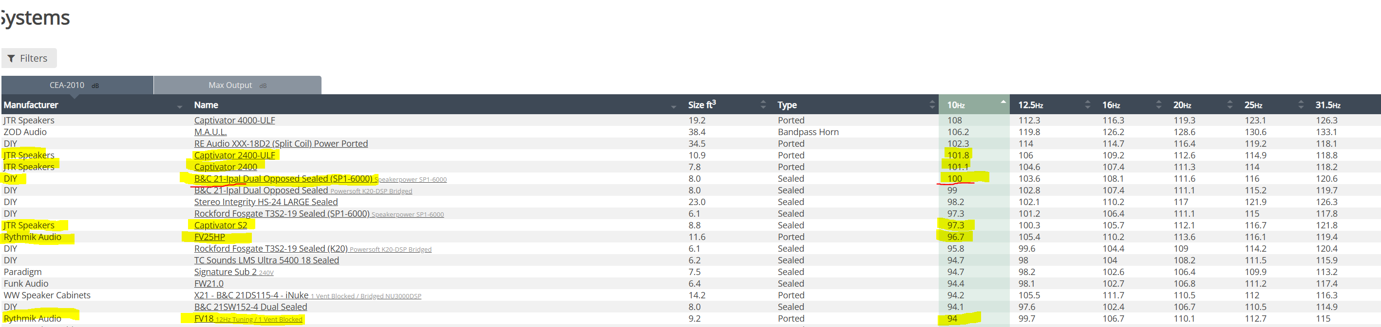

Correct me if I'm wrong, but if you compare the DIY dual opposed kit on data-bass which I believe uses identical drivers(21" ipal), less power(4000w vs 6000w) but a significantly larger cabinet(28%)wouldn't the PSA S42 Ipal actually perform better below 20hz given the 28% larger cabinet volume? The DIY kit does measure 3db higher JTR's older S2 below 20hz.
Would the larger cabinet(28%) or extra 2000w have more impact on sub 20hz ULF content?

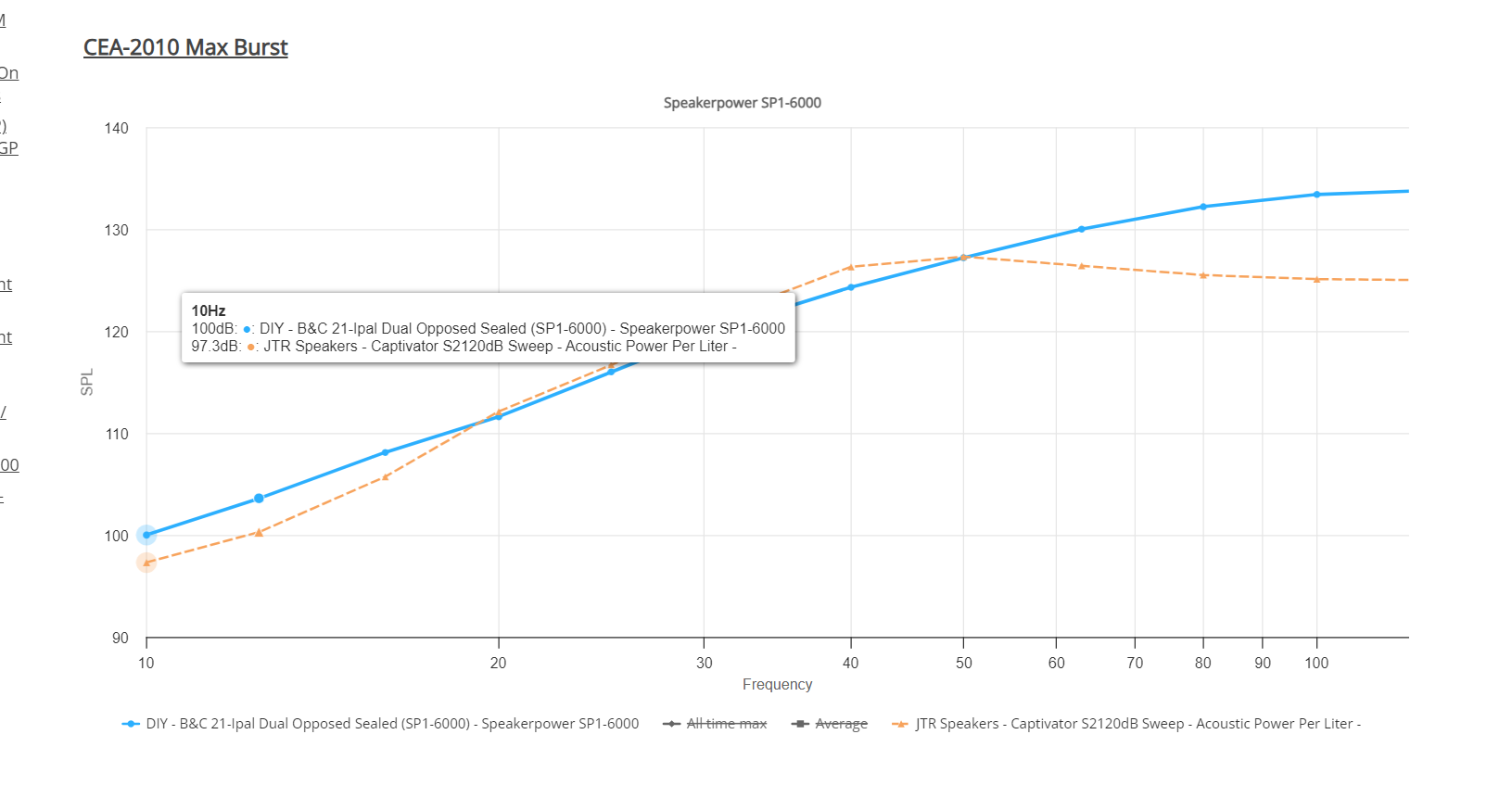

Just take a look at the DIY Dual opposing B&C 21-Ipal with a smaller enclosure VS the PSA offering. It bested the FV18, FV25hp, JTR S2 and only 1dB from the vented Cap 2400's. I don't know why anyone would claim PSA subs can't do ULF unless there's personal vendetta going on here. I'm sure the S42 Ipal is very comparable to the JTR RS2 that gets constant praise, assuming the newer JTR drivers gains 3db that would put it on par with the 21 Ipal below 20hz, and who know's what output PSA gains with the larger cabinet vs this DIY kit.

Which is why I posted the Dual opposed DIY 21" Ipal numbers from data-bass, FYI those drivers have 22mm Xmax, which are the same drivers PSA uses on their IPAL models. The regular 21's xmax is around 15mm or so.
There seems to be a group pushing the narrative that these drivers can't do ULF which is clearly incorrect. We have data on the 21" Ipals in a small/restrictive enclosure (worse case scenario) but many individuals seem to willfully ignore the data.
No the DIY isn't exactly the same as PSA's, IMO likely worse, but this isn't rocket science. We can draw some conclusions based on the data we have available for those drivers.

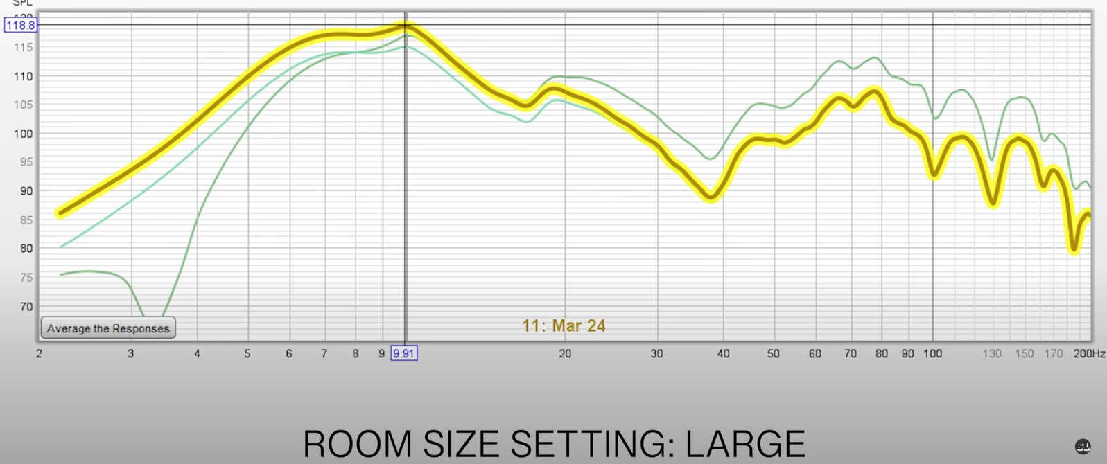

Shane measured 118+dB @ 10hz with the regular/weaker 21" driver with limited xmax, the better Ipal driver would likely give him an additional 3+ dB. It's a shame he didn't have duals to solve his massive 20dB nul at 40hz. I would imagine Dual S21 Ipals would get him close to 125dB @10hz / 120dB+ @ 6hz with a smooth response.

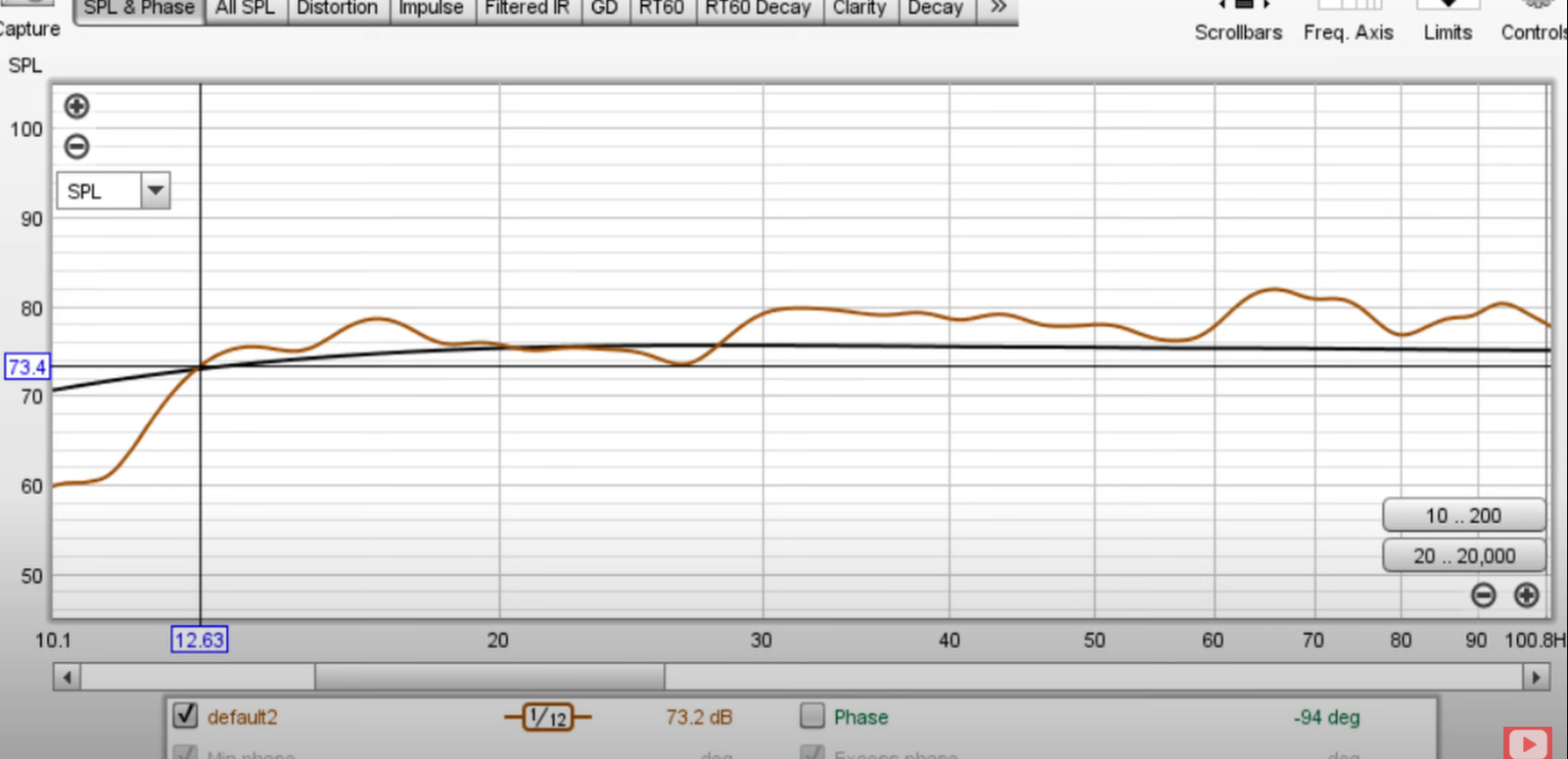

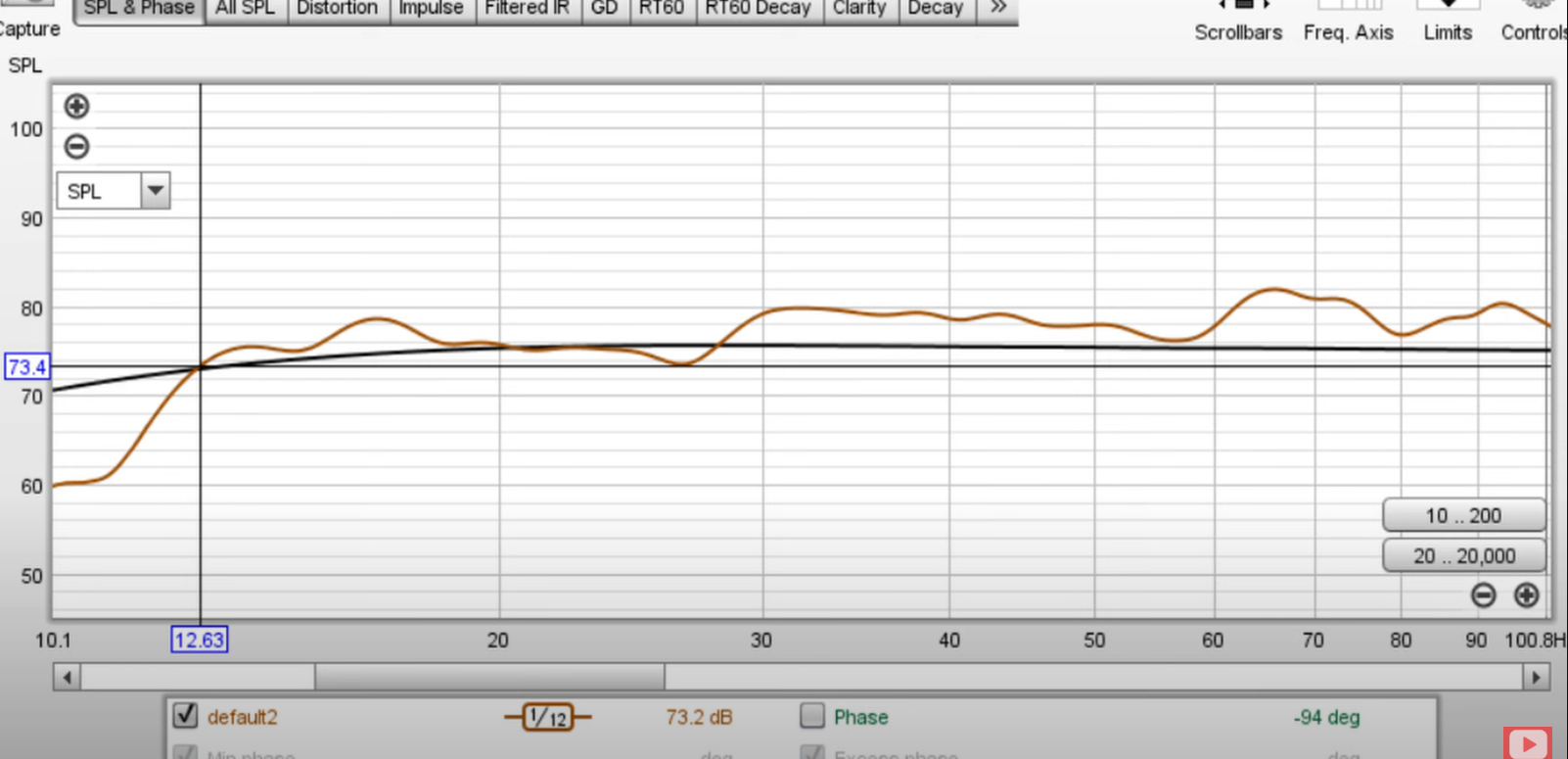

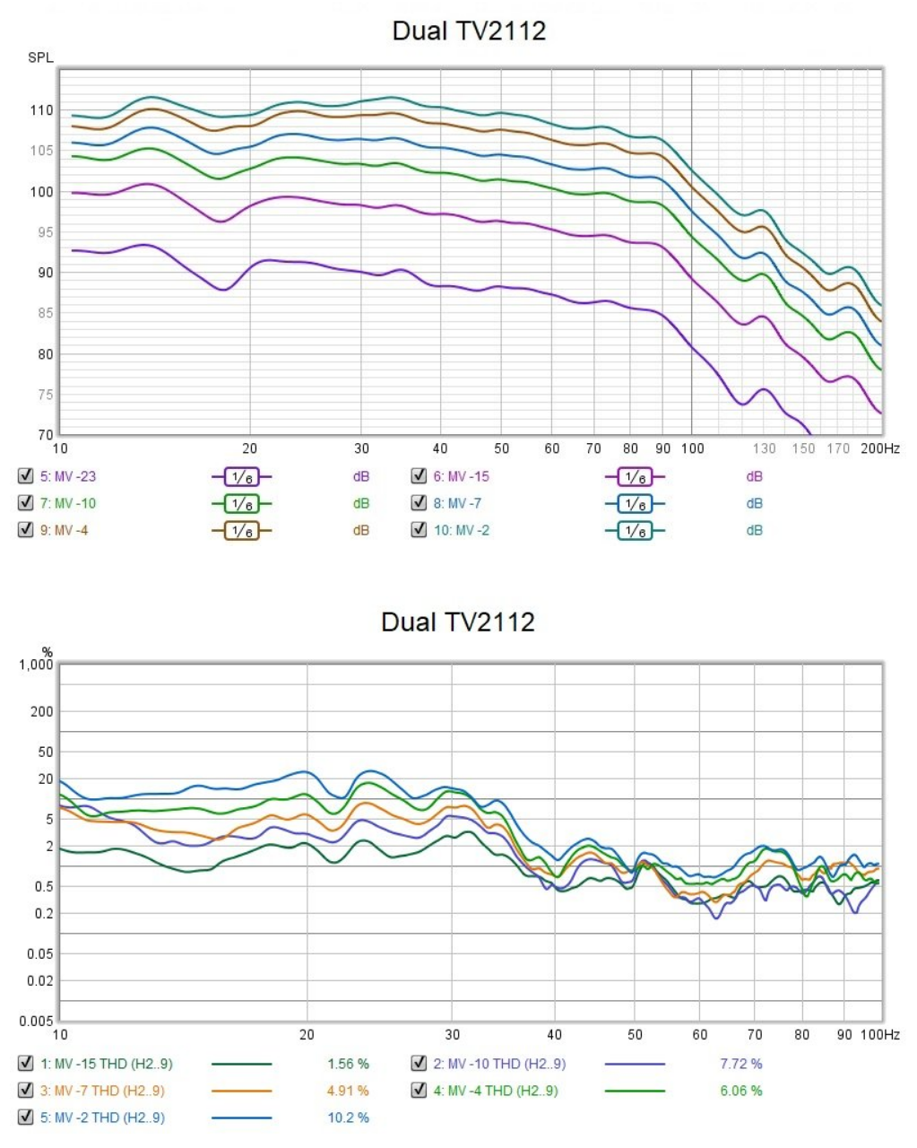

There's ton's of in-room measurements if you take the time to look for them, heres DUAL TV2112, again the lesser/weaker of PSA 21' drivers
Dual TV1512

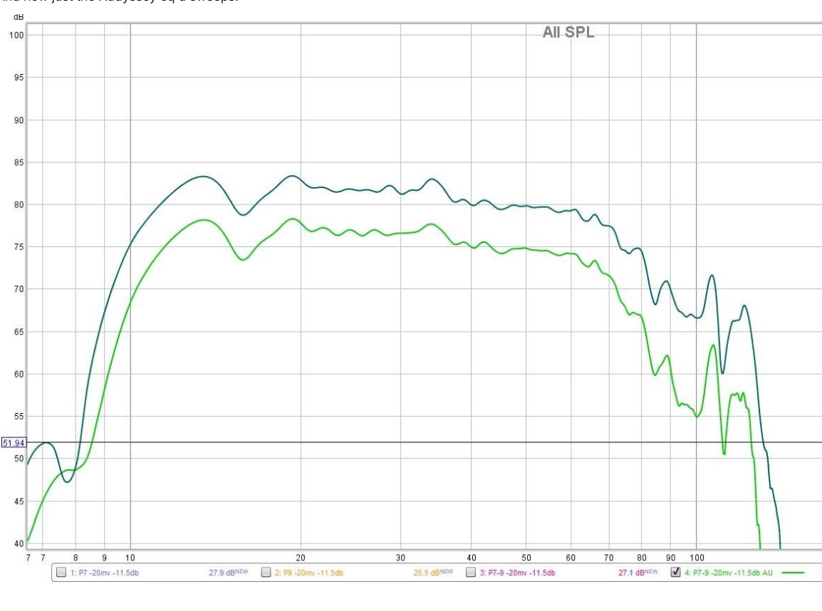

Another TV1512(different room/individual)
TV18F-M
EV1813(16hz port tune)
This took me less than 5 minutes to find, Is this CEA2010? no, but I no longer believe this narrative that Pro drivers can't do ULF. Are pro drivers ideal or the perfect solution? no, but that also doesn't mean they can't work for ULF either.
Dual TV1512

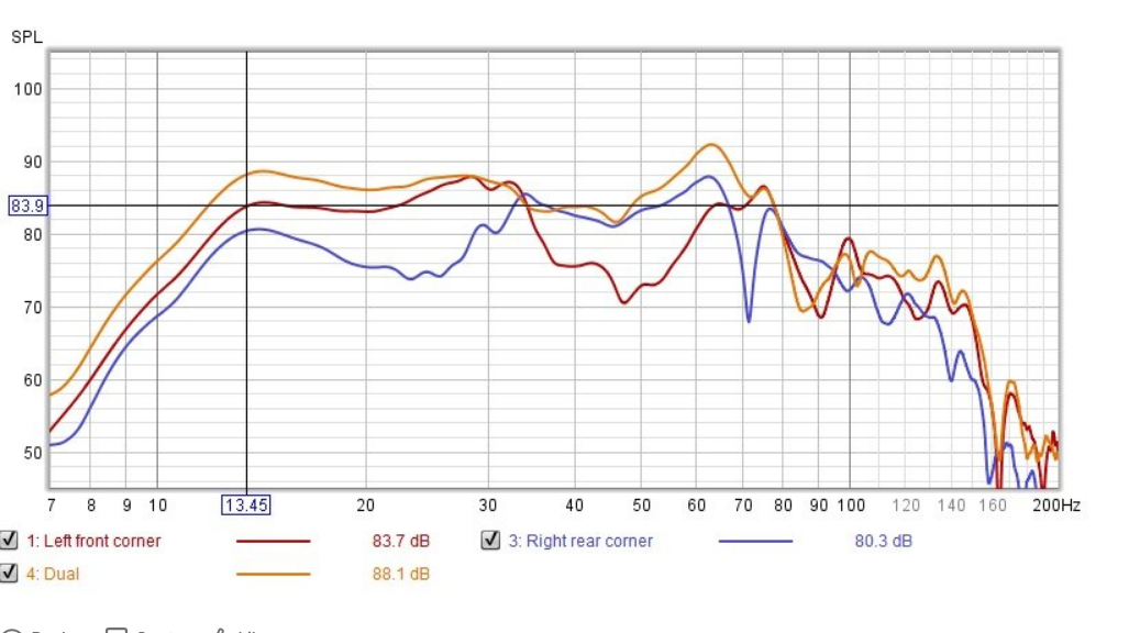

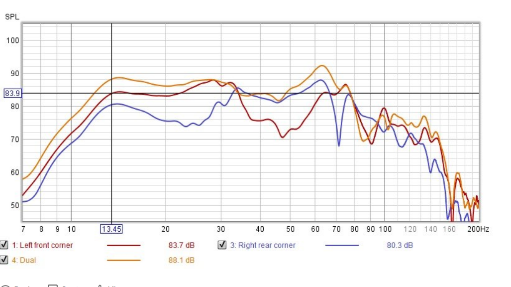

I shared my in-room measurements several months ago which were taken while using dual PSA TV2112Ms. I ended up liking them so much that I've since added two more. As I indicated then, I've had multiple brands of subs including Klipsch, Outlaw, Hsu, Neumann, Monolith, SVS, and PSA. I have absolutely no reason to be biased towards one brand or another beyond what sounds best in my space. I'm simply after the highest performing system for my dollar, in whatever form that takes.
I do agree that standardized ground plane testing of PSA's lineup would be awesome. I'll leave speculation as to why that has not happened (and may not happen) to others. All I know for certain is how they perform in my house, and that's...amazingly well.
I also agree that the pro audio drivers used in the majority of PSA's current offering are not purpose-built for ULF. That said, they do ULF significantly better than any other subs I've owned, reaching over 115dB at 10Hz with the two TV21s (on concrete, measured at the MLP 4 meters from the subs). With four TV21s, they sail to over 120dB at 10Hz without producing any audible distortion, compression, or mechanical-type noises whatsoever...well, all of the violent shaking of the house notwithstanding.

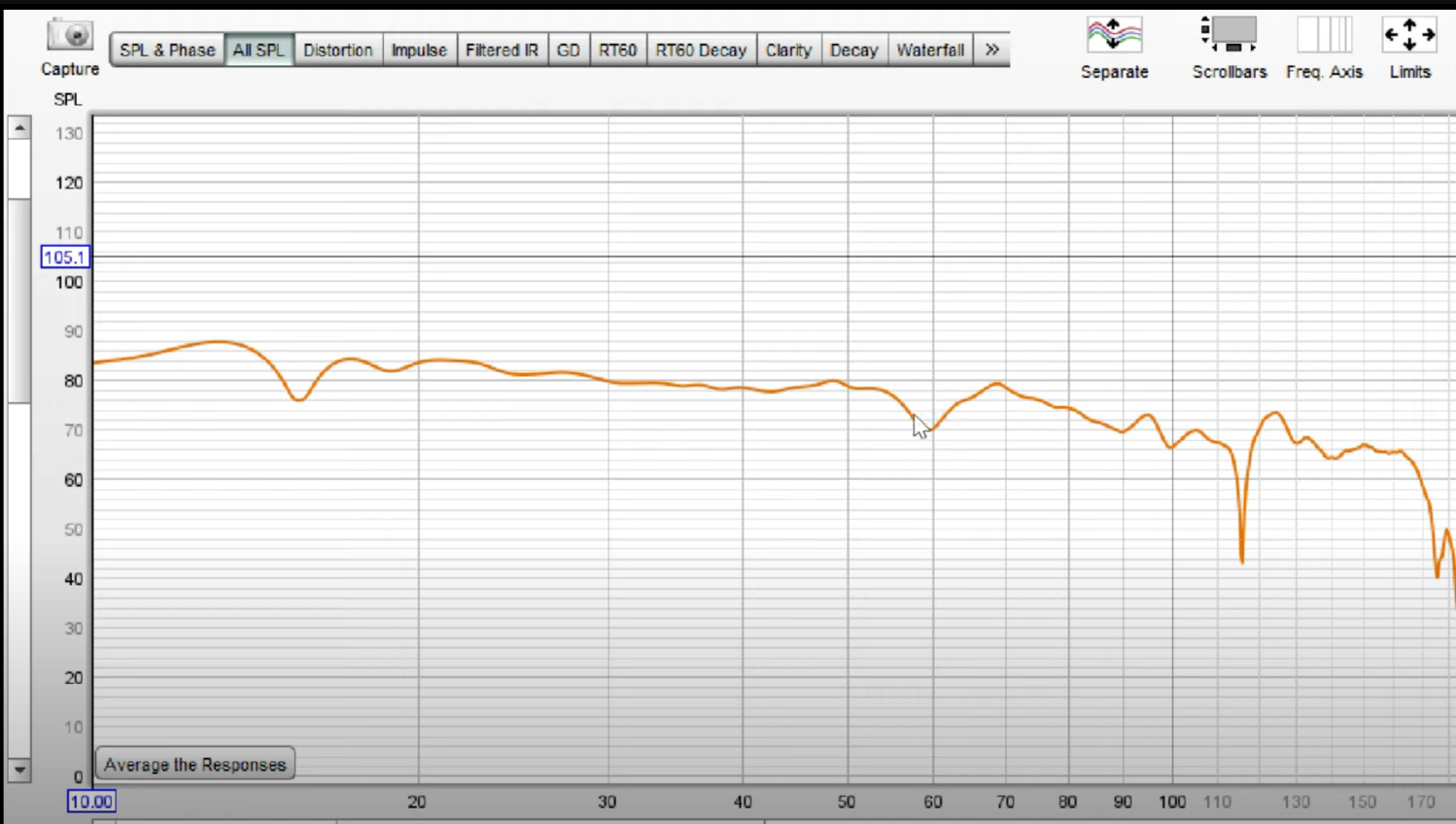

Here's a frequency sweep of the four subs at a somewhat spirited but still quite comfortable volume (not even remotely close to max), taken at the MLP, and the associated distortion measurements from REW:
Anyway, these subs are built for strong mid-bass punch, which they deliver in spades. But neither that nor their excellent ULF performance are my favorite aspect. Their performance with music reproduction at practically all volumes is their best feature to me. I've never had subs integrate with my main speakers so smoothly. It truly sounds like I'm listening to a completely integrated full-range system. They offer a dynamic range that shines from lower volumes all the way up to rattling my irritated wife three floors distant.
