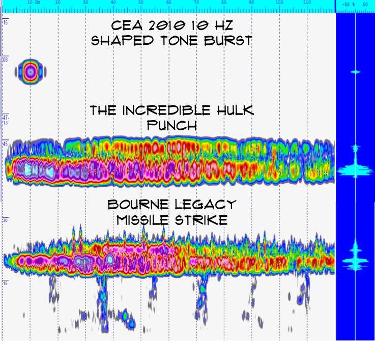

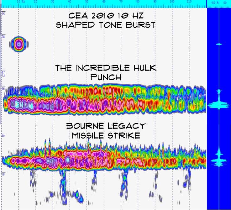

I forget where I saw it... might've been in the RedFive Devastator Index? on AVS... but most of the content people are chasing in movies like John Wick et al is around 30Hz. But with gobs of power. The kind of Power no Full Range Tower can deliver.
This is what the Devastators and other Subs with Pro Drivers do with great aplomb. Try pushing that too low, on the other hand... ;)
Red Five (John) on AVS (not GSG John (aka LTD02)) has commented about this to great length. His Devastator designs have pushed the bounds, but every time he pushes one low, you can see the models and how their efficiency drops like a rock. Even the NSW doesn't want to be pushed below 20Hz without taking a serious hit to it's mid-bass efficiency. Tune that same driver to around 22Hz, and you can see some amazing and Devastating output above.
Not everything is infrasonic. It doesn't need to be. Even though LFE can be LOW doesn't mean LFE is only LOW. I tend to agree with those that think the Live, Die, Repeat 10Hz square wave was an accident. Too many devices just can't do it, and I don't think it was ever meant to be that way as most Cinema Subs are Pro Subs that aren't designed for that type of output.
Chasing infrasonics is expensive. It takes Space, Power, and Technology to all come together at once. These convergences are rare. ;)

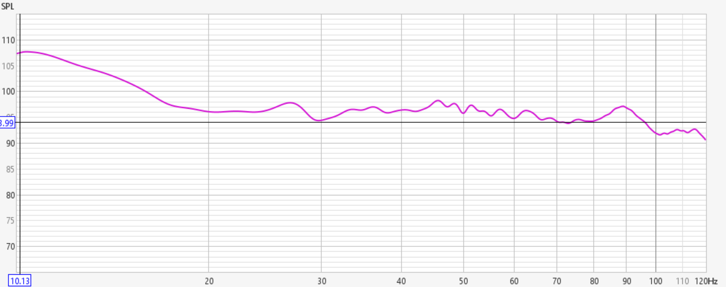

I bought a few subs from HSU, Rythmik and PSA.
I used my Umik-1 and REW and measured. The PSA sub provided the best ULF and most output with compression sweeps IN MY ROOM.
I watched a bunch of my favorite movies as well.
I kept the PSA and sent the other two back.
Rythmik and HSU make amazing subs, but the PSA was a better value IMO and had more output and ULF IN MY ROOM.
Lol @ CEA 2010 data
Do you buy a car based on Specs? I don't. I test drive a car before i buy it... plenty of PSA REW data posted over on AVS, Reddit, discord and Facebook.

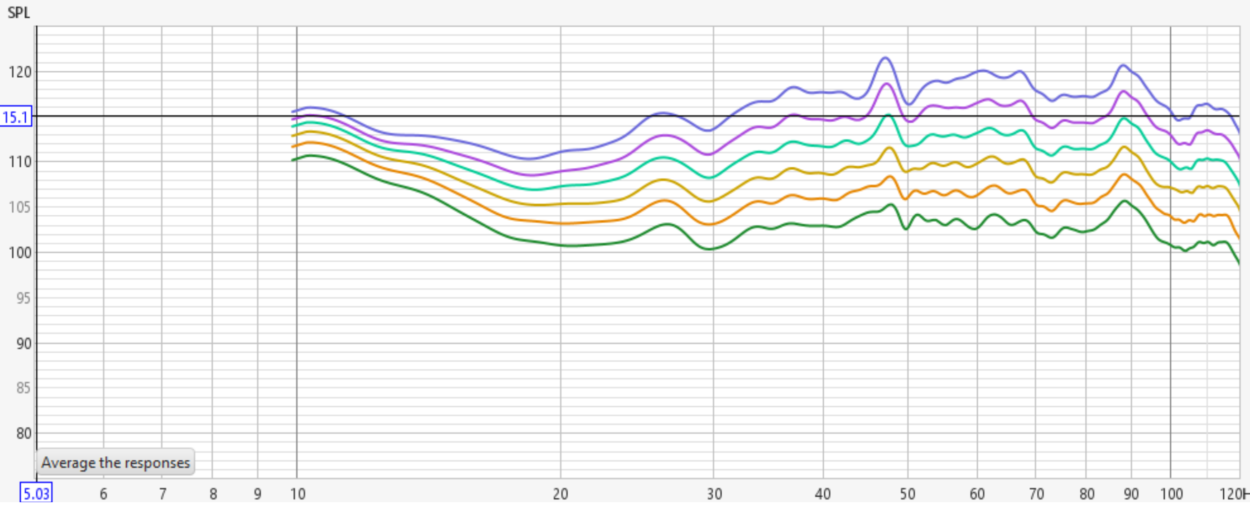

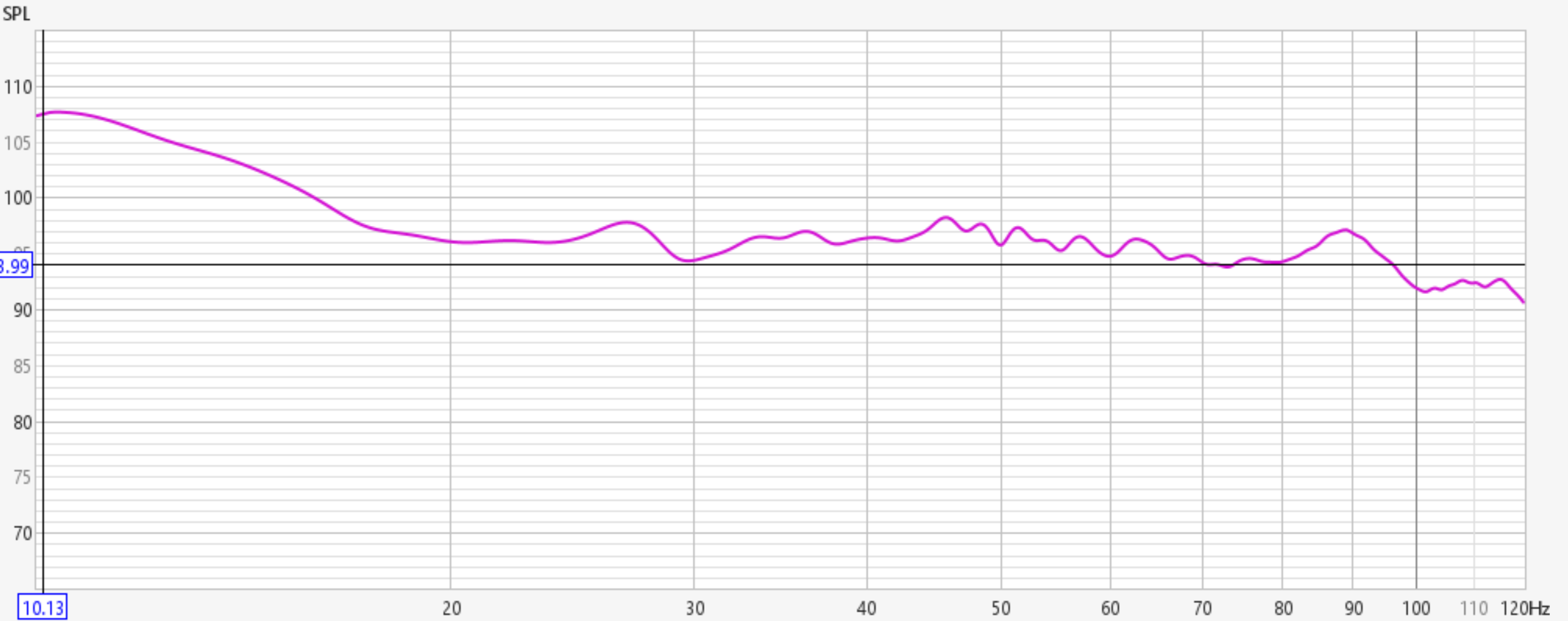

Lol @ CEA 2010 data
Do you buy a car based on Specs? I don't. I test drive a car before i buy it... plenty of PSA REW data posted over on AVS, Reddit, discord and Facebook. View attachment 59313
That's a comparison of the measurements you took with the various subs to prove your point?
