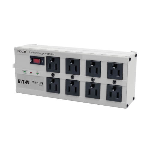

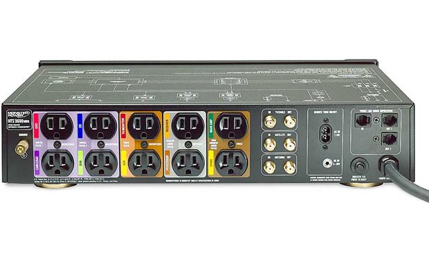

I have had a 3600J Surge protector since 2005 for TV, Denon AV, DirectTV, Modem, Subwoofer, etc., with numerous power interruptions. Some with complete down time for an hour or so. My equipment is working just fine. I have 3 other surge protectors, with 1870j ratings in the house, for TV's with boxes and one laptop, and they have been perfect since 2005. Having the right surge protectors have worked for me and no need for an over kill, in my applications. Knock yourselves out folks!
L
lp85253
a $30 surge protector is likely to help with anything that a "power conditioner" would... pc's *for sure* don't make anything sound better ...

2775 joule rating
That's not even as much as many surge protectors.
Well damn man I bought this a while ago, way way before any home theater ever came to mind, think originally it’s 80. Bought it for 29, always used to buy poop when it’s more than 50% off.
Nearly 5000 joules
