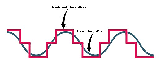

Pure sine UPS units are typically a bit more expensive, cheaper units produce simulated sine, Good explanation here:
Typically only relevant for computer power supplies, A/V stuff is usually ok with simulated sine.

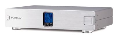

I run my Receiver, CD Player, Subwoofers, and Internet on the Belkin

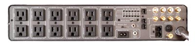

I also have a Monster Power HTS 3500 mkll
I run my TV, PlayStation, and Xbox on that

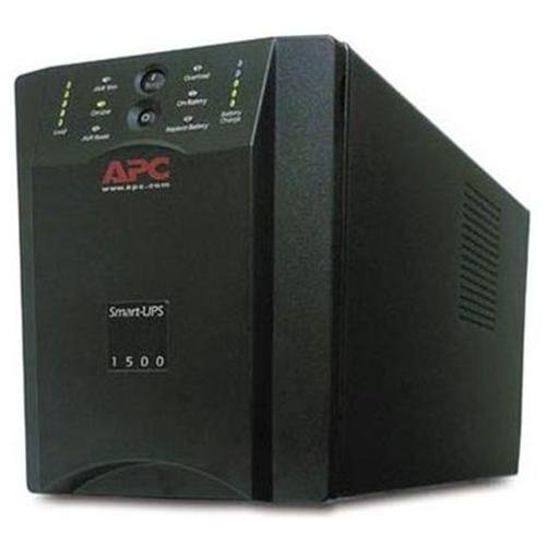

I got this one recently, did I choose wisely?
I don’t think that’s pure sine wave, it’s still simulated. I will confirm for sure, but that’s why I didn’t like APC. If I remember correctly their pure sine wave was much more expensive than Cyberpower
