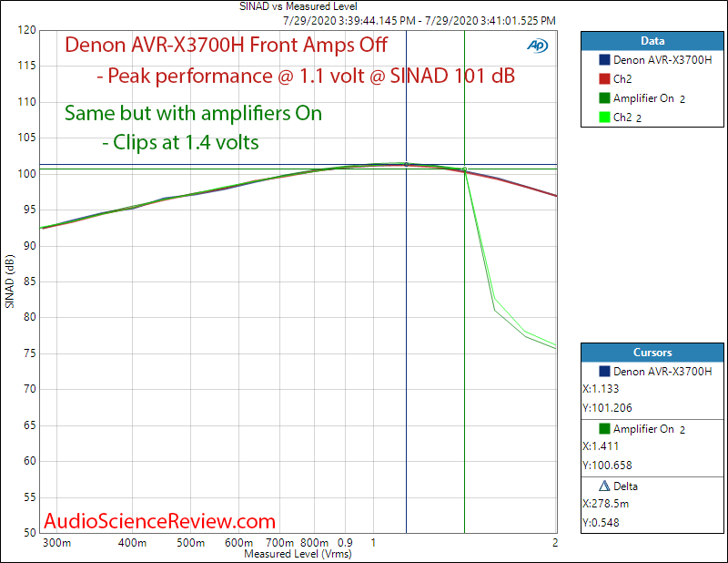

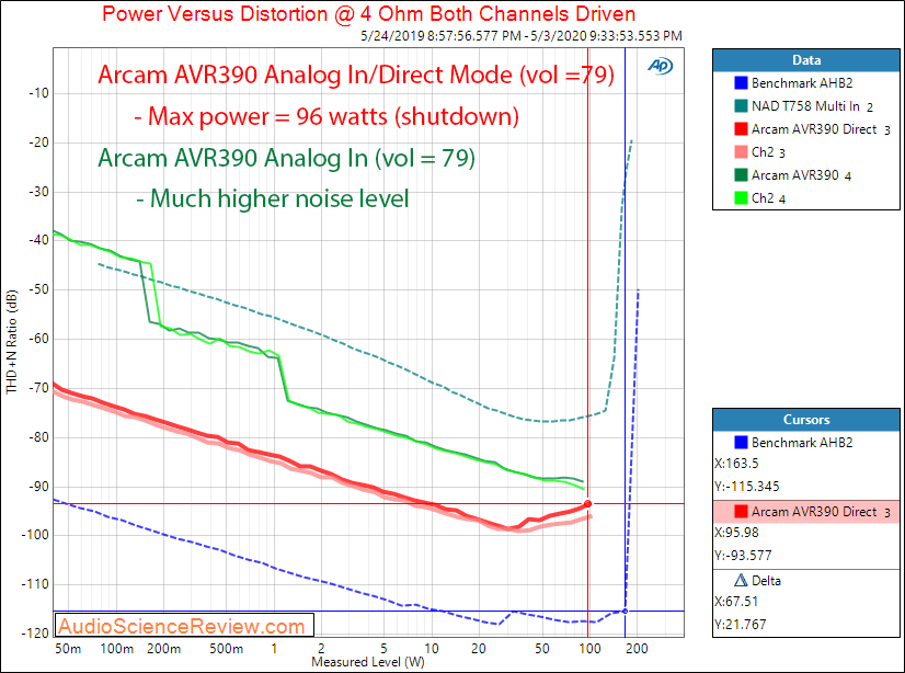

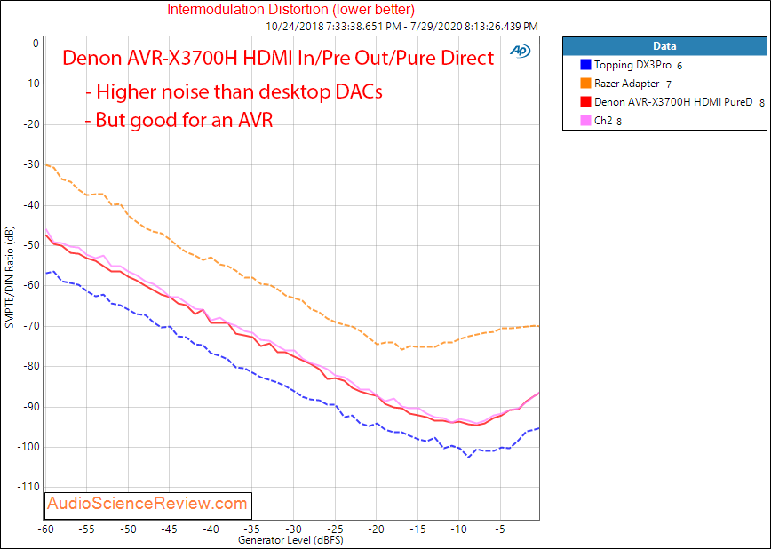

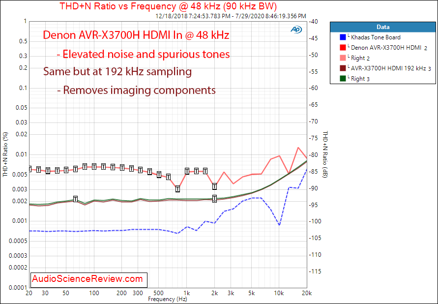

That would be great, but I would like to know which one, so I can buy one lol..

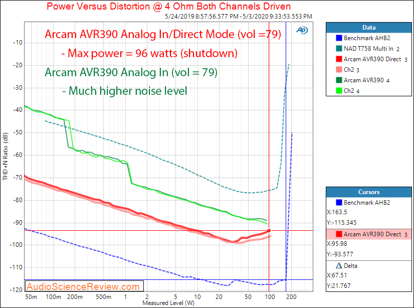

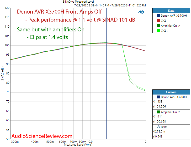

Be sure to look for graphs (pasted from Audiosciencereview.com) like the following:
I don't want something like this, though if it cost $200 I would be okay with it.;)
Here was a cheap Yamaha AVR with THD+N of 0.02% and SNR was about 111dBA:
