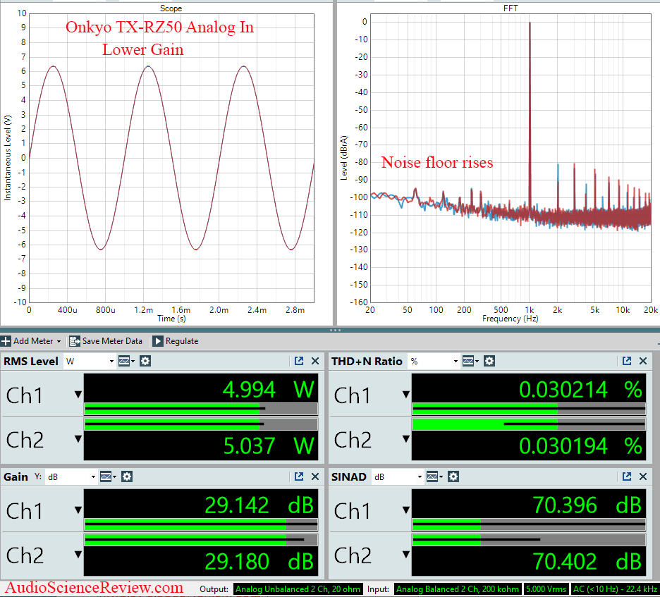

If the nannies were called in at 35 W into 4 ohms in that test, something wasn't right. Poor design generally, or something else that scared them? You are the right who emphasized the important of current capacity, if I remember right.
Regardless, take a look of the 5 W distortions, okay 70 dB is not audible to most, but it just doesn't look good when it's 15 to almost 20 dB higher than Denon and Marantz's.
THD+N of 0.03%/ SINAD 70dB would be like a $200 AVR to me. :D
That would be great, but I would like to know which one, so I can buy one lol..
Be sure to look for graphs (pasted from Audiosciencereview.com) like the following:
I don't want something like this, though if it cost $200 I would be okay with it.;)
