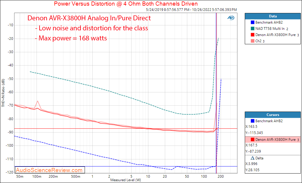

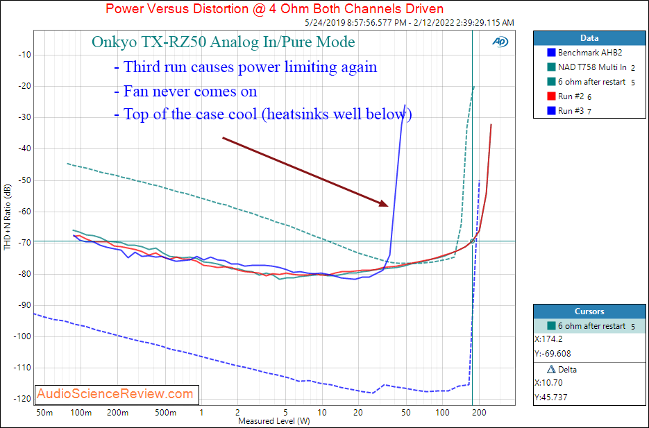

That site is good for quick comparison to come up with a short list, but if you are careful enough to come here and ask questions before you made your final decision, you should actually compare manufacturers product info sheets and owner's manuals.
It scored the Onkyo higher on the power amp section because apparently they simply compare their advertised specs without looking at the output power a the specified conditions.
For those two you can actually compare their objective measurements:
Note that the RZ-50 did much worse than the Denon with 4 ohm test resistor load. It's pream/dac section seemed fine.
Onkyo TX-RZ50 Review (Home Theater AVR) | Audio Science Review (ASR) Forum
Onkyo:
Denon:
Note: the test clearly identified that the RZ50 has an overly sensitive Amp protection circuit... AKA "Nanny Circuit"
In actual use, I have never heard anyone reporting the activation of the protection on their AVR.
I have the less powerful baby brother AVR, and when connected to my "nominally" 4 ohm speakers, it did not sound great (it needed a lot more oomp, which has been provided by my external amps... not surprising given my speakers go down to 1.6ohm) - but at no stage did the protective "Nanny Circuit" kick in.
So yeah - the RZ50 failed this test, on a lab test bench - however I would refer to its performance before the nanny circuit kicked in, for a real life indication of capabilities, as I have never encountered anyone who has had the nanny circuit activate in real life - even with torture level low impedance speakers like mine!

If the nannies were called in at 35 W into 4 ohms in that test, something wasn't right. Poor design generally, or something else that scared them? You are the right who emphasized the important of current capacity, if I remember right.
Regardless, take a look of the 5 W distortions, okay 70 dB is not audible to most, but it just doesn't look good when it's 15 to almost 20 dB higher than Denon and Marantz's.
0.001% THD+N is a SINAD of -100 dB, which if the new Denons had that people would not complain as it would be a better performance by ca 3 dB for the Denon AVR 3700 (AKM version). The 3800 has a SINAD in the ASR review of -87.3 dB with the 3700 (AKM) of -97.6 dB.
