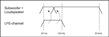

I will try and touch a couple things.
So yes. Hz is frequency and means cycles per second. Europeans actually use CPC often to describe it. When peng wrote manufacturers -30 he actually meant -3. The -3db point is the point at which the speakers low end output is naturally reduced by 3 decibels due to its natural roll off point. Meaning it really can’t play any lower than that. So a -3db of 70hz means that it won’t safely play much lower than that.
Here’s a visual representation to help illustrate how the XO and LFE relationship works.
So when you’re “supposed” to set a XO point now you can see why. When you use 80hz for example, you’re sending bass content below that point to the subwoofer. That’s redirected bass and NOT related to the .1 LFE channel. Basically you’re shifting the balance between what the subwoofer plays and the speaker/s play. I kind of visualize a sliding scale.
