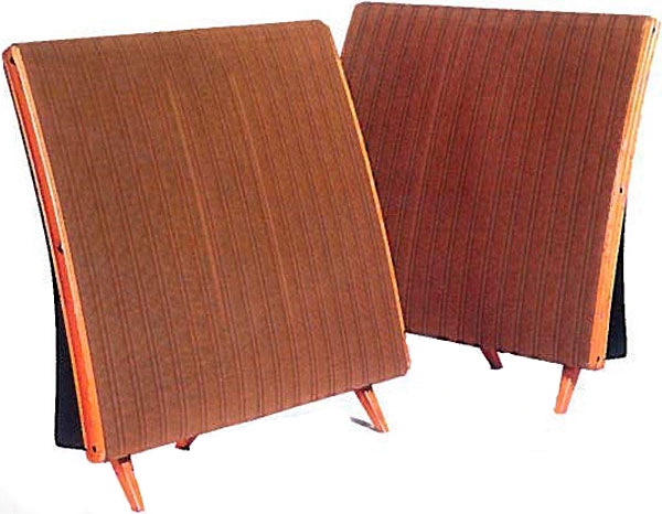

My audio system is a Yamaha 100W Integrated Amp (about 8 yrs old w/Pure Direct and CD/DVD Direct Buttons which bypass the bass/treble/loudness for "Pure" sound), Carver preamp, JBL L110 speakers.
I love the L110s because they have VERY realistic vocals/highs, good midrange but the bass is not nearly as defined as I would like.
So people in another forum suggested I get a sub and connect it to speaker level inputs in my Integrated Amp (in the main speaker outputs "A"). Guys in the other forum recommended the Monoprice sub.
(I know it sounds weird that I have an Integrated Amp AND a Preamp. I'm not sure why I bought the Preamp - I don't know much about audio even though I'm an engineer. But I love the Preamp because it has a Midrange control which comes in VERY handy.)
I bought a Monoprice 400W 12" sub (downfiring) and followed instructions to set it up. I have the volume of the sub turned to a little more than halfway and its low pass filter set to 60HZ. And sub is a few feet from the wall in-between the L110s in a room that is about 13 wide x 18 long x 7.5 high. The L110s are several feet from the wall and on stands about 1 ft above the floor.
The Monoprice sub is not well-defined at all, doesn't feel like it makes much of an improvement in the music and sounds very muddy.
I compared many subs online (and read many reviews) and the only subs I could really afford were the Monoprice or Klipsch or maybe a Velodyne sub (I'm on a VERY tight budget because I'm on disability.) I got the Monoprice sub for $250 new.
I listen to a lot of hard rock like Cream, Judas Priest, Sabbath, Robin Trower, Joe Satriani, ZZ Top, The Doors, Van Halen, Santana, Hendrix, etc. and the JBLs are hard-hitting, imo.
I've owned a lot of floorstanding speakers including JBL L100 (which were not nearly as good as L110), JBL L150 ($2000, which have the same dome tweeters as the L110), several Infinity models (which were too harsh), B&W (weak bass), basic Klipsch speakers, ADS, Polk and the L110 are the most realistic and best-sounding speakers I've had.
My PC Logitech 2.1 speakers have a 8" sub that is VERY well-defined, loud and sounds perfect (believe it or not) and the 2.1 speakers are tucked away on the very bottom shelf of my desk..The 2.1 bass sounds much better than my L110 bass!
What should I do to improve the bass in my system?
Someone in the other forum suggested a crossover w/sub ouptut but I don't know if I need that or not. ( https://www.parts-express.com/Rolls...ni-Crossover-w-Sub-Output-245-1184?quantity=1)
Shoud I look for a different sub? Did I connect the sub correctly to my Yamaha amp? What are my choices at this point? I'm stumped...

Your system is irregular. That preamp to integrated makes no sense at all.
Your have no proper bass management. So you are adding a sub to full range speakers. So in effect you have a half section crossover and not a full section crossover. Sometimes this can work well, but sometimes it does not. In your case I suspect it does not.
So you are going to need a unit that has bass management to solve this I suspect, so that you can cut the low frequencies to the JBL and send them all to the sub. So you need a proper 0.1 channel I suspect.
I am actually familiar with those speakers, they used to be quite common. My opinion of them is that they are awful speakers. The bass sounded miss tuned for a start, and I suspect that is the root cause of the problem you are having now.
The mid range driver of those speakers is pretty typical of the "Squarker" designs.
Those speakers come from an era when American speakers were considered "amateur hour" designs. I think that is being generous to them.
Honestly I think your first step should be speaker shopping.

I think the midrange on JBL110 is just fine, by far the best I've heard from any speaker I've owned!
And what speaker should I look at? I've tried tons of speakers with no luck. I can't afford expensive speakers! (I made a mistake by buying $2000 JBL L150 speakers and had to sell them because of my debt.)
Will that $100 crossover w/sub output which I posted a link to make a difference at all?
