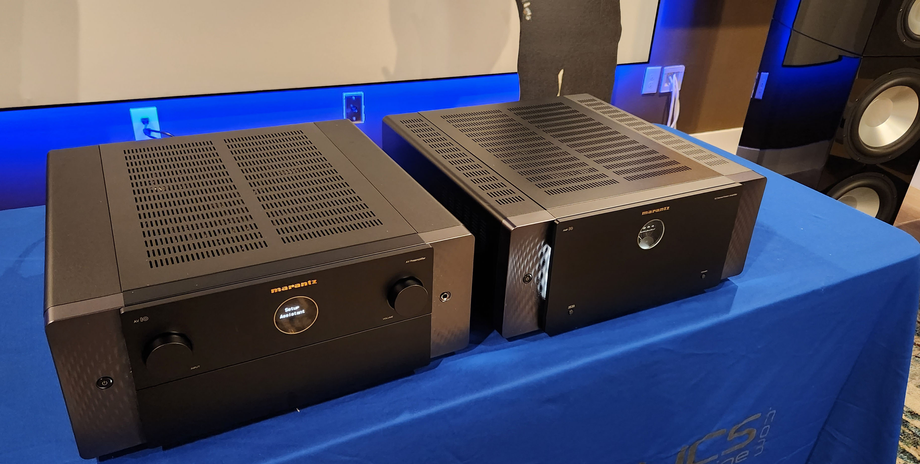

From Masimo Video.
AV10: SINAD 106dB
AMP10: SINAD 95dB

Thanks for posting that. I was going to say that I think Gene has watched the video now but in glancing at the SU measurements I noticed that the SINAD was 106dB with HDMI in....just as I think Gene tested. Hard to believe using DAC filter 2 would make up the other 10dB, but to fair, the feature is literally described as being useful for "benchtests." :)
Either way, I'm sure Gene will figure it out. This thing is super clean, loaded with features not see anywhere at its price point and its gorgeous in my room. It is so cool to be seeing some very nice AV gear coming out again after the AV-zombie-apocalypse (COVID).
Yeah. As clean and inaudible as 96dB SINAD is, 106dB seems like a “huge” difference in measurement. So I am sure Gene and Masimo will get to the bottom of this. :D

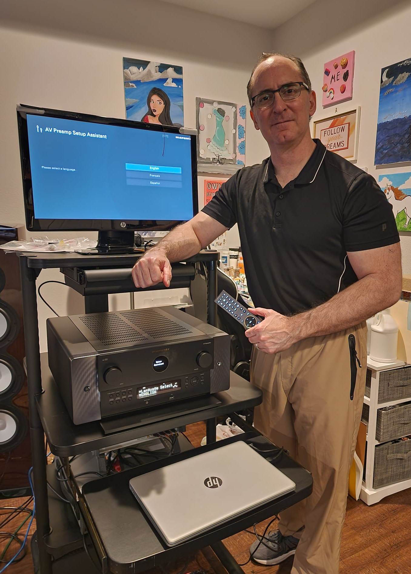

It's not surprising that the Marantz AV 10 15.4CH 8K AV Processor produced excellent bench test results. This $7K processor has bass management features no other competitor has in this price class such as LFE Bass Routing and Bass Re-distribution. We thoroughly test these features to show you how they work. We also thoroughly explain the measurement results and how they can relate to real world experiences for this product.
View attachment 61648View attachment 61649
With plenty of clean output drive and the ability to run 4 independent subs with so much flexibility of how you configure your bass, the AV 10 is a class leader. Could it be too uncomfortably close in performance to the uber expensive Storm Audio and Trinnov alternatives?

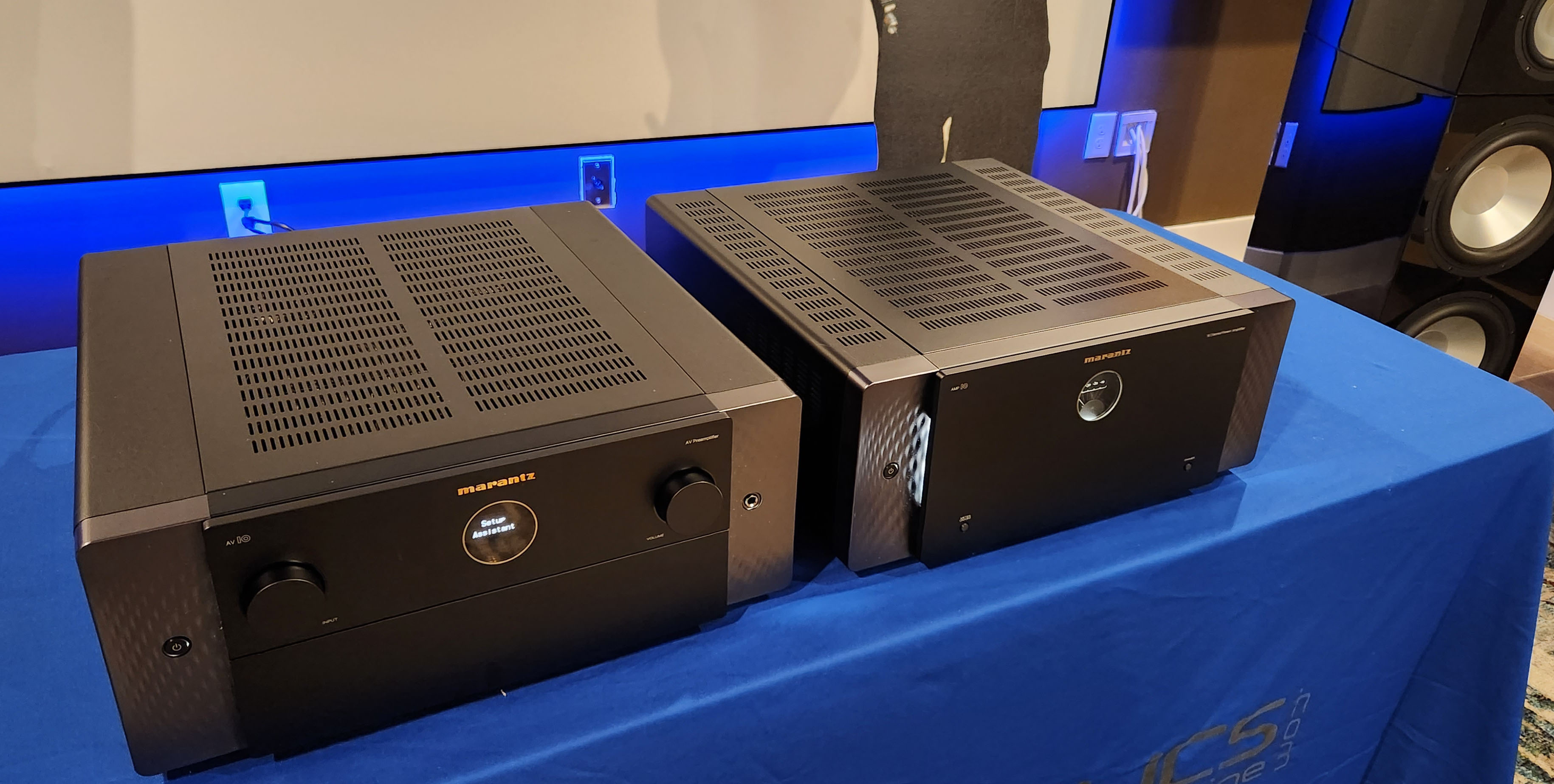

From Masimo Video.
AV10: SINAD 106dB
AMP10: SINAD 95dB
It will hit rated power with 1 or up to 7CH driven as per my bench tests. It's a very interesting amp. Does great ACD but has no headroom above rated power. I will be discussing this in my test report.
