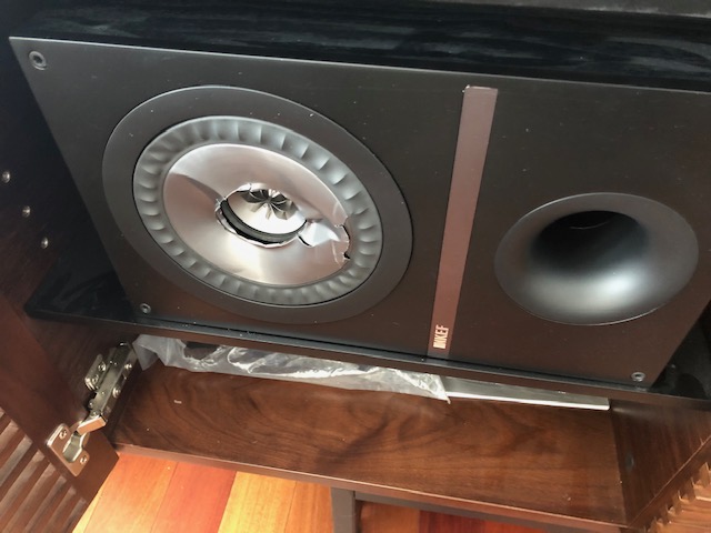

A friend told me that he thought he may have blown his speaker. This is what I found under the grill. Never seen this before!
Pioneer SC 67 running one pair of KEF Q150. Not looking for advice, just wanted to share.

Looks like Q100s, not Q150s.
I've seen a few (maybe 2 or 3) pics online before of people doing that to their Q100s or Q300s when overdriving the midwoofer.

Wow never saw anything like that before without some actual physical damage to the driver.

Are you sure your friend didn’t blow them by stabbing them with a knife instead? I’ve never seen a cone explode like that. Usually a “blown” woofer means the voice coil has been fried or separated from the rest of the woofer :p

Do a Google image search and you'll see a couple of other KEFs with very similar damage. When that thin aluminum cone exceeds its 'safe' range of motion, it bends and cracks.

These are not typical speaker elements as they have basicly two elements in one.
I would assume he has blasted those speakers really loud and possibly over driven amp to cause massive clipping.

Looks like he bought the wrong tool for the job. Must have been playing them very loud and possibly full range to boot (or crossed over lower than a 5" speaker should ever be).

Doesn't surprise me. Even my LS50 which I assume have better drivers couldn't take a clean full range signal at anything approaching ~90dB in a small room. Thap, thap, thap.

LOL. So that's what they mean by "sound breaking up" at the edge of a cone!
For aluminum to fracture like that means that it is either a special alloy or was heated treated for stiffness (or both).

If I saw that picture in isolation and not with the background the OP provided I would've never thought that extensive damage like that could have been caused by being overdriven. It actually looks like it incurred extreme physical damage, like getting kicked with a boot :oops:.
