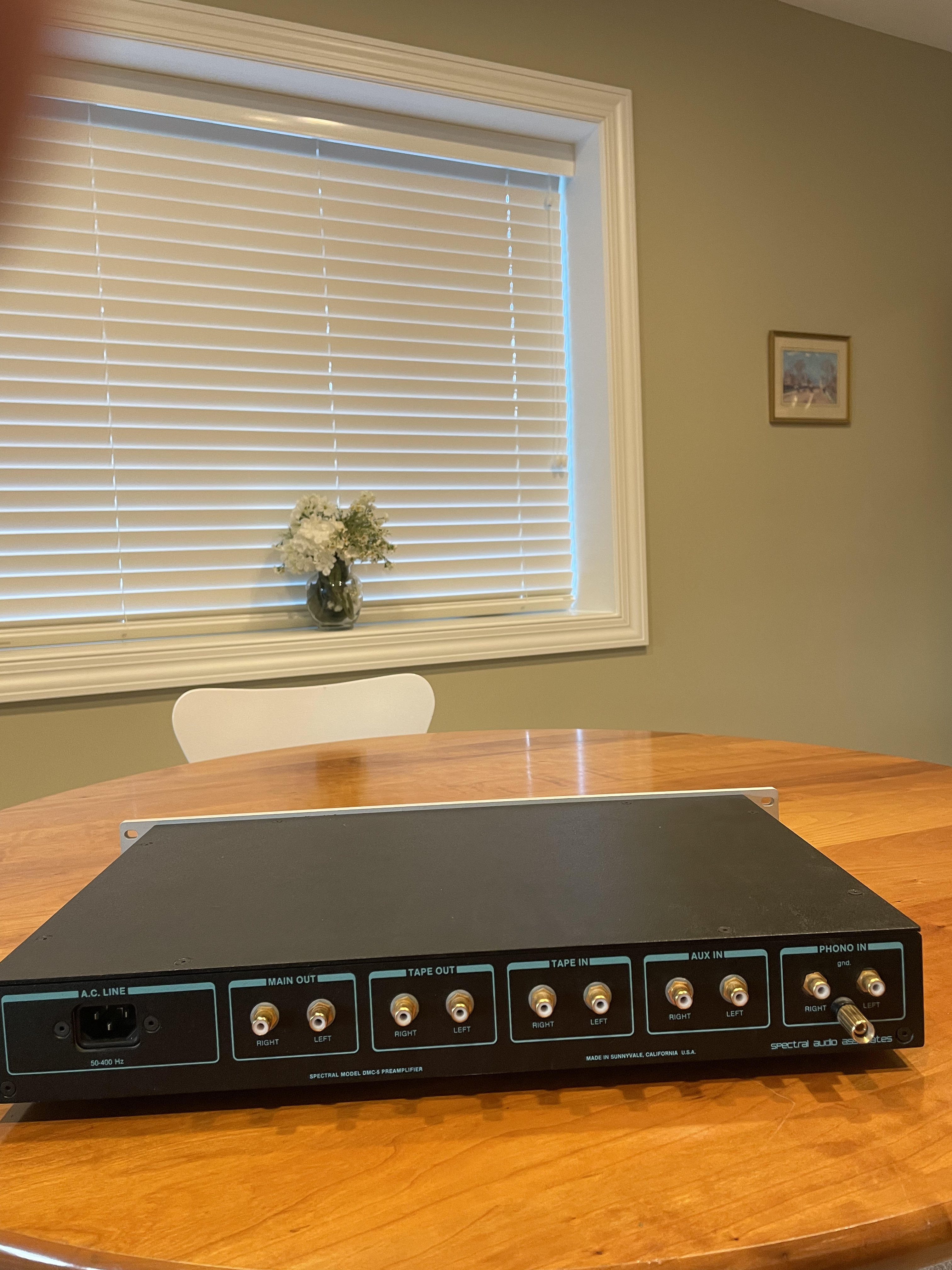

So she was sold this at huge expense: - a Spectral Acoustics DMC-5. Apart from being over priced junk it had inadequate inputs.
It had line out, tape in and out and only phono and one Aux. So an external selector switch was required! Even forty years ago the price was $3000.00 for this piece of junk.
The problem was no sound on one channel and a very loud rough buzz on the other.
So, I retrieved the Quad 306 and the Spectral preamp, and put them on the test bench. The Quad 306 was dead on one channel, and the Spectral acoustics had a loud rough buzz on both channels on the bench. The Spectral acoustics had a couple of burnt resistors on both channels, same on both. The power supply was emitting a horrid very rough supply trace. The power supply was riveted to the circuit board and totally sealed and enclosed. So I had enough of that and advised a trip to the recycling center. I don't service that kind of junk.

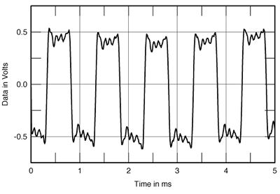

No other speaker can come close to producing a square wave like this.
Not only that, but a pair out of phase can cancel that square wave in mid room. Peter Walker personally demonstrated that to me in Huntingdon on one of my visits to Quad.

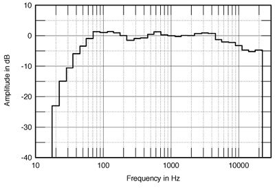

Obviously the bass is a little limited. Because of the delay lines and the diaphragm moving with ripples across the membrane a close mic measurement is useless and misleading. So you have to rely on the averaged room response.
The HF fall off is entirely appropriate for the in room response. Due to the size of the panel there will be and is a bass roll off.
So it is 6db. down at 40 Hz and 24db. down at 20 Hz. However on listening to CDs on those speakers in that small town home living room, the bass was very much present and without a trace or hint of coloration. The listening experience was outstandingly good, engaging and a totally pleasurable experience.
