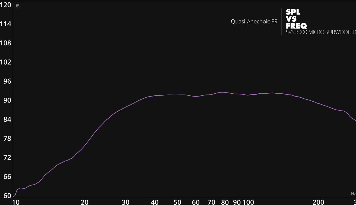

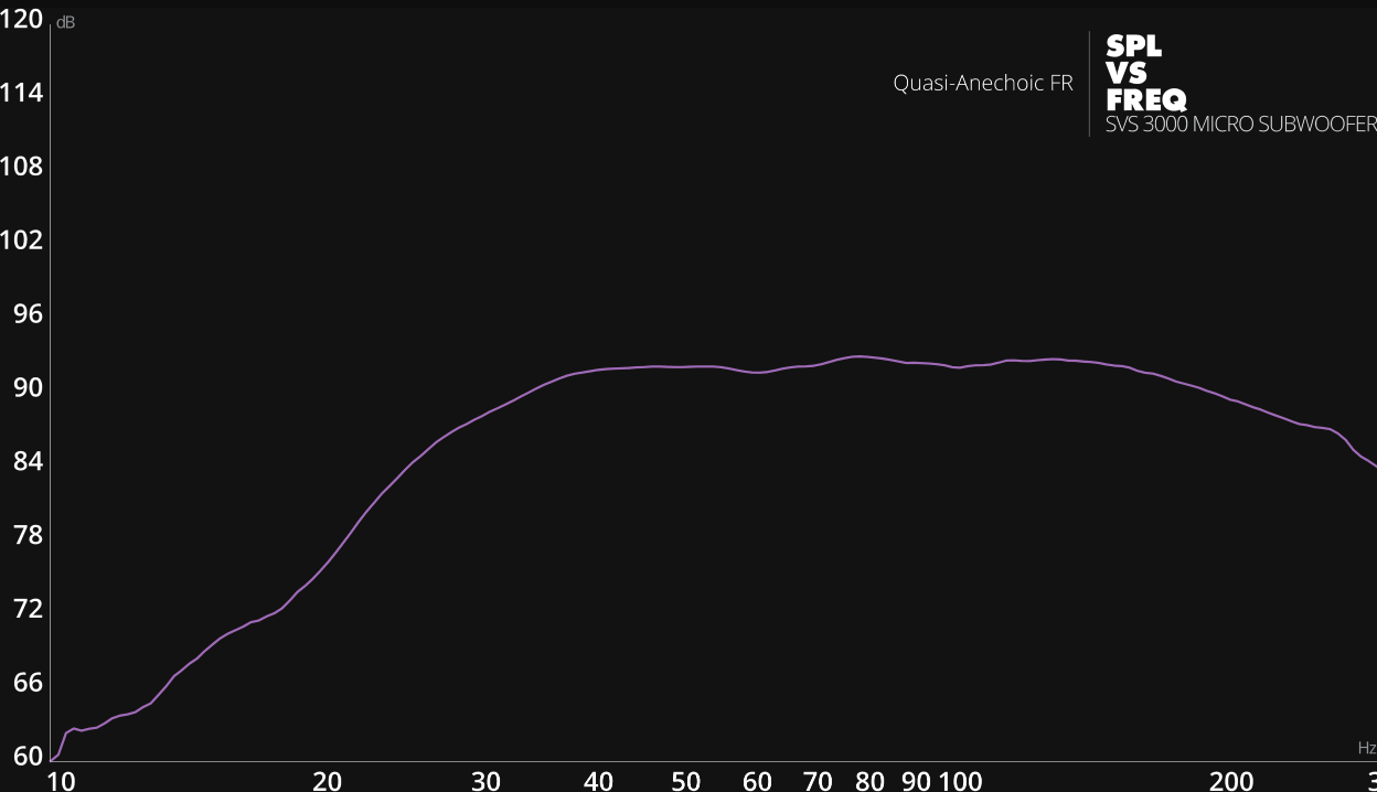

Never ever get that SVS micro for anything but a desktop setup it's not meant for a bigger open space like you have the 2000 pro would be my bet

I love SVS, but verbiage they use to describe that Micro is pretty misleading, imo. Don't pay attention to the description and take a good look at the chart they post of the measurements.
You can see it really starts losing steam at 30 hz and there isn't much left at all by the time you hit 20 hz. Technically it doesn't even qualify as a subwoofer.
Thanks Pogre. Didnt understand the graph but got the message. Micro is not an option.
The horizontal axis is frequency (hz) and the vertical axis is volume (dB). The line starts to drop just above 30 hz and is down almost 20 dB by the time you hit 20 hz, which is what most consider minimum (20 hz) to be considered a true subwoofer.
