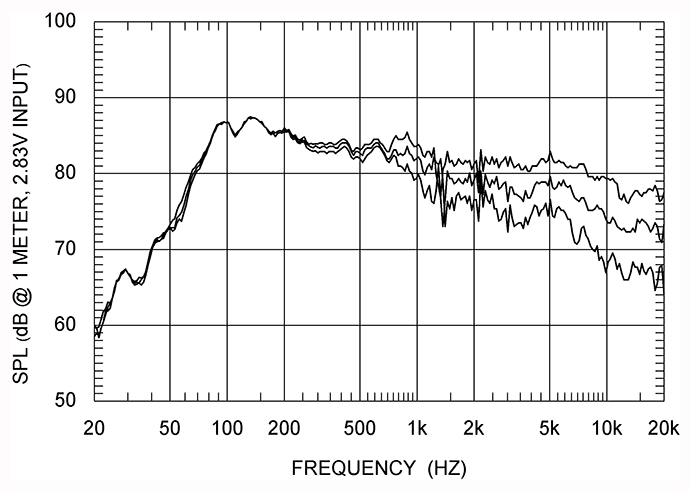

Dr. Toole himself has stated that the NRC measurements for the LS50 show a resonance.
I'd be a fool to argue with him.
So let me do just that! :)
Chart B, the off-axis frequency response plots, seem to show an off-axis resonant peak centered at 2kHz.
But if you disregard that little drop in the 3-4kHz range of those curves, that peak would no longer look so much like a resonant peak and instead would look a lot like a directivity mismatch between the woofer and tweeter (something that shows up in lots of speakers measured at the NRC).
Other than that little dip around 3-4kHz, which might be a diffraction effect, the output is well-controlled and smoothly dropping from 2kHz to 20kHz. And 2kHz is very near the crossover frequency.
Any chance that's all that's going on here - and that it just looks like something it isn't?
It's an anechoic measurement - not an ink blot!
I'm not sure its a problem with directivity or resonance based on the whole set of NRC measurements.

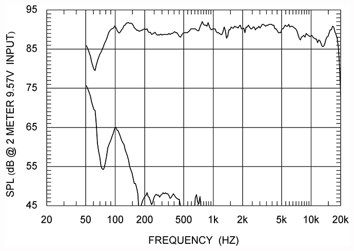

Consider a cleaner view of the on axis FR from the distortion graph:
It seems to me the tweeter is clearly tipping things up between 2kHz and 5kHz relative to the mid/woofer level. It also seems to me that off axis, those relative proportions are maintained pretty well.
Drop the tweeter level 4dB or so, and all you'd really see is that off axis dip around 4kHz, and the rise afterwards as a result of the tangerine phase plug.
Correct, this is not an ink blot. If the only rebuttal's at this point are to say, "well if you ignore the measurement" then this thread is truly finished.
Who said anything about ignoring measurements? I said if you take into account the actual on axis measurement, the off axis measurements make sense, without need to introduce other factors like resonances and directivity mismatches. The LS50 has its own particular voicing, that much is clear, and it probably won't appeal to everyone. If you want an "unvoiced" version, that's effectively where the R100 sits.
Beave said it directly, and I felt you alluded to it in the sentence I quoted.
We've already confirmed that we have incomplete data to really narrow down the cause. So floating ideas on what could be done differently with incomplete data is really beating this thread into a pulp.
It's not a matter of what could be done differently. It is what was done differently with the very similar (in terms of basic hardware) R100, which was also measured by the NRC. Its on axis measurement is smoother around the XO point than the LS50s, and its off axis plot is correspondingly smoother as well.
Smooth is usually described with a speaker's ability to maintain a +/-3dB variation across it's operating range. Neither of these speakers offer that, and the off axis of the R100 suggests there may be a resonance there as well, considering the blurring of the measurements 0-30deg around 1.5khz and 2.2 kHz - whatever that is, it is not smooth!
Are you having fun putting words in my mouth? I said that compared to the LS50, the R100's on axis response was smoother around the XO point, and consequently, there is no large peak off axis in that range as seen with the LS50.
I don't know what you're looking at, but I see nothing on the R100's 0-30 degree charts suggesting a significant problem with resonance.
