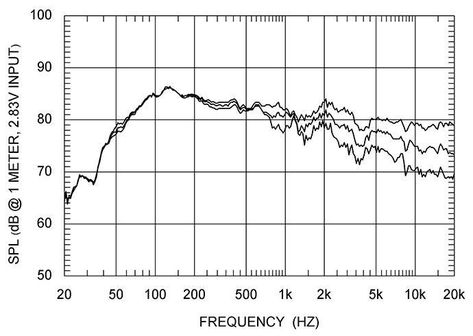

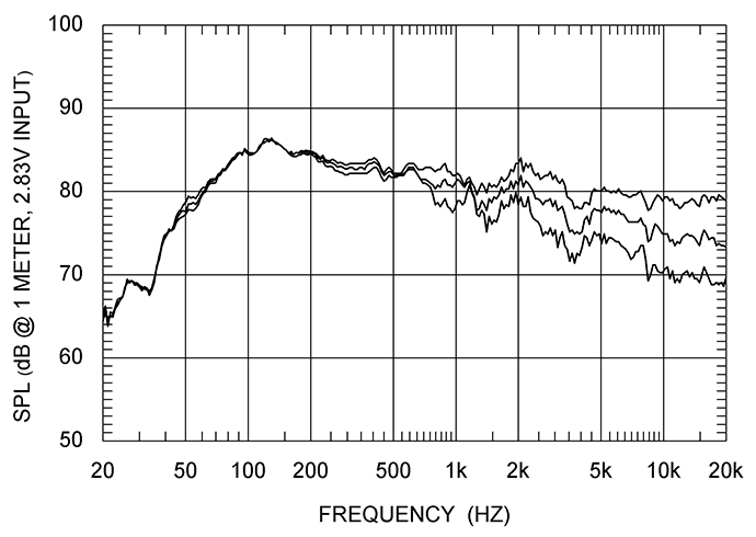

I don't know what you're looking at, but I see nothing on the R100's 0-30 degree charts suggesting a significant problem with resonance.
My apologies, I see where I took your words out of context.
What I am looking at with the R100 is at 1.5 and 2.2 kHz, where the off axis measurements are blurring together - while I don't have Floyd here to say that is a resonance too, it is safe to say that also will cause coloration of sounds.
I'd suspect diffraction effects rather than resonance. Given that the "fuzz" doesn't get particularly notable until about 60 degrees off axis, it's not something I'd consider a serious coloration in the grand scheme of things. That said, I've heard that some of the engineers at KEF consider the dedicated midrange/tweeter UniQ array to be a better than the midwoofer/tweeter arrays, and that looks like one potential reason why (Ref 1 as an example).

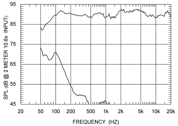

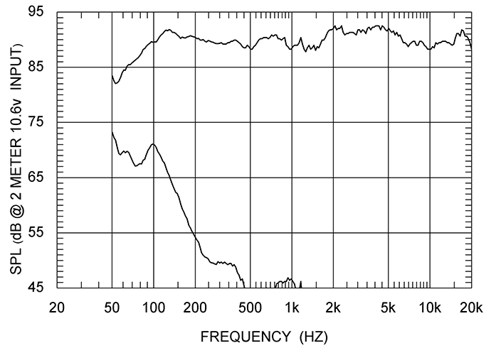

I'm not sure its a problem with directivity or resonance based on the whole set of NRC measurements.
Consider a cleaner view of the on axis FR from the distortion graph:
It seems to me the tweeter is clearly tipping things up between 2kHz and 5kHz relative to the mid/woofer level. It also seems to me that off axis, those relative proportions are maintained pretty well.
Drop the tweeter level 4dB or so, and all you'd really see is that off axis dip around 4kHz, and the rise afterwards as a result of the tangerine phase plug.
Distortion curve shows a peak at 4k while the directivity curves show a trough at 4k. Not sure why.
You may very well be right. I know that medley's measurements of the raw drivers show that the tweeter output peaks right around 2kHz, with a sharp dropoff below that, and a broad hump for an octave or so above it.

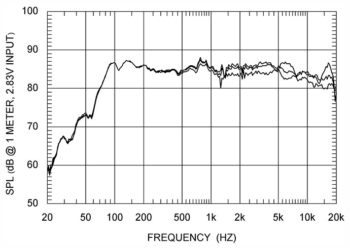

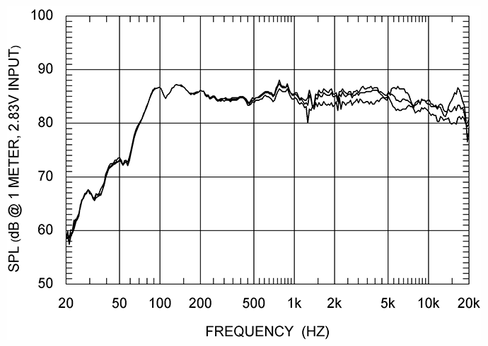

Smooth is usually described with a speaker's ability to maintain a +/-3dB variation across it's operating range. Neither of these speakers offer that.
They don't?
I see a low of about 81 or 82dB, and a high of about 86dB. That's a total variation of about 4-5dB, which means it easily fits in the +/3dB variation if you consider the mean to be about 83-84dB.

So is this a resonance as well?
Possibly, but this is insufficient data. That call was made on the LS50 after seeing all of the Soundstage measurements.

They don't?
I agree this one is smoother than the LS50, but I counted from below 80 hz.
Huh? This was the plots for the LS50. It's flat within +/-3dB on axis, and at 15 and 30 degrees off axis. Its listening window is as well. Same goes for the R100.
Surely you're not saying speakers need to be within +/-3dB at 45, 60, and 75 degrees off axis?
Counting from below 80Hz, well, show me any speaker - especially a small monitor - that's flat within +/-3dB below 80Hz. You've moved the goalposts substantially.
