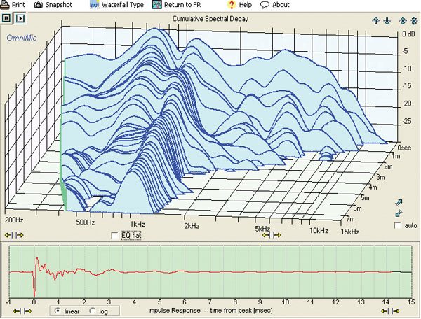

I'm not sure its a problem with directivity or resonance based on the whole set of NRC measurements.
Consider a cleaner view of the on axis FR from the distortion graph:
It seems to me the tweeter is clearly tipping things up between 2kHz and 5kHz relative to the mid/woofer level. It also seems to me that off axis, those relative proportions are maintained pretty well.
Drop the tweeter level 4dB or so, and all you'd really see is that off axis dip around 4kHz, and the rise afterwards as a result of the tangerine phase plug.
If that was due to resonance, what kind? Cabinet related or cone related or something else? The rise to 2K didn't really fall off (just very slightly,yes) after it peaked, and the impedance was rather low for it to be cone resonance. I really think it is more likely to be like you said, some sort of voicing, i.e. by design.

Diffraction does not cause a 5db gain in amplitude, across a whole octave. It is a resonance. The only thing in question is exactly what part(s) of the speaker are causing it. And that requires more data.

The NRC graph shows an approximately -2 dB trough between around 870 hz to 1500 hz, then it ramps up from 1500 hz to approximately 2000 hz by about 4 dB, it basically becomes flat to about 5,000 hz. That's not being disputed or speculated as it is there for all to see. We just are not sure whether that 4 dB rise are due to some sort of "resonance". It will be great if your expert can clear that up with explanation and supporting information.
I was looking for something that I would consider more obvious indication of a peak due to resonance, and found the following CSD plot. To me that one is clear cut, whereas the LS50's is not clear enough for us call it with certainty, though as you put it, we can speculate and only speculate.

I looked at his measurements to see if there is a driver resonance, but his plots aren't really high enough resolution to see for certain. But what I did notice - and mentioned earlier - is that the tweeter response peaks right around where the LS50's NRC measurements show the peaking - at 2kHz, and from there to around 4-5kHz.
It sure would be nice to see plots of the midwoofer and its crossover, and the tweeter and its crossover. JA does that on speakers with buy-wiring connectors, but he doesn't do it for speakers that only have single-wiring connectors.
