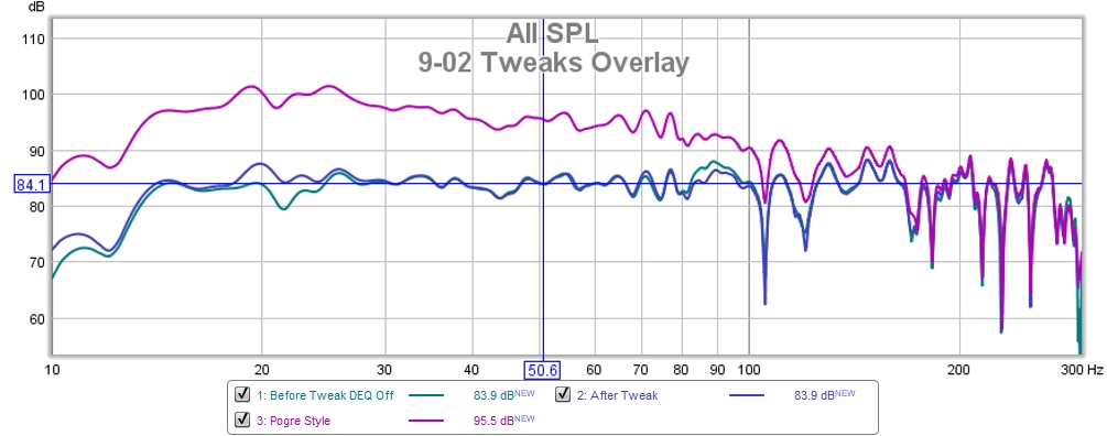

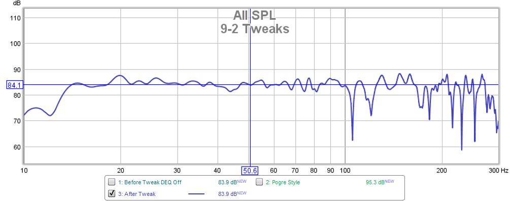

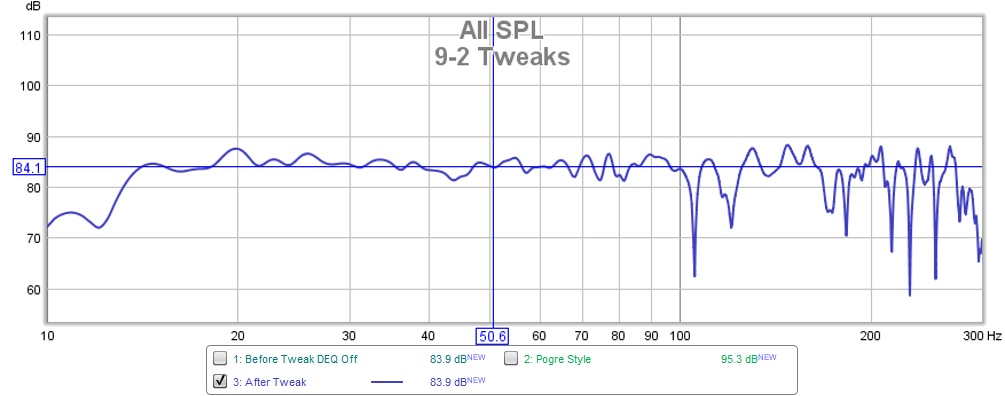

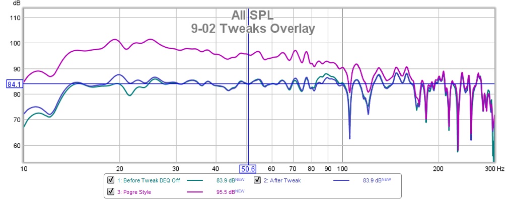

Did some more tweaking and finished up just a little bit ago.
Tamed down a peak at 90hz and bumped up a null at 21hz-ish. No smoothing, main speakers and subs together.
This is an overlay of before I tweaked it today and after. Then, just for @William Lemmerhirt ... "Pogre Style". How's that for a house curve? :D

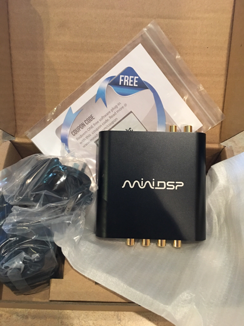

Did you get a free code for the plugin? Iirc, you didn't. I was surprised to find it in my box.
I did, but I didn't immediately see how to redeem it so I just paid the ten bucks.
