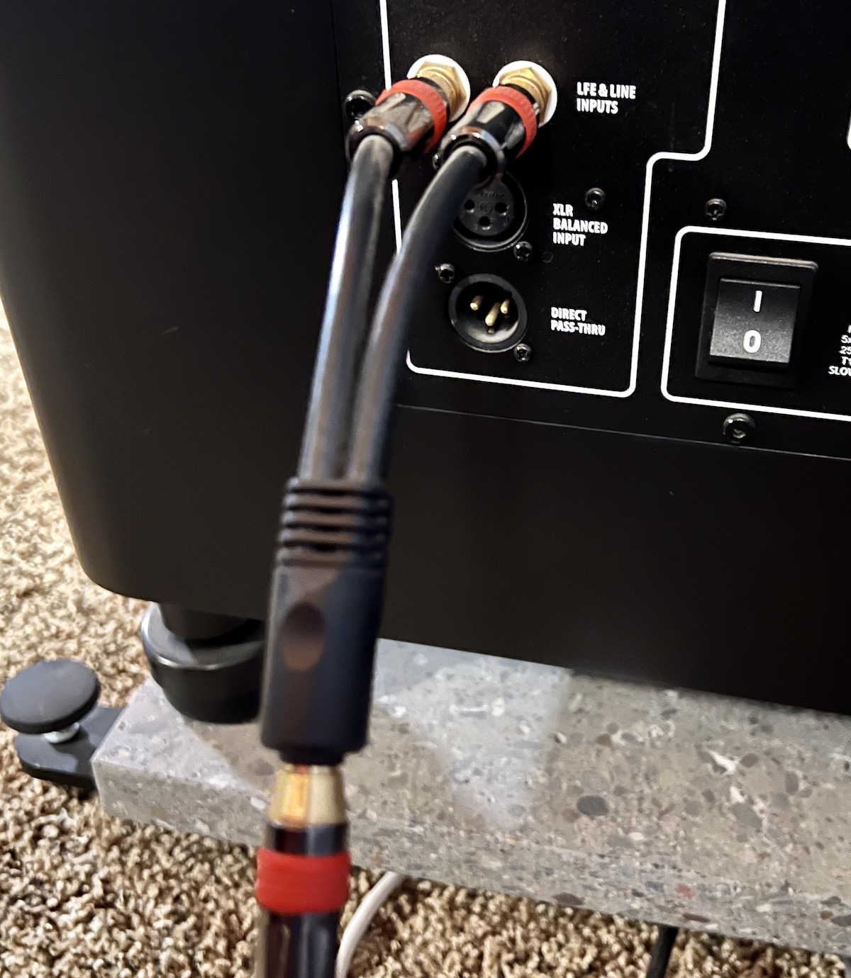

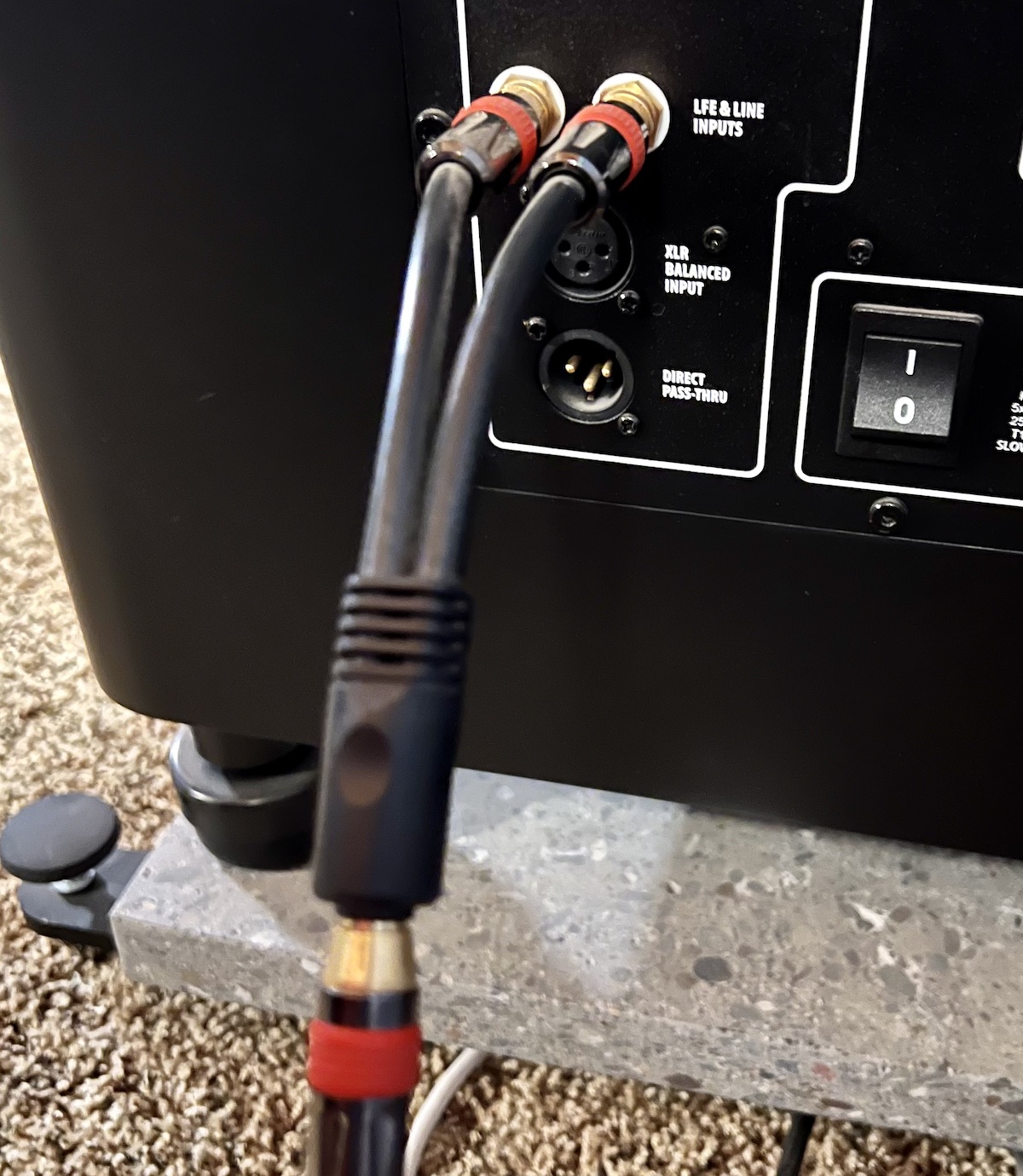

And as a picture is worth 1000 words... and just to make certain there is no confusion, this is what I'm talking about doing:
Finally got around to checking settings. AVR LFE should be at 120? It is at 120. You said sub xo at 80. Does not LFE defeat the crossover control on the amp plate? Or do I have that wrong? I haven't hooked up a Y. Still just LFE.

The crossover on the plate amp is for when you don't have crossover control on your AVR. When using the AVR crossover setting the plate amp crossover should be set to max so that the AVR can do its thing. I don't see the Y adapter making much difference but no harm in trying. Best to turn up the AVR subwoofer trim, but as mentioned it's preferred not to use positive values.
