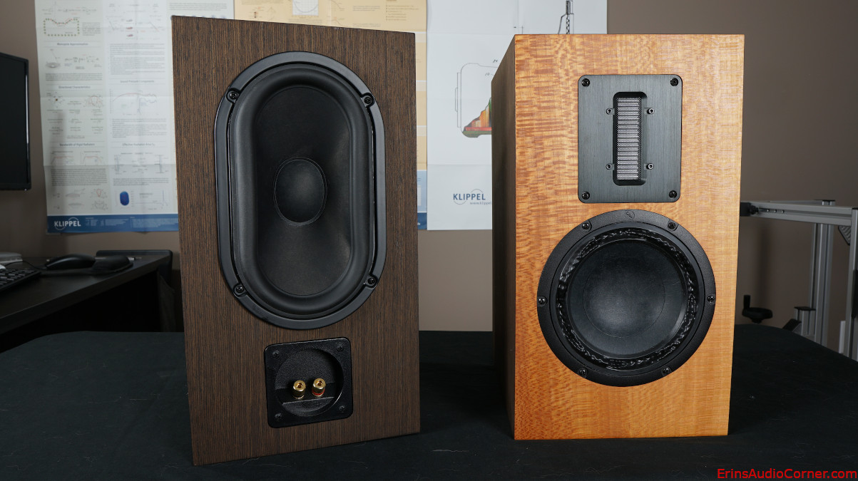

This speaker comes to us from the mind of fellow DIY’r and speaker builder, Rick Craig of Selah Audio. You can find the manufacturer’s information here but I have provided some snippets below:
  • Design: 6.5” 2-way
  • Drivers: Purifi woofer and BZ Labs CQ76B ribbon/planar tweeter.
  • Frequency Response: (+1/-3dB) 40hz-20K
  • Bass Extension: -10dB @ 33hz
  • Impedance: 5 ohms/nominal, 4.2 ohms/minimum
  • Sensitivity: 84.5dB /1W/1M
  • Suggested Power: 30-100 watts/channel RMS
  • Dimensions: 15.5”(H) x 8.5”(W) x 11”(D)
  • Weight: 25 lbs.
  • Standard Finishes: Walnut,Cherry,Maple, and Oak (other veneers available for quote upon request)
  • Pricing: $2,895/pair (includes free shipping to the mainland USA)
Rick emailed me some additional information he wanted to note:
  1. There are no grills but the front does have embedded magnets for them. I always supply fabric grills so you can mention that in your review. I omitted them with this pair since I mainly built them to be reviewed and for local demos. The grills of course could be added later on if I sell them.
  2. This pair has an oil finish that’s very matte and more in vogue these days with the modern rustic interiors. The surface isn’t ultra smooth but can be buffed out more if needed - again, more in part to the rustic look. The front baffle is Sycamore veneer and sides reconstituted Wenge veneer. The cost for this pair is $2,895 and this includes shipping to the mainland USA. The cost range is $2,695 - $2,895 depending on the veneer used. We can also finish them with a medium gloss conversion varnish if someone wants more sheen than this pair exhibits.
  3. The design axis is the center of the tweeter. A typical stand height is 24”-28”.

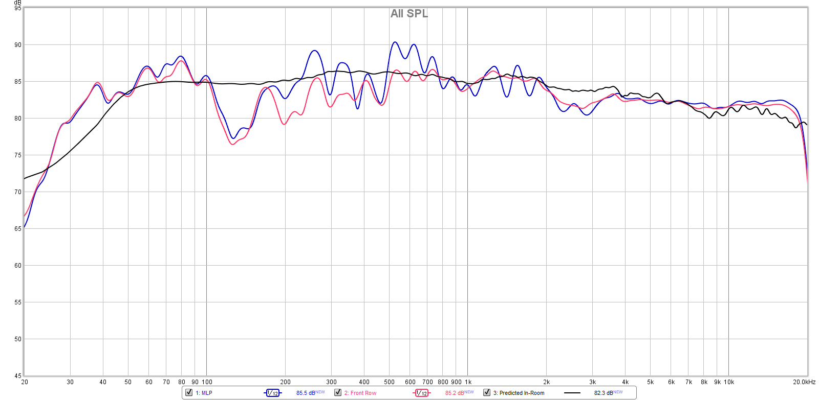

Below is the measured in-room response at the main listening position (MLP) in blue, across the front row of seats (red) both compared against the predicted in-room response (black). You can see the prediction follows pretty reasonably to what is measured in the seated position, aside from the major modal dip at ~125Hz and the dip between 2-3kHz.
The measurements/prediction below do not have EQ applied.
measured vs predicted
