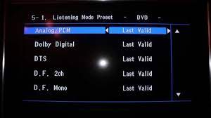

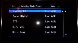

Again, this is what my current receiver's Listening Mode Preset menu looks like:
I have Dolby Digital, DTS, etc. set to "Dolby D," "DTS," et al so they straight decode those. Under "Digital Format 2 Channel," I have this set to "PRO LOGIC II MOVIE," so it knows to apply Pro Logic II to a STEREO surround signal. Same with the "Digital Format Mono" option (I have this set to "MONO MOVIE" so these tracks go into the center channel only).
Every time I switch the AVR back on, these simply apply to whatever signal is being presented.

You're right about it doing the opposite -- but if they would just implement a menu like the old receivers had where you could assign listening mode DEFAULTS (like my Onkyo does) so they switch when detected, it wouldn't be a problem.
