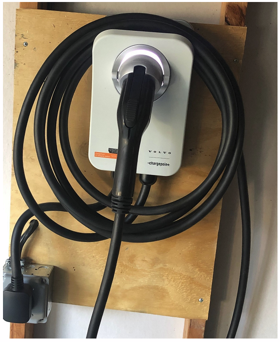

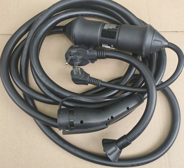

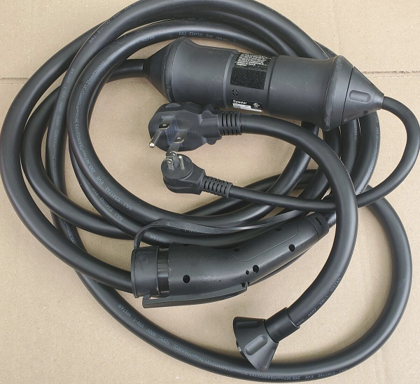

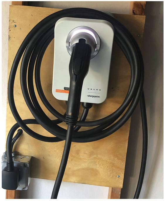

For the benefit of readers who don't have an EV, and may not get what difference there is between portable (Level 1/2) and wall chargers (Level 2), here's what these various chargers look like:
Volvo included this Portable Charger with my EV. It easily converts between Level 1 (120VAC, 15A) or Level 2 (240VAC, 50A). I always keep it in my car:
In addition, I purchased a wall mounted Level 2 charger to hang in my garage. Volvo offered a discount from ChargePoint for a standard wall charger. I recharge with it most of the time:
